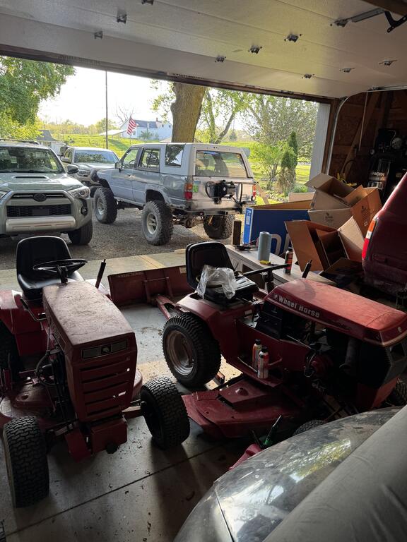

Dcarr4510 8 #19 Posted May 10, 2025 (edited) On 5/8/2025 at 8:54 AM, rjg854 said: Seeing your plan is to open up the tranny, flush it really good and a couple of times, old gear oil smells pretty bad. and it makes cleaning up your parts easier. Will do. Looks like diesel should be okay for this? On 5/8/2025 at 5:28 PM, adsm08 said: I did it that way because I couldn't get the drain plug out, and it made more sense that that was the side everything should stay in. It caused some other issues because the fork and rail assemblies are in the shallow side and the cluster gear wants to stay with them. Good to know. Any help so I dont dump the internals all over the floor is much appreciated. I did end up getting a C120 with the Kohler to cover my yard needs until I fix this trans issue. Came with a blade as well. Edited May 10, 2025 by Dcarr4510 4 Share this post Link to post Share on other sites
