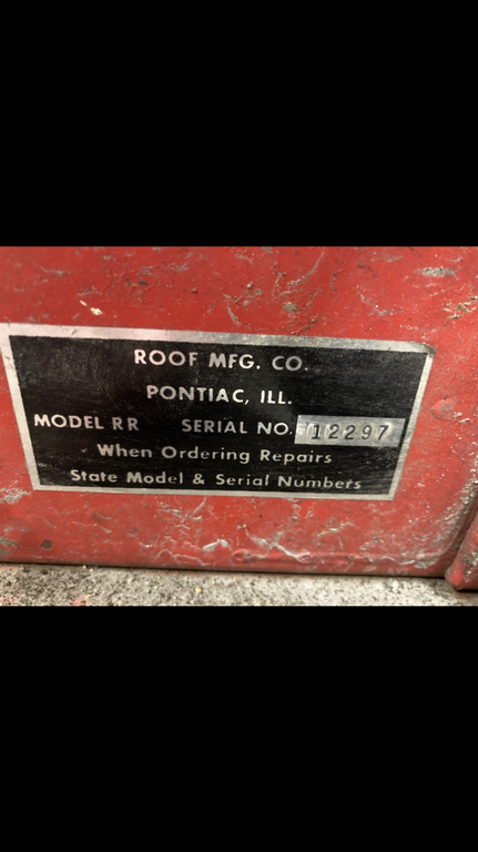

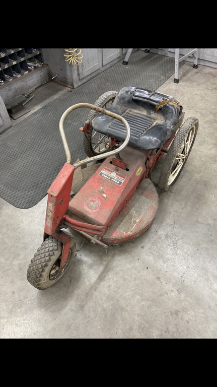

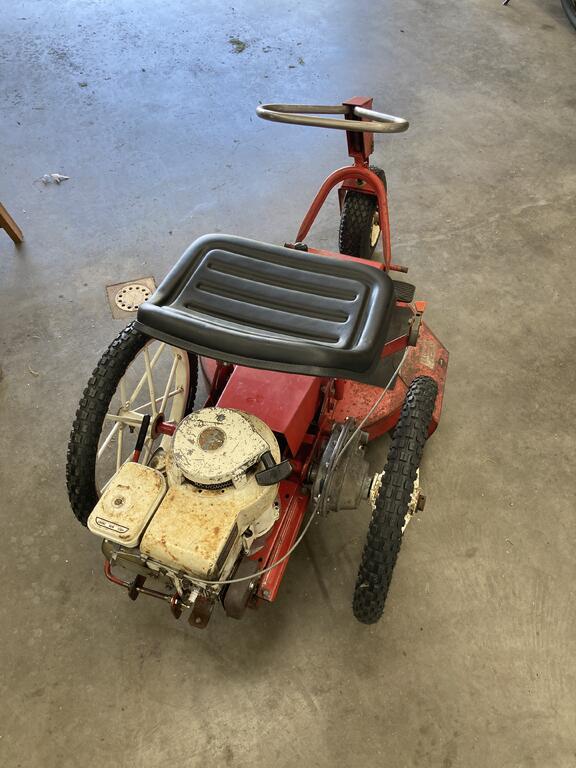

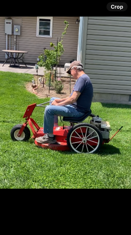

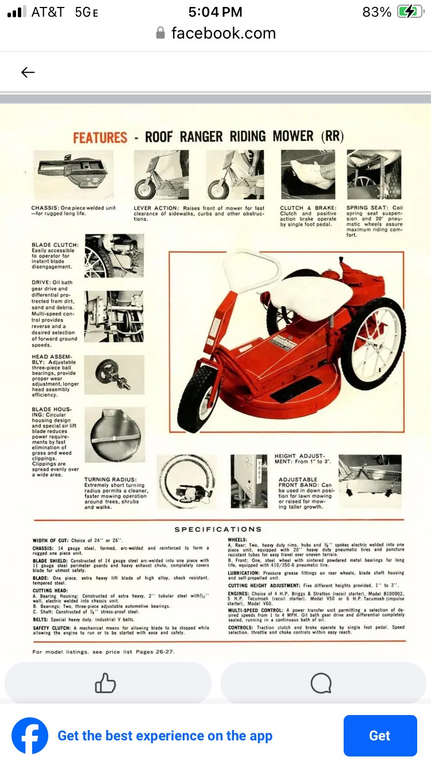

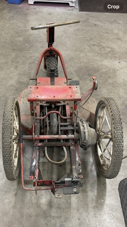

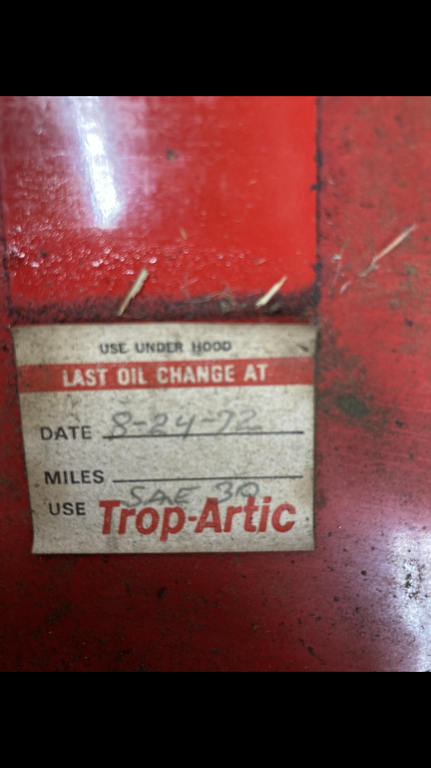

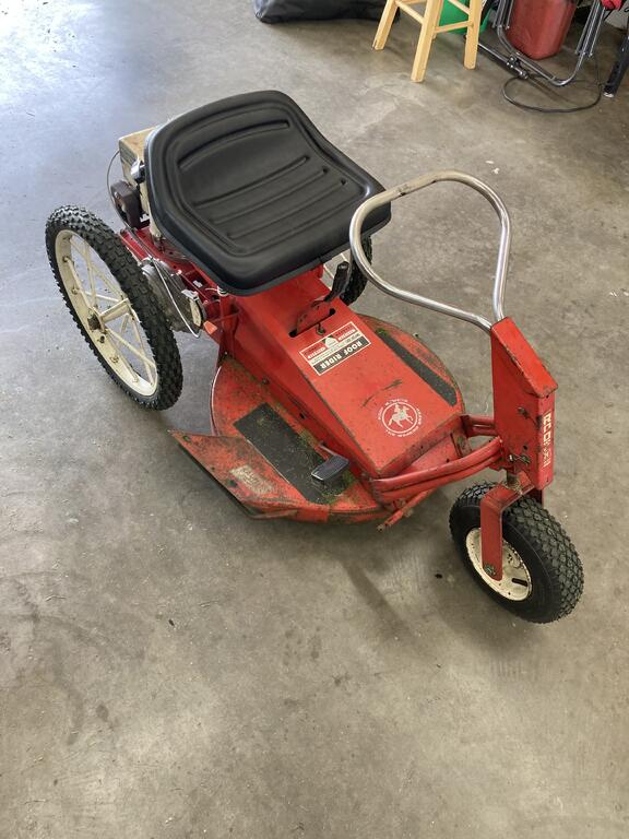

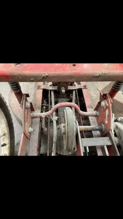

dclarke 4,113 #1 Posted April 29, 2025 I picked up this Roof Ranger from a buddy last winter, took it apart, because I can’t leave well enough alone and replaced the belts, tires, seat & a few other things. Cleaned it up and put it back together. 5 HP Briggs with a 24” cut, I believe this is from the 60s or early 70s. This engine is pretty tired, it’ll sometimes fog for mosquitoes while I mow. I mowed the yard with it today, this thing drives with a rubber wheel running on a flat pulley. The deck is welded to the frame and pushing down on the handle raises the front of the deck, it has a cutting height from 1”- 3”. Holding the handle down as I mow is pretty awkward. 2 speeds forward and one reverse.This thing just might be the reason OSHA came into existence. 5 2 4 Share this post Link to post Share on other sites
WHX?? 54,483 #2 Posted April 29, 2025 14 minutes ago, dclarke said: drives with a rubber wheel running on a flat pulley. Like some sno blowers. @Achto know the year? Cool little rig tho Denny ... 2 Share this post Link to post Share on other sites

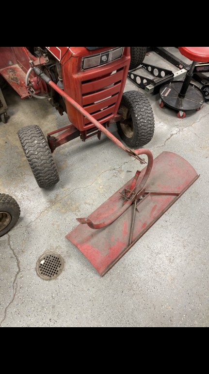

dclarke 4,113 #4 Posted April 29, 2025 This blade came with it. Maybe this will be my snow machine next winter. 😂 6 Share this post Link to post Share on other sites

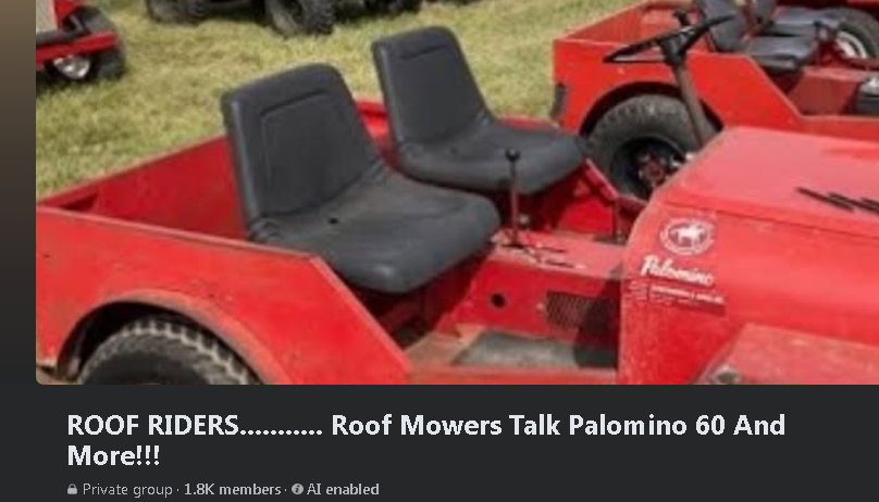

JoeM 9,557 #5 Posted April 29, 2025 In case you don't know there is a group over on Facebook that deals the roof stuff. That thing might be worth something?? I looked for one of those Palomino Jeep style mowers for a while, ended up building my own on a 520xi frame. Either they wanted way to much or there was none around. 4 Share this post Link to post Share on other sites
Achto 30,819 #6 Posted April 29, 2025 9 hours ago, WHX?? said: @Achto know the year? Not sure, will do some research. Share this post Link to post Share on other sites
dclarke 4,113 #7 Posted April 29, 2025 1 hour ago, JoeM said: In case you don't know there is a group over on Facebook that deals the roof stuff. That thing might be worth something?? I looked for one of those Palomino Jeep style mowers for a while, ended up building my own on a 520xi frame. Either they wanted way to much or there was none around. Thanks, Joe. I’ve joined that Facebook group. 1 Share this post Link to post Share on other sites
CRF857 291 #8 Posted April 29, 2025 10 hours ago, dclarke said: I picked up this Roof Ranger from a buddy last winter, took it apart, because I can’t leave well enough alone and replaced the belts, tires, seat & a few other things. Cleaned it up and put it back together. 5 HP Briggs with a 24” cut, I believe this is from the 60s or early 70s. This engine is pretty tired, it’ll sometimes fog for mosquitoes while I mow. I mowed the yard with it today, this thing drives with a rubber wheel running on a flat pulley. The deck is welded to the frame and pushing down on the handle raises the front of the deck, it has a cutting height from 1”- 3”. Holding the handle down as I mow is pretty awkward. 2 speeds forward and one reverse.This thing just might be the reason OSHA came into existence. Parents had one of those in the late 60s. Only pushed down on the steering handle at an obstacle, like going over a sidewalk. If you put it in reverse and then jam it into forward it would pop a wheelie. Don’t ask how I know. And don’t let the old man catch you. Thanks for the memories. 3 Share this post Link to post Share on other sites
