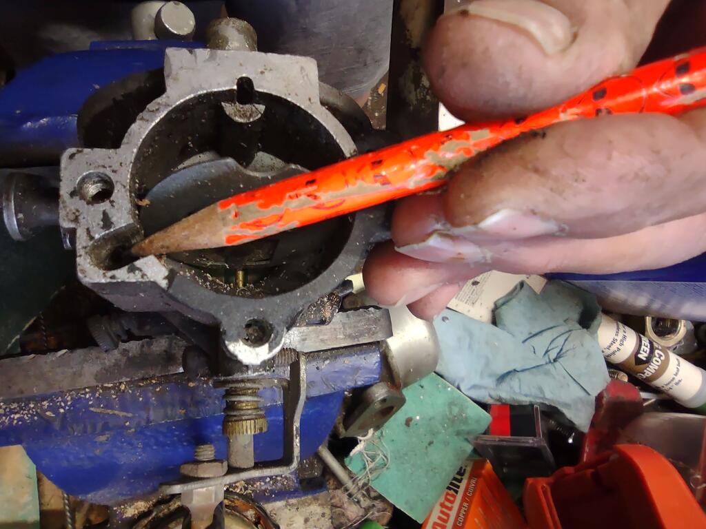

Achto 30,998 #11 Posted April 28, 2025 (edited) 2 hours ago, Yeet said: I use it and every once and while the carb floods to the point where gas is shooting out of the air filter I had this symptom on a Kohler carb once. On mine it turned out that the vent hole that runs from the bottom of the carb inside the bowl to the top of the carb inside the throat was plugged. With no place for the air to go when the float bowl was filling, it would force gas through the main jet into the throat of the carb. This vent hole on the bottom. Must have clear passage to this hole in the throat. On a smaller carb the hole in the throat may be located here. Here is a link for an OEM carb kit. (Part number 25-757-01-S ) They make aftermarket kits as well, but I don't recommend them. I will use a lot of aftermarket parts, but I will only use genuine Kohler carb kits. https://www.amazon.com/Kohler-25-757-01-S-Equipment-Carburetor-Manufacturer/dp/B000P7P2HE/ref=sr_1_1?crid=3D2HKX492Q222&dib=eyJ2IjoiMSJ9.CGGfi7ox7IR8RsjmeMeqXuBo1nNSkVGuGyDjQ1UUtlEiSNKlPyisHPc6VctLEPSwcPn4bYTFNxZSgOu2yzgj9ks7jsGT2TrcVF9H9WOJBh22MI4Nw7rUPZwPE7atZHaw0SXcFWu7AeGC4RLyORU0zlkr0_acl3OpeZuqFl0NNlw_AKB-JP_ag0EKGwP1pQf638YF5Y0K0R57ek_8dzZq_Q2RLpS5x_bdfXKIgSHtaeQnuzpOjYPLW6C6PdPBU-ibI442MKqPOT153GBN0cOdD6qTeyF0eX-U9T_ORBnDaAw.A9FgWAezdLai5_obvQch3P8daOuIcZrn6JJe-_Mf_H8&dib_tag=se&keywords=kohler+part+25-757-01&qid=1745879942&sprefix=kohler+part+25-757-01%2Caps%2C180&sr=8-1 Note: You will require a thin wall 3/8" socket to remove the seat for the float needle. I just ground down one of my cheap deep well sockets. Edited April 28, 2025 by Achto Share this post Link to post Share on other sites
