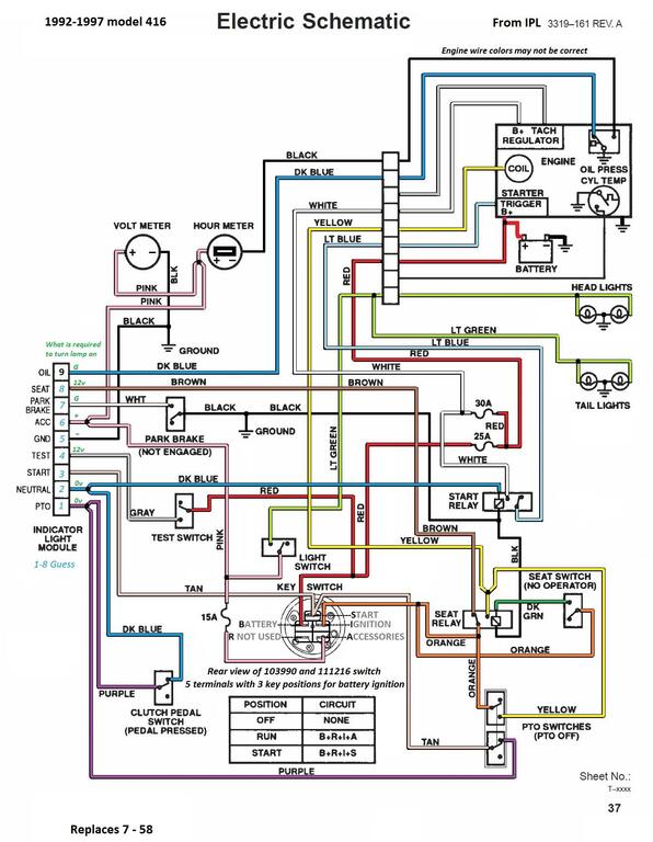

nylyon
I didn’t check the wiring diagram for a 417, but with my 416 the pressure switch does 2 things.  First when no pressure it sends a ground signal to the indicator lights which blinks the oil pressure light.  When there is pressure, it sends a ground signal to the hour meter so on my 416, if I removed the switch I would expect the hour meter to stop as well. Diagram for the 416:

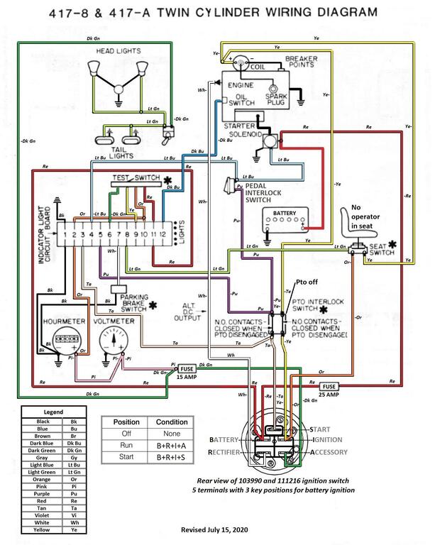

nylyon
I pulled up a 417 diagram and the hour meter just runs when the key is on and there is power to the Accessory terminal from the key.  It doesn’t say what triggers the oil light but it is either ground or lack of ground from the switch, since there is only one wire from the switch to the panel.  Might make sense to test continuity to ground of the switch terminal with the engine off and on, and check if the do blue wire has any opens to the indicator panel:

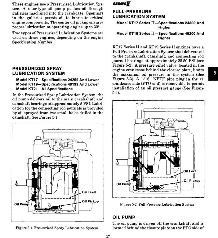

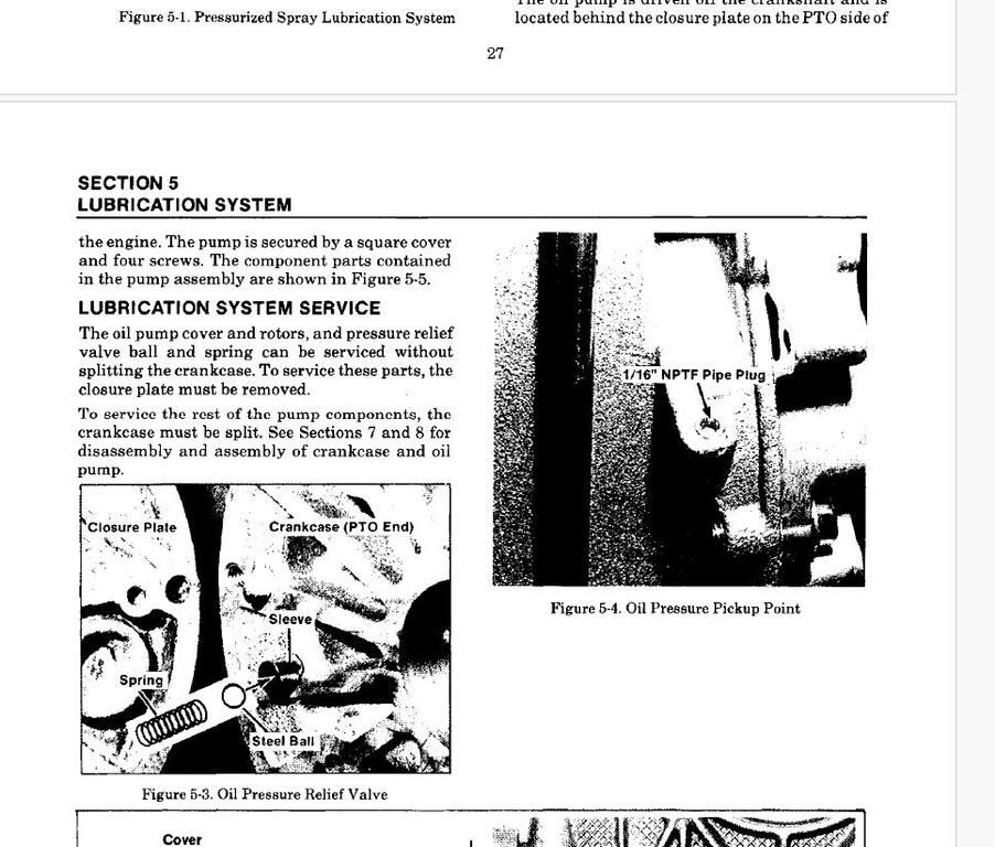

1/16 pipe plug?? Gotta be a typo?? Never heard of such an animal.
squonk
https://www.asmc.net/1-16-27-nptf-thread-socket-pipe-plug-dry-seal-3-4-taper-stainless-steel-18-8/
  • Like 1
  • Thanks 1
Lcarter114
Great information guys, I appreciate it.  The 1/16th sounds right.  If I remember correctly when I bought the pressure sensor the threads were different.
