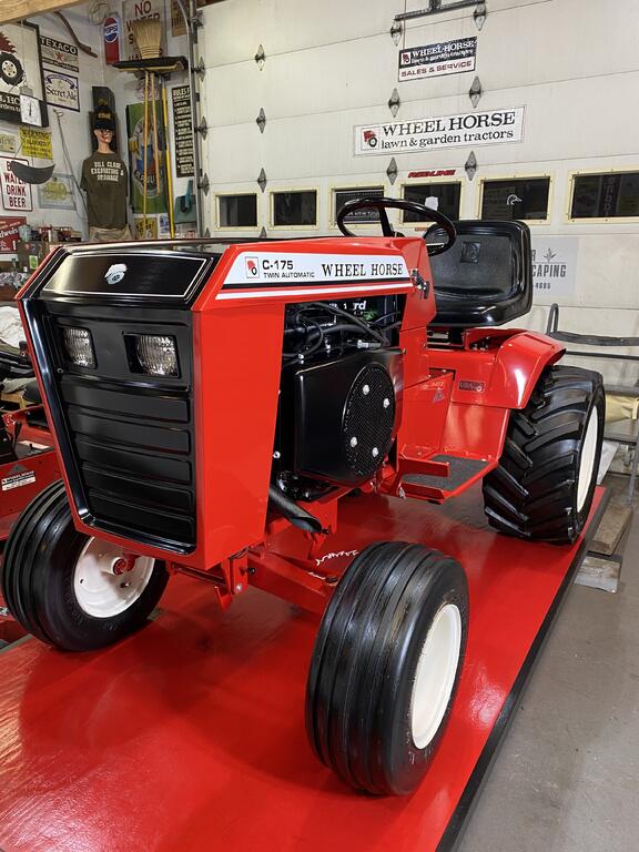

ML3 2,167 #1 Posted April 27, 2025 Considering a 1983 C175. Seller is asking what I think is a bit too much but has had it for sale for quite some time. I think hes ready to possibly come to a deal. It's about 2hrs away. Looks like the original implement listing only shows a single stage snowblower. I need a 2stage. Would a 2stage from another model work? Im not looking to have to engineer/fabricate intensely to make it all fit properly. 1 2 Share this post Link to post Share on other sites

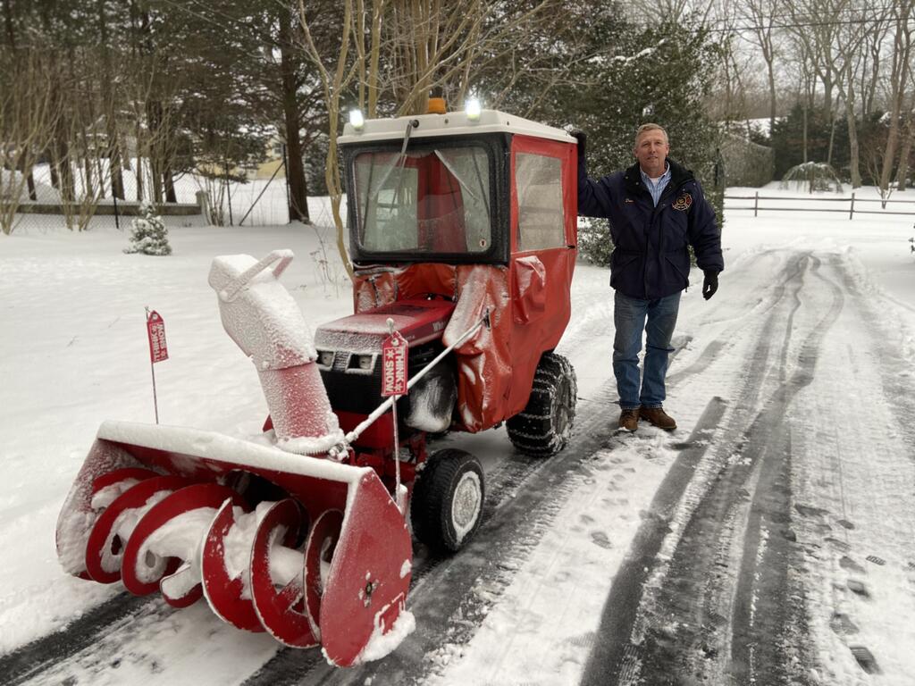

c-series don 11,522 #4 Posted April 27, 2025 Yes, it will hook up to the tractor. However as @wallfish says I’d be concerned about the belt rubbing the hood. I honestly don’t know if it would clear, if nothing else it will be damn close!! One way or the other that’s a really nice C-175, you don’t see too many in that condition. I recently restored my C-175 and have a two stage blower on my 417-A. I’ll see if I can take some basic measurements and figure out if it will work. 2 3 Share this post Link to post Share on other sites

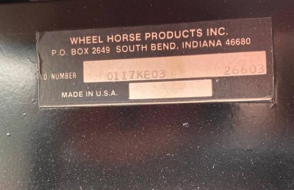

Brockport Bill 2,234 #6 Posted April 27, 2025 as noted in the thread earlier -- i would suggest to check the model and engine numbers to research and see if it's a KT 17 --- Series 1 or Series 2 engine -- recognizing the Series 1 potential historic engine issues? I have a Series 1 that has not had that issue --- yet anyway????? Share this post Link to post Share on other sites

Ed Kennell 45,054 #8 Posted April 27, 2025 8 hours ago, wallfish said: Except the belt sits higher on a 2 stage than a single so the belt might hit that wide hood, maybe not The belt on my Ber Vac on the '88 520H is 10-12 inches above the top of the axle. I rubs the hood when the blower is raised Share this post Link to post Share on other sites
ML3 2,167 #9 Posted April 27, 2025 (edited) Heres a pic of s/n. I definitely don't wanna modify hood or anything like that to make snowblower work. Appreciate everyone's input. Didnt know about the potential engine issues. Edited April 27, 2025 by ML3 Share this post Link to post Share on other sites
