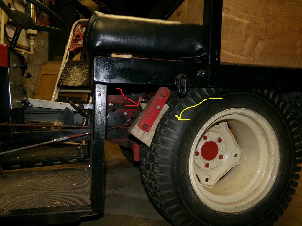

squonk 45,899 #4 Posted April 25, 2025 Paul is correct. Looking at the drum, it spins clockwise going forward. The band is tightened from the bottom and the drum surface is "forced" into the lining. In reverse the drum spins counter clockwise and is spinning away from the clamping force of the band 1 1 Share this post Link to post Share on other sites

Don in Mystic 7 #7 Posted April 26, 2025 (edited) All good info and thank you. Re the picture, You must be Dutch! I carry a boat anchor on mine when I do my big hill........ Edited April 26, 2025 by Don in Mystic omitted something 2 Share this post Link to post Share on other sites
squonk 45,899 #8 Posted April 26, 2025 14 hours ago, Ed Kennell said: If Paul and Mike's theory is valid, My brakes should work best in reverse. Actually no. The forces acting on the wheel and brake are depicted by the arrows. where they meet is the most force. "self energizing" 2 Share this post Link to post Share on other sites
