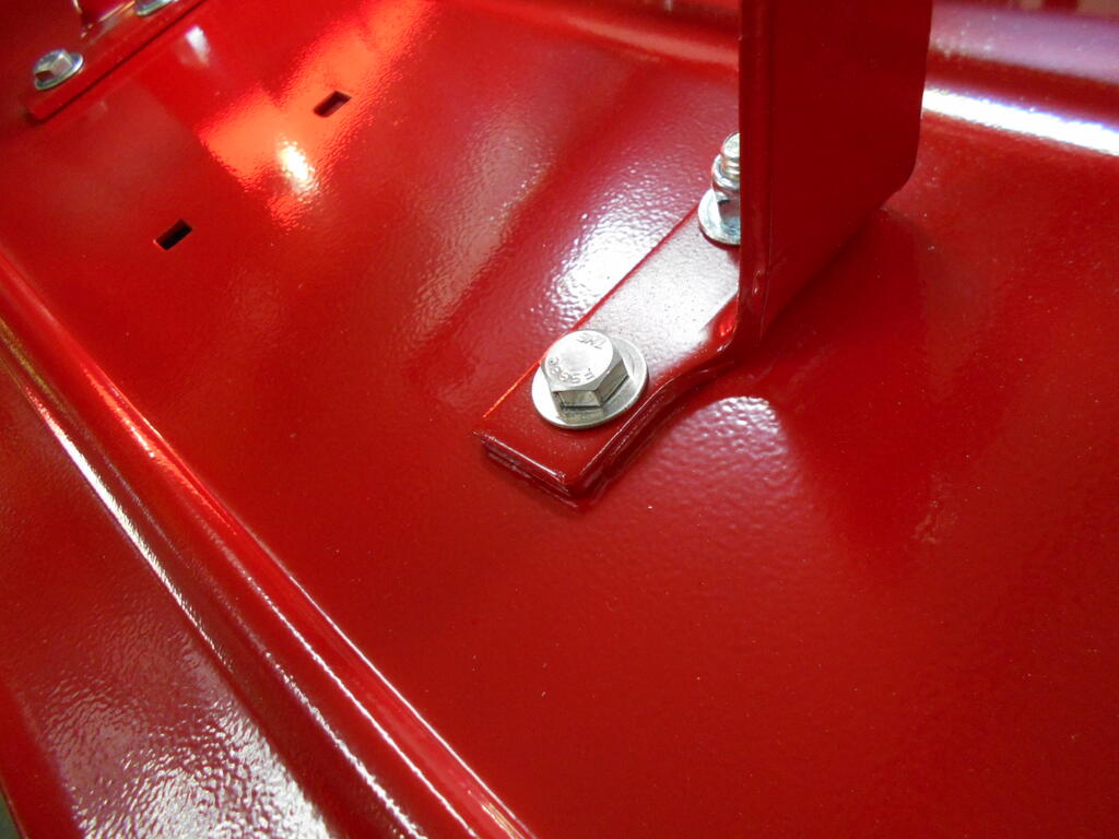

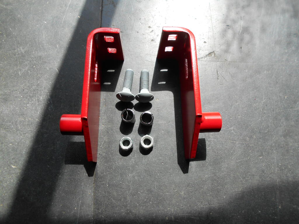

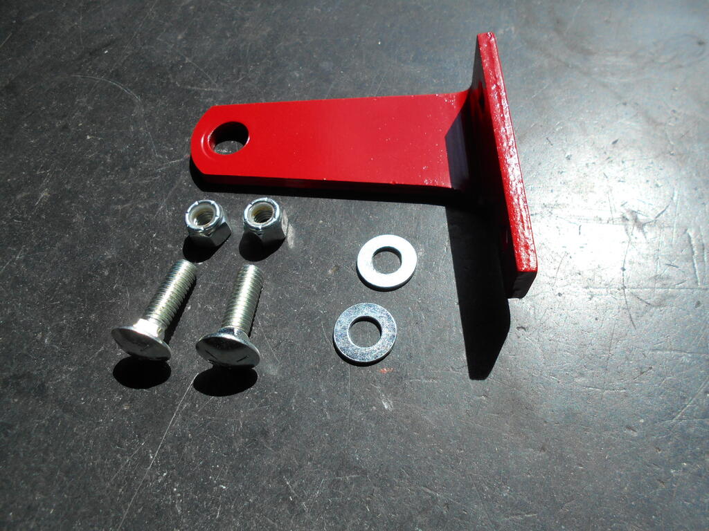

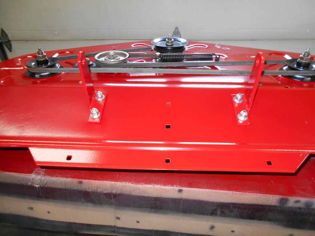

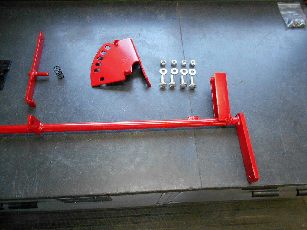

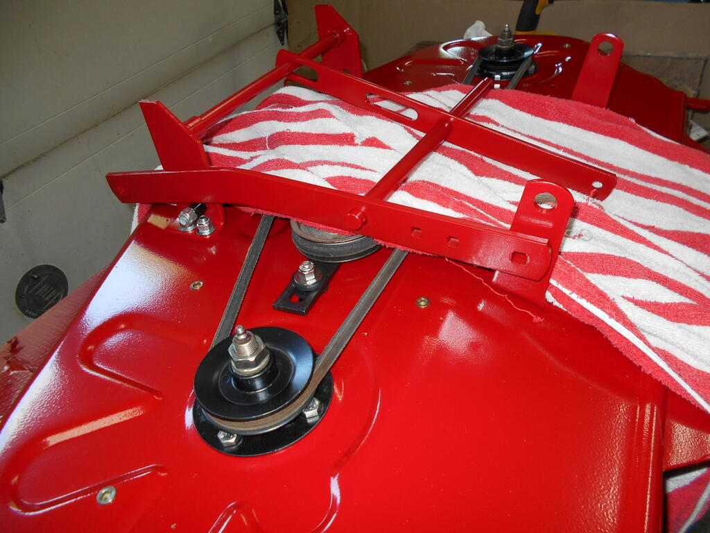

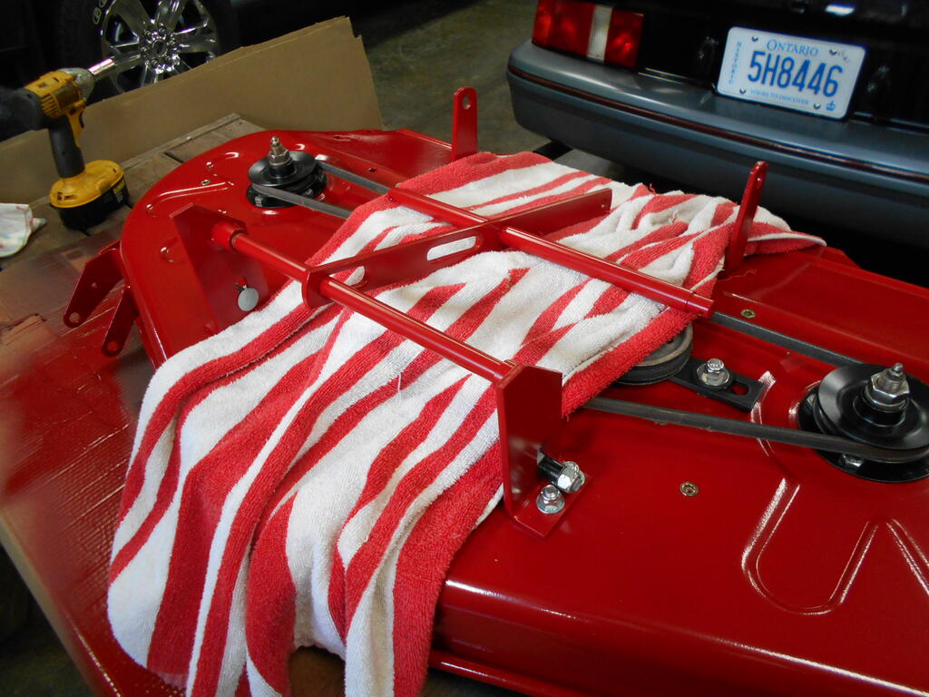

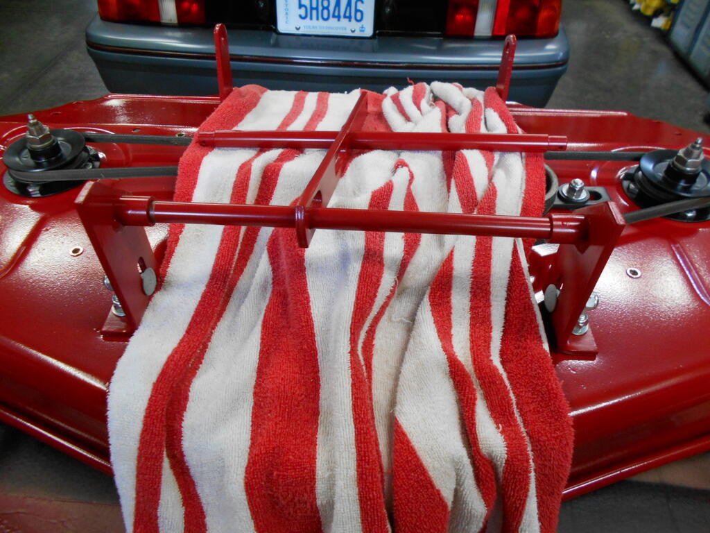

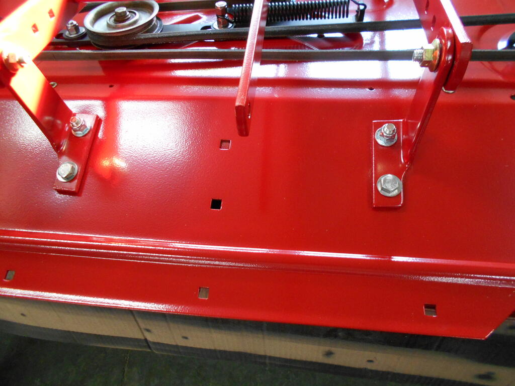

cleat 9,093 #26 Posted June 29, 2025 (edited) Rear bracket ready to install. Rear brackets installed. Transport stop hardware ready to install. Front brackets, Front shaft, Leveler, and transport stops installed. Left draft bar installed. Hardware used to bolt draft bar to brackets. Draft bars bolted in. Edited June 29, 2025 by cleat 2 Share this post Link to post Share on other sites

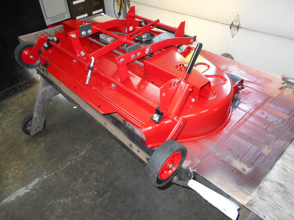

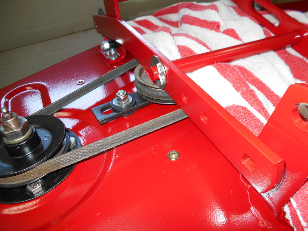

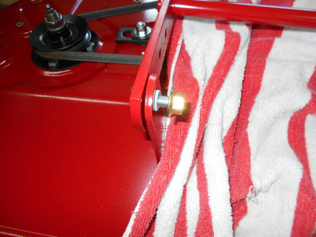

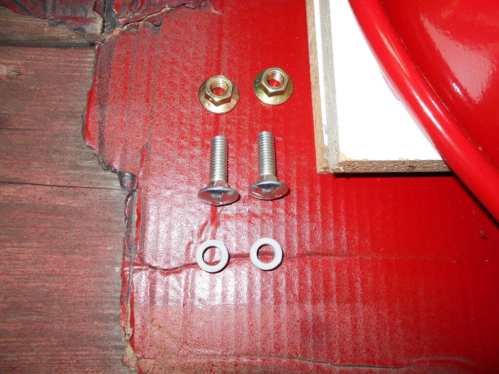

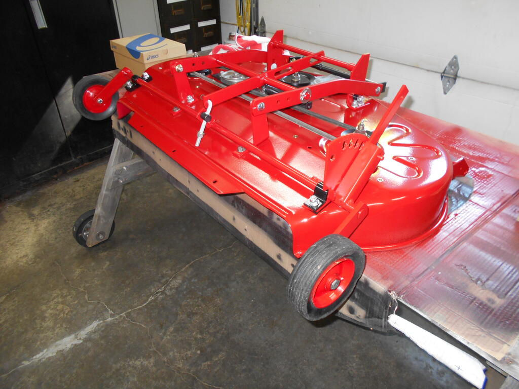

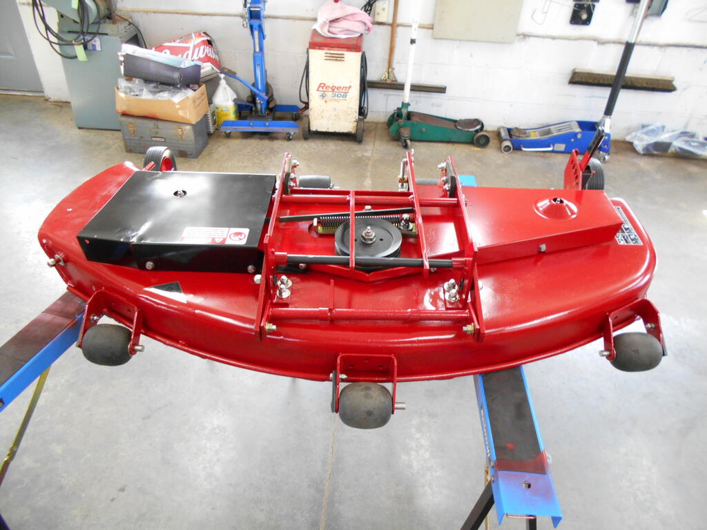

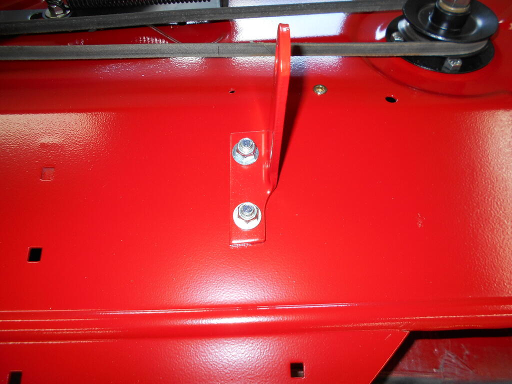

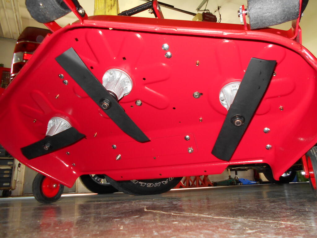

cleat 9,093 #27 Posted June 30, 2025 Hitch ready to install. This is a new one I made up at work a few years ago. Hitch installed. Gauge wheel assembly ready to install. When fitting the Gauge wheel support bar I found interference with the carriage bolts I had installed in the rear brackets. I installed standard hex bolts as per the parts diagram. Gauge wheel assembly installed and quadrant clearance set. 2 Share this post Link to post Share on other sites

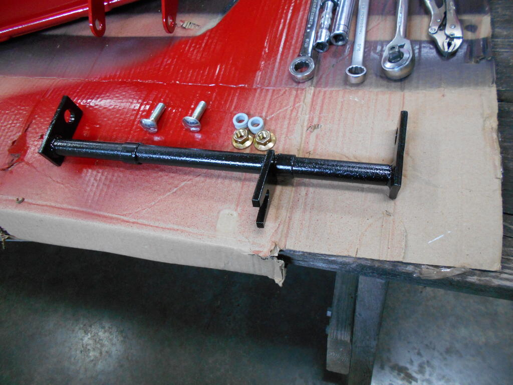

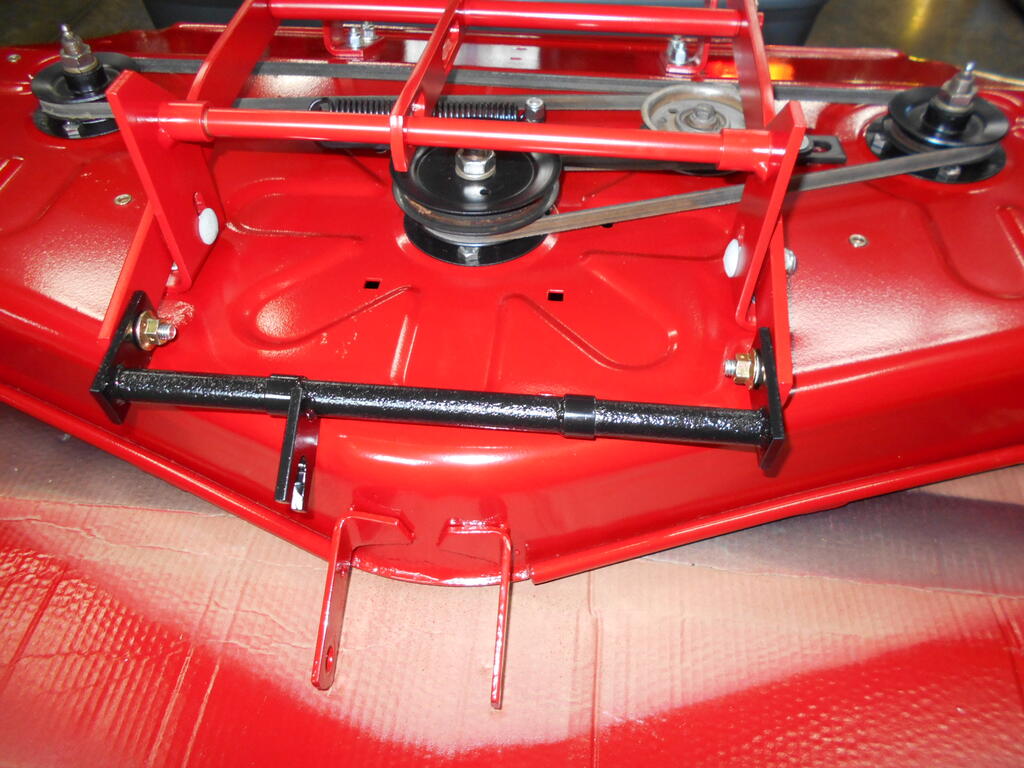

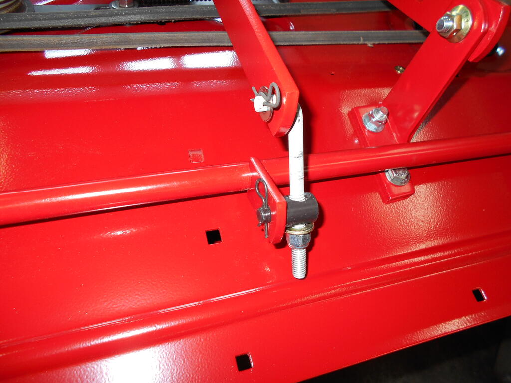

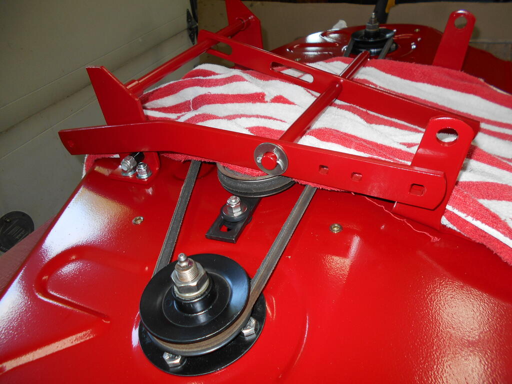

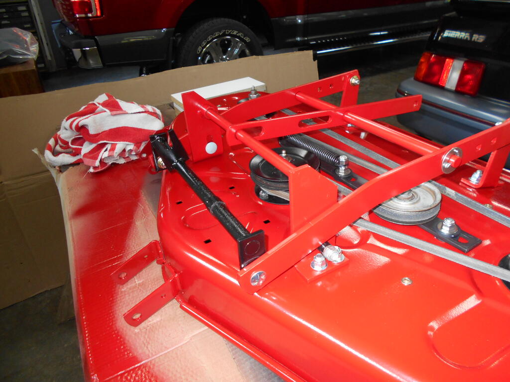

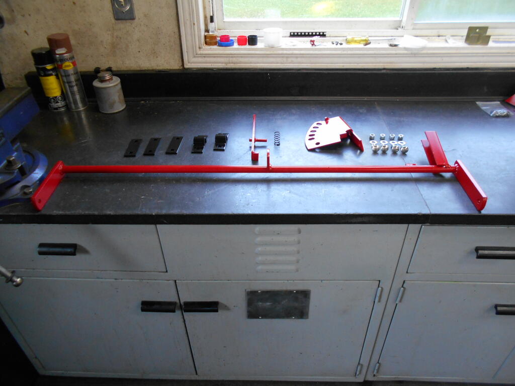

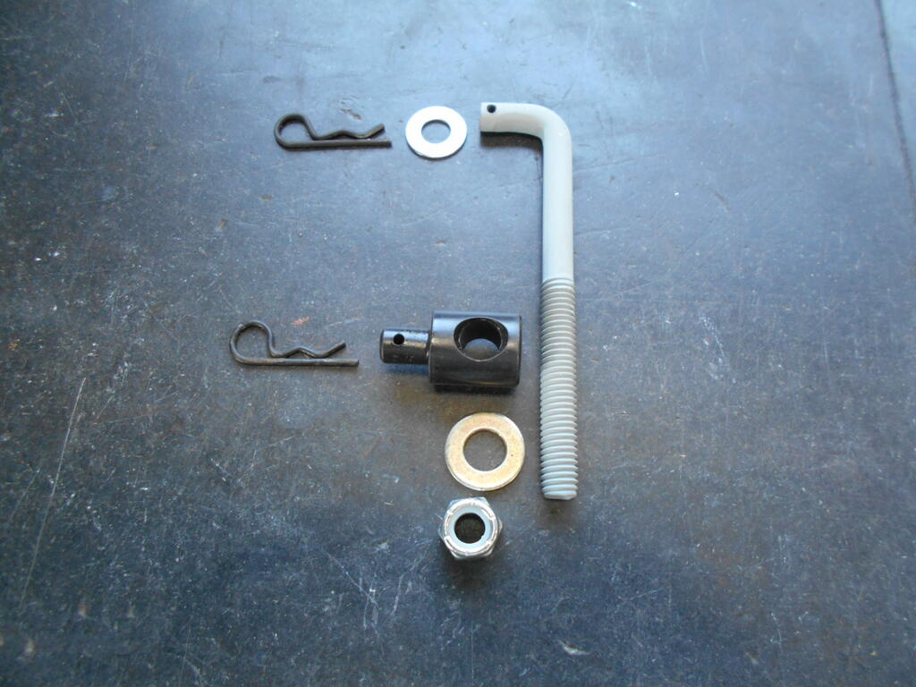

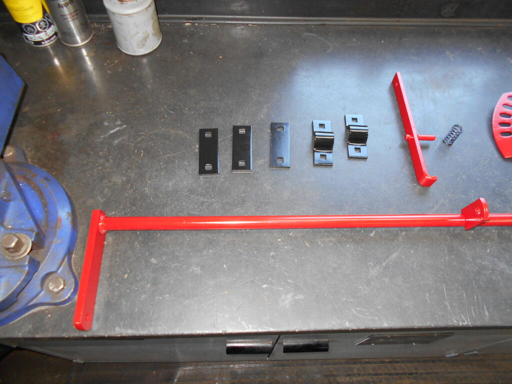

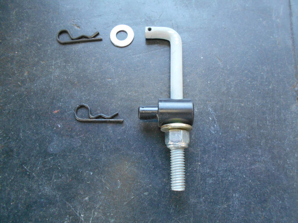

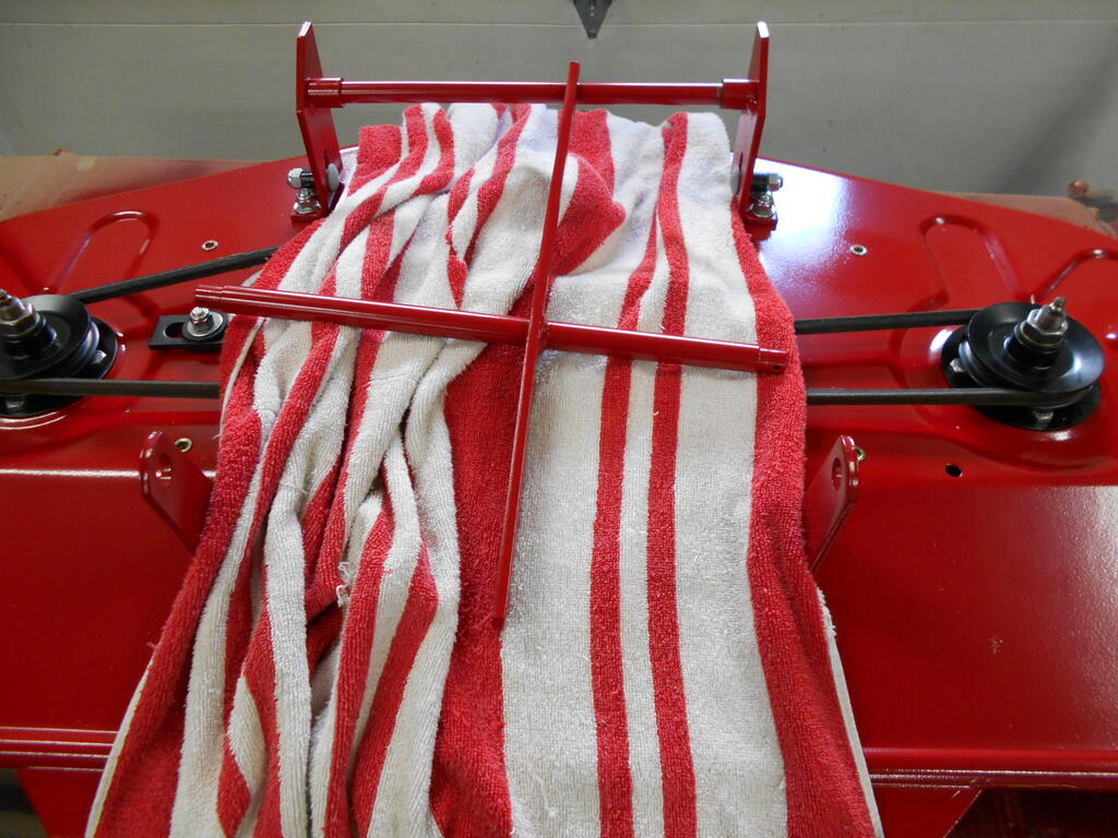

cleat 9,093 #28 Posted June 30, 2025 Leveler adjusting rod assembly ready to be installed. Leveler adjusting rod assembled and set a mid point of threads. Final adjustment to be done after deck installed to set deck level. Leveler adjusting rod assembly installed 2 Share this post Link to post Share on other sites

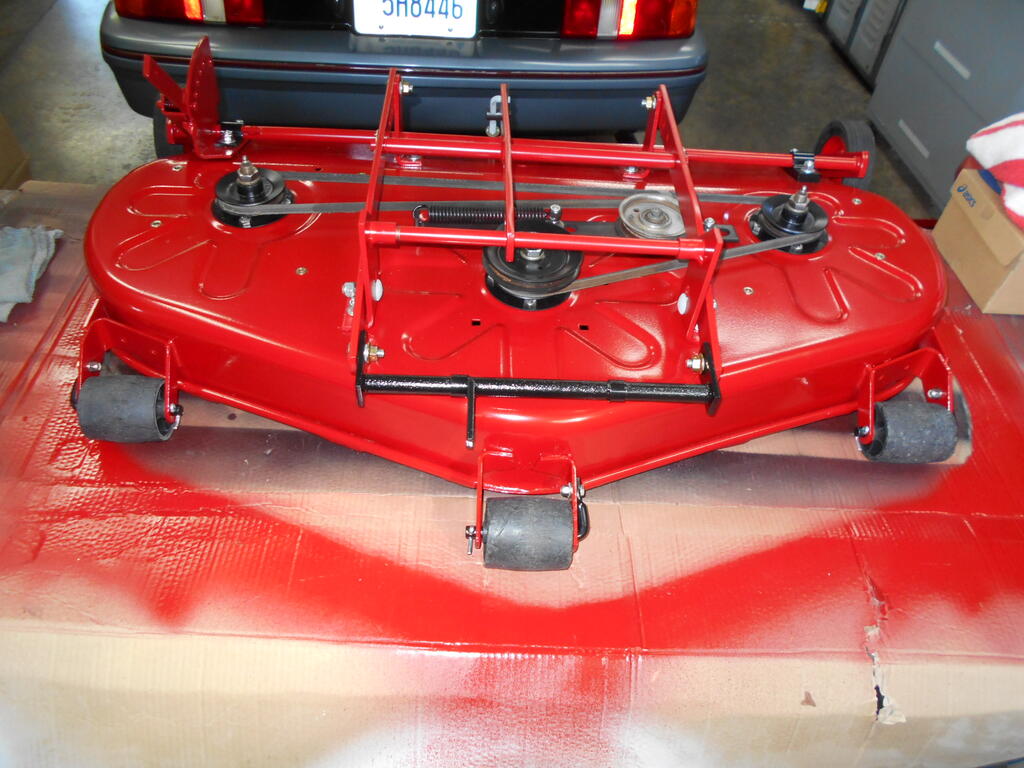

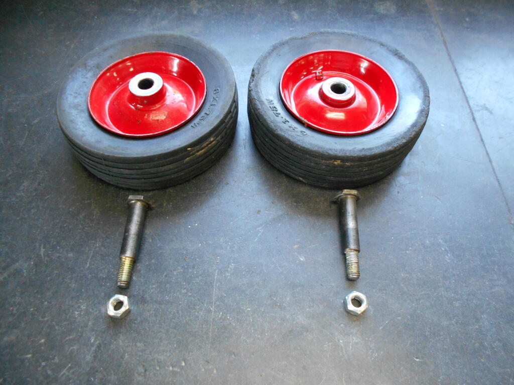

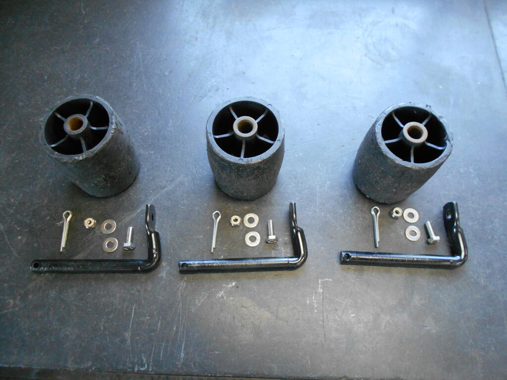

cleat 9,093 #29 Posted June 30, 2025 Deck gauge wheels ready to install. Deck gauge wheels installed. 2 Share this post Link to post Share on other sites

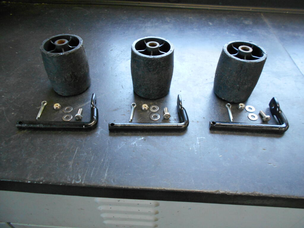

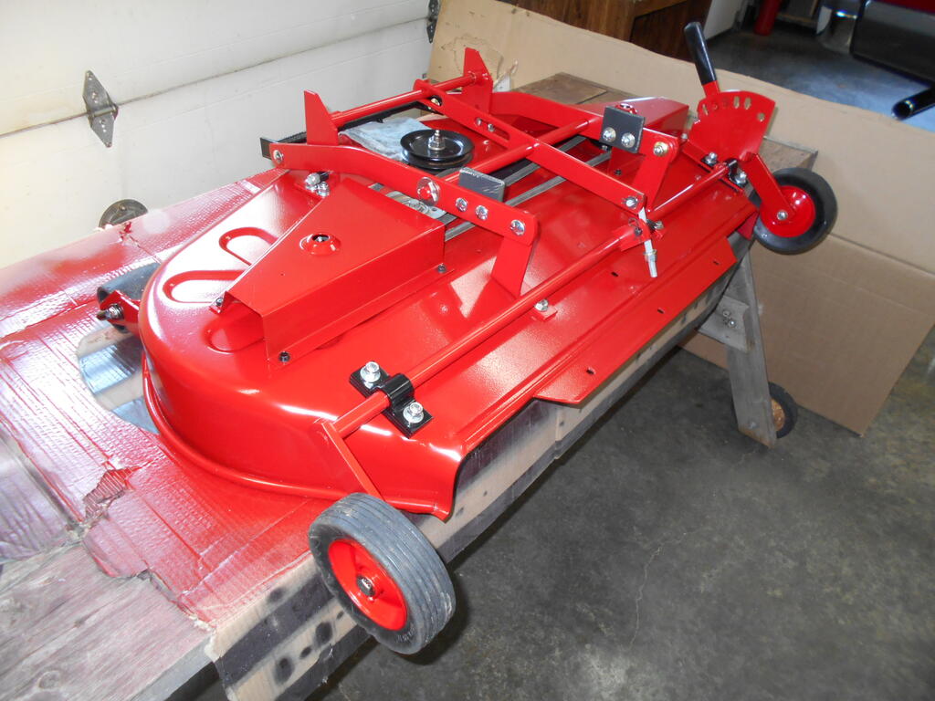

cleat 9,093 #30 Posted June 30, 2025 Deck rollers ready to be installed. Deck rollers installed. 2 Share this post Link to post Share on other sites

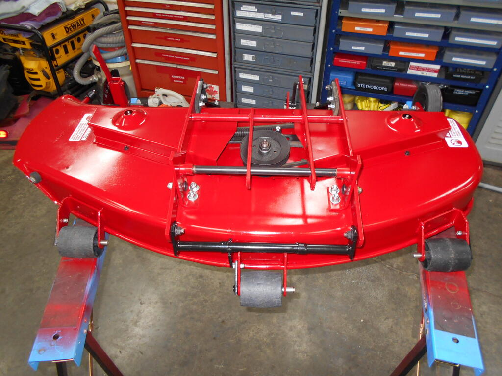

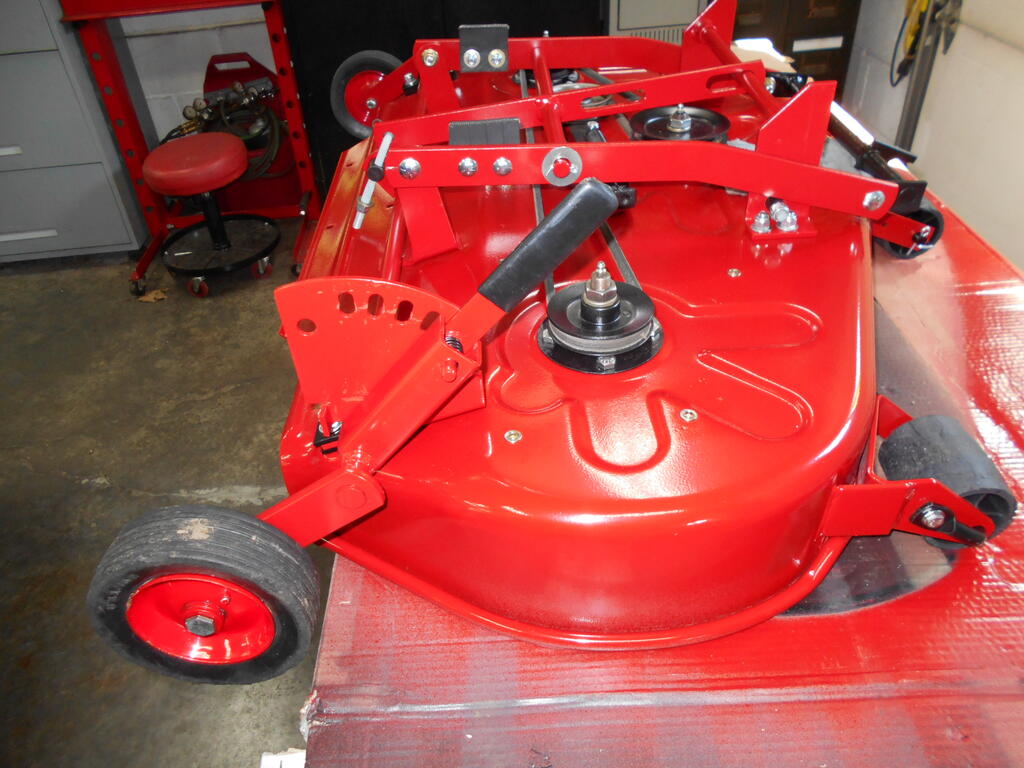

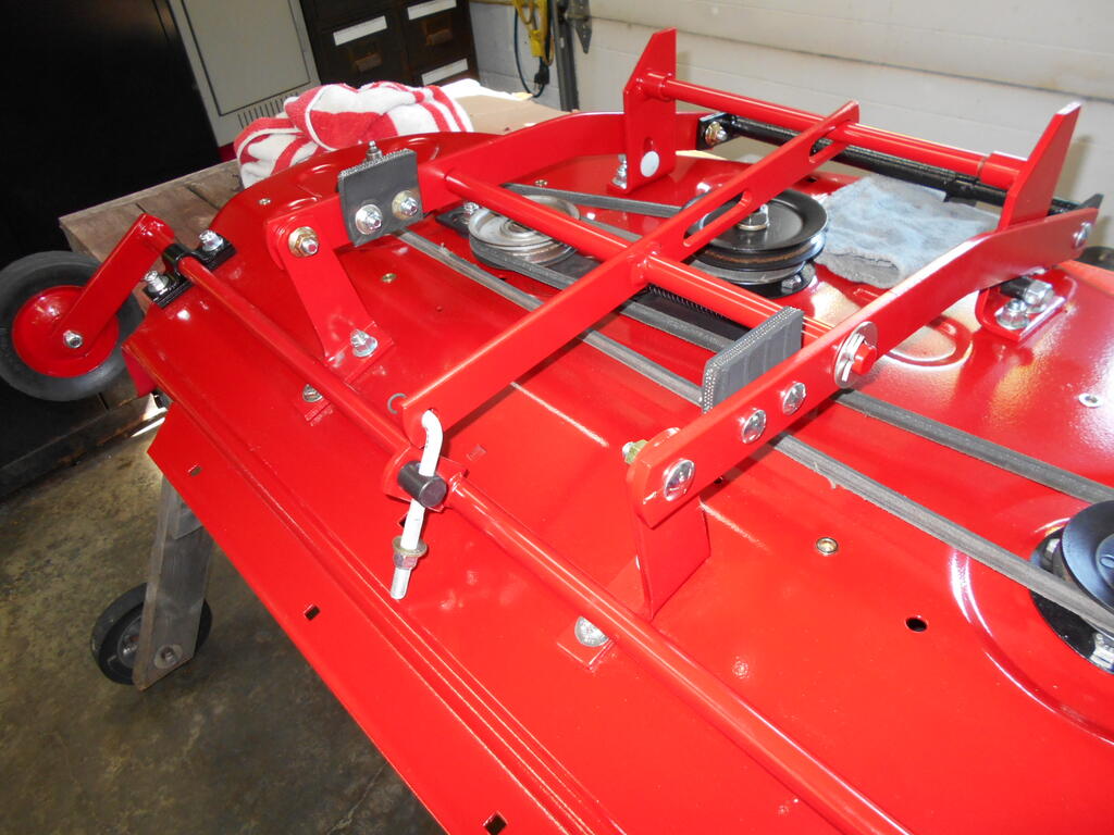

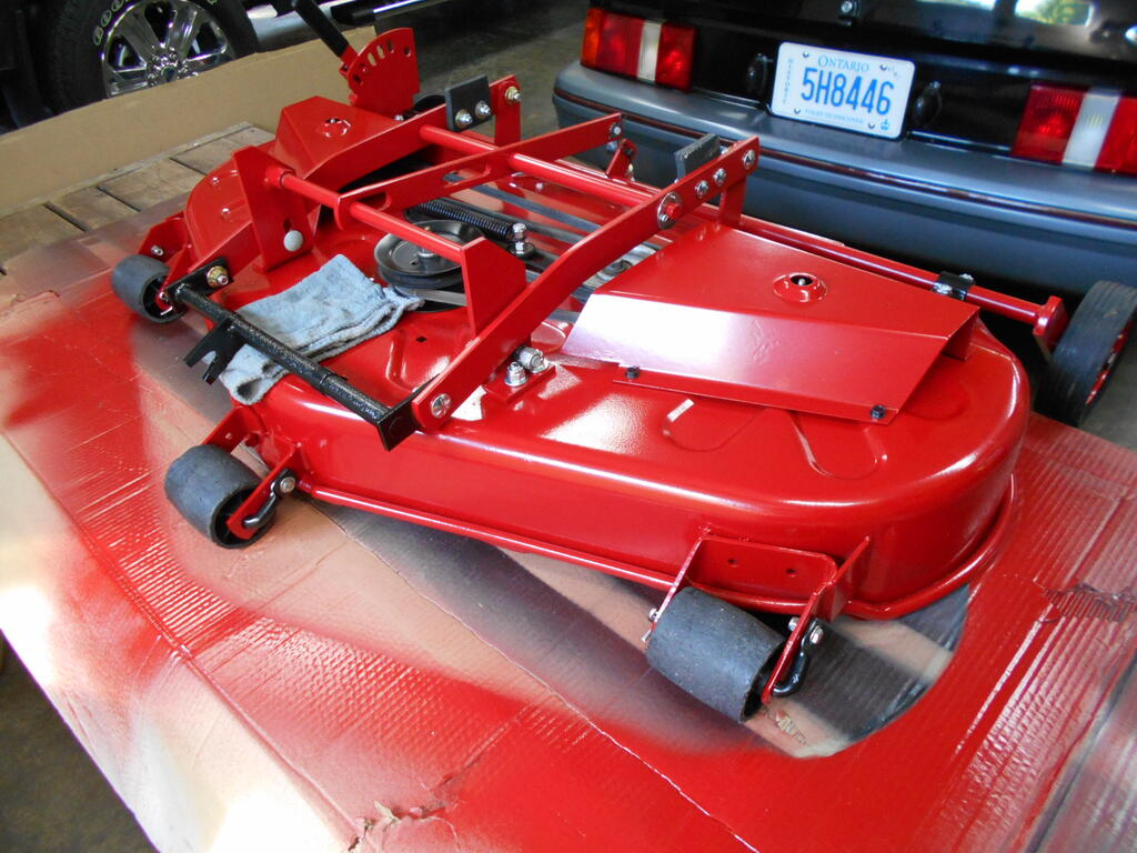

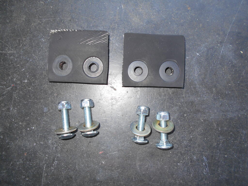

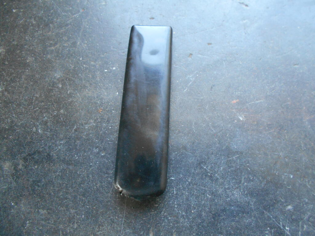

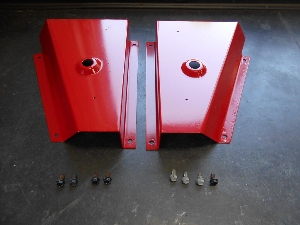

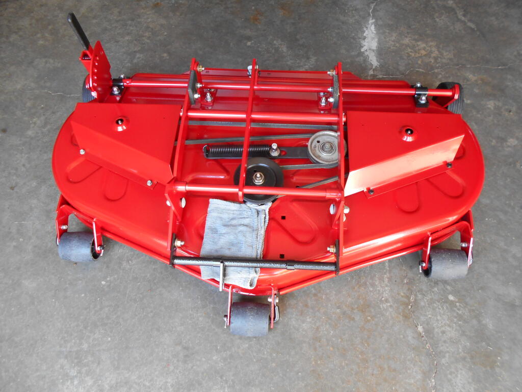

cleat 9,093 #31 Posted June 30, 2025 Rubber bumpers ready to be installed. Rubber bumpers installed. Deck cut height lever grip ready to be installed. Deck cut height lever grip installed. Deck belt covers ready to be installed. Deck belt covers installed. 1 Share this post Link to post Share on other sites

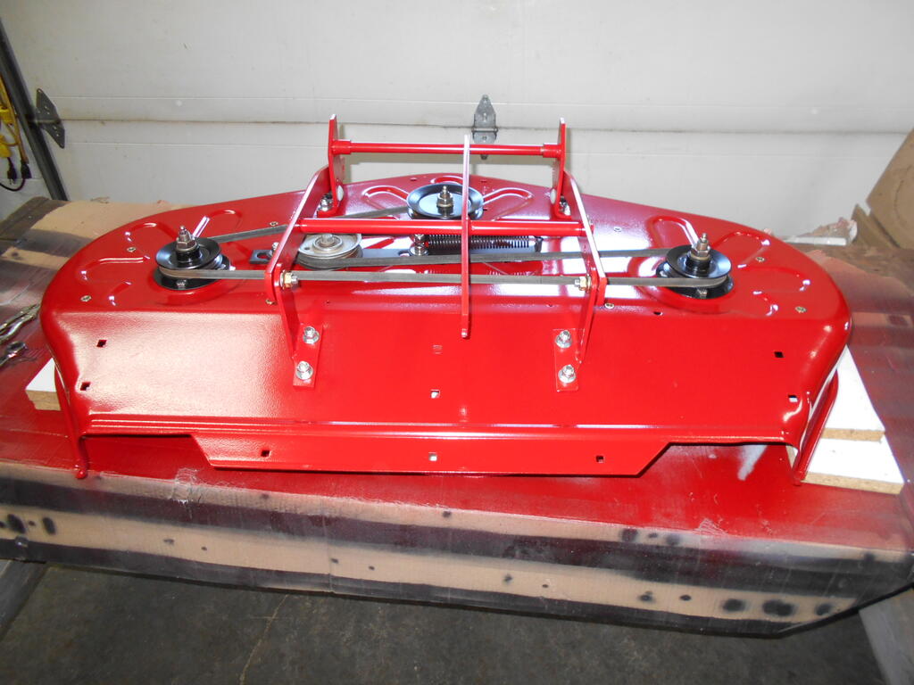

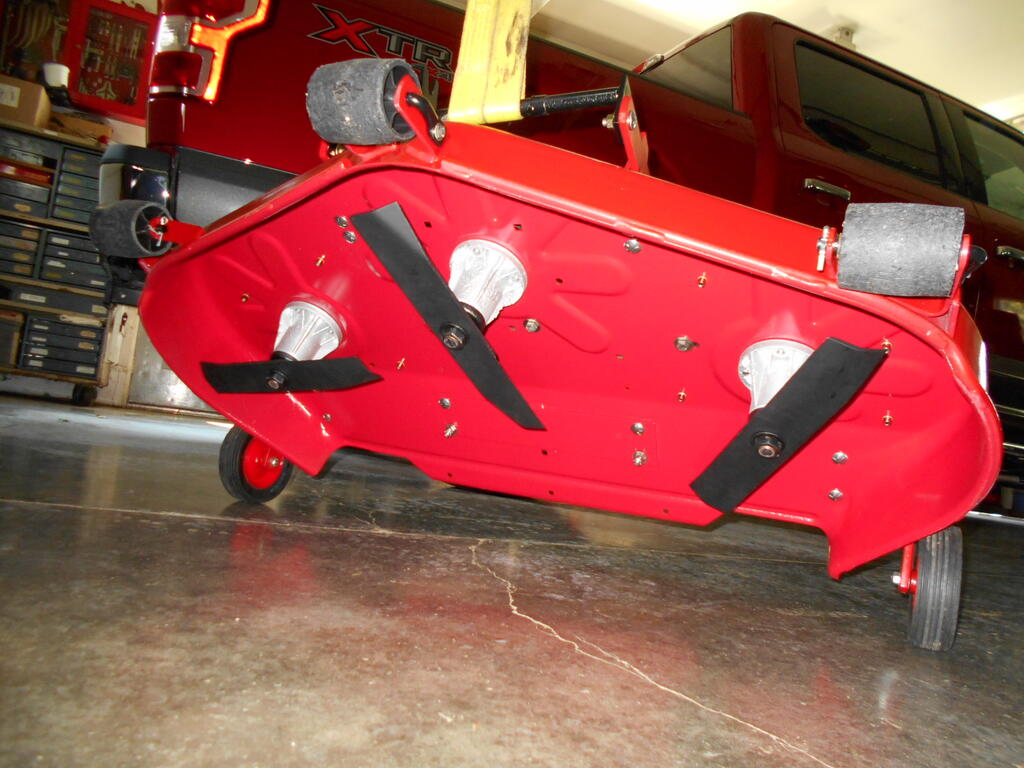

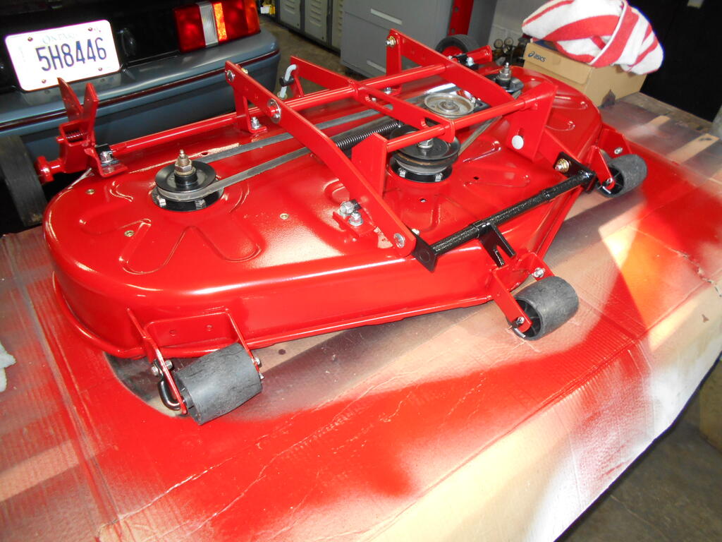

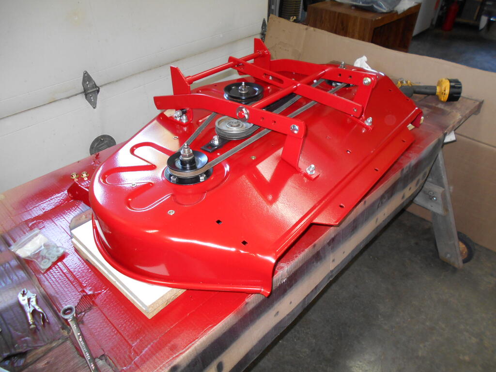

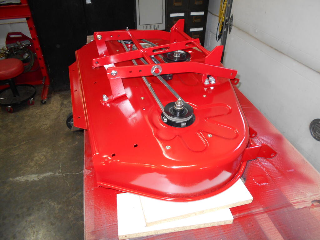

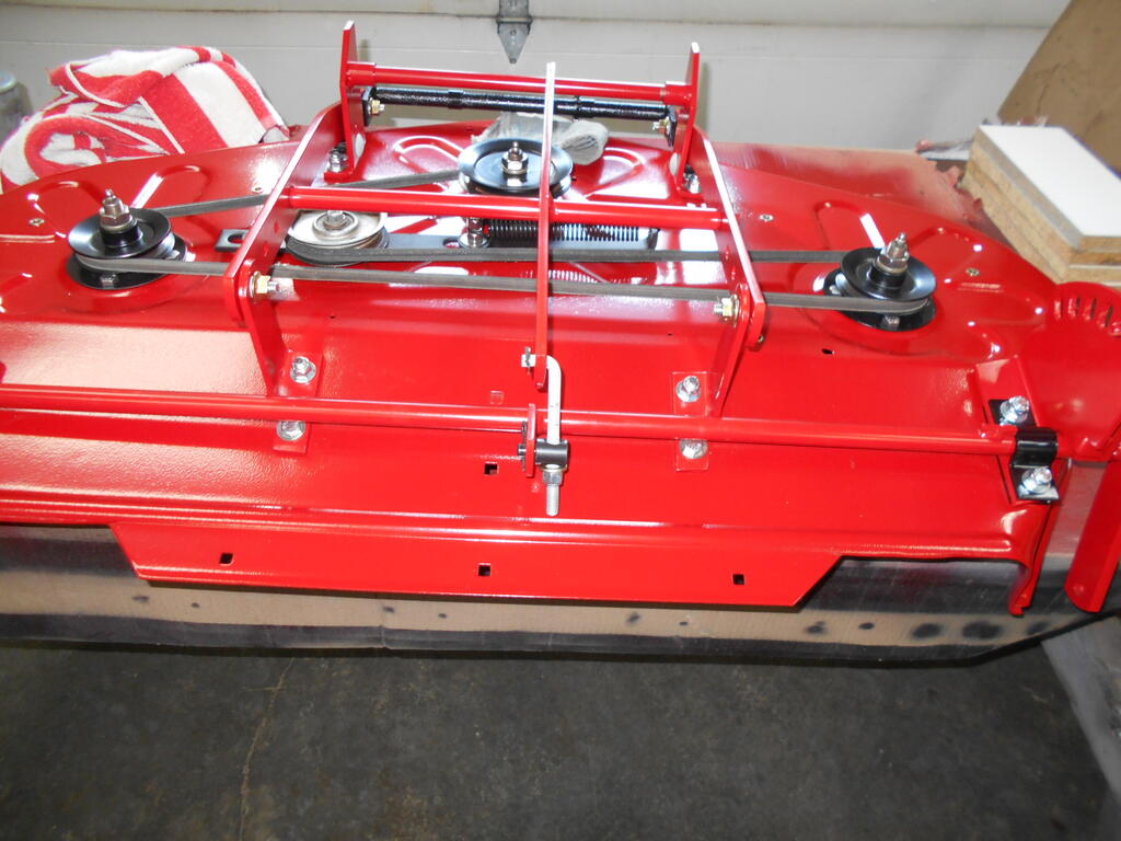

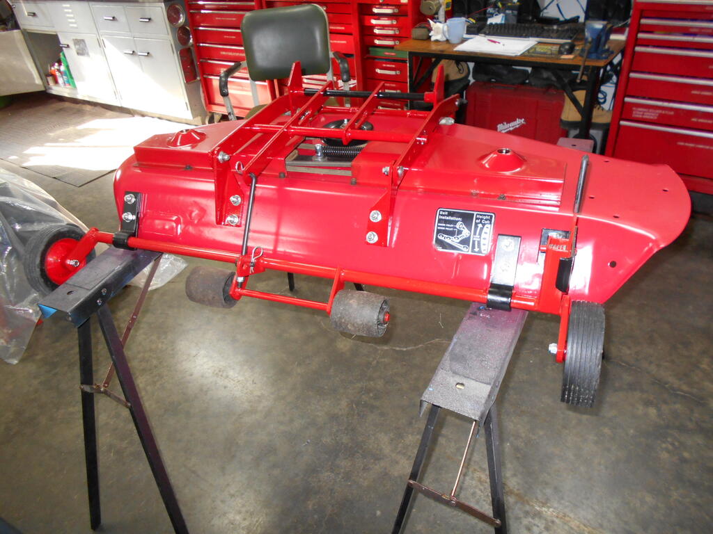

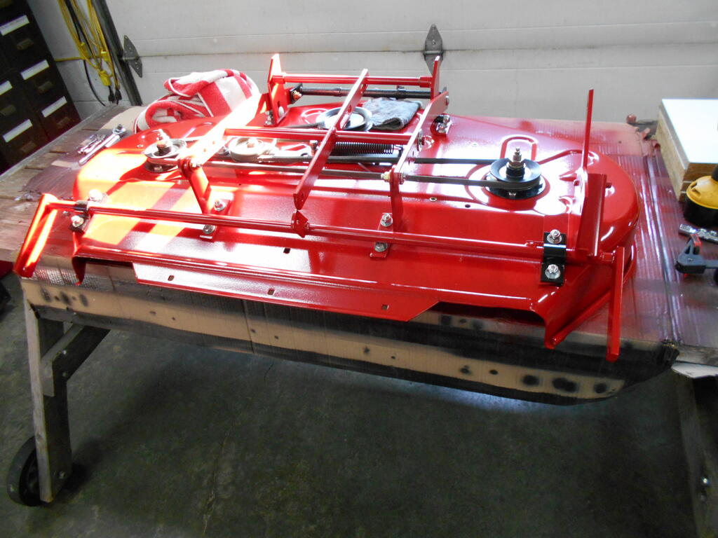

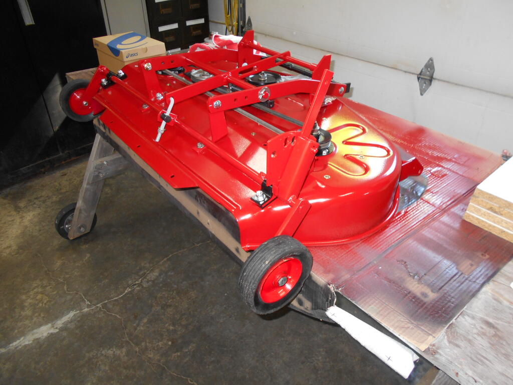

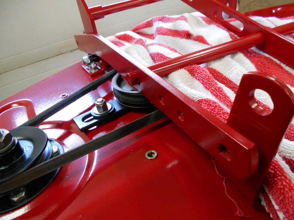

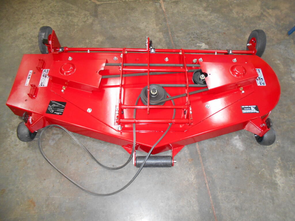

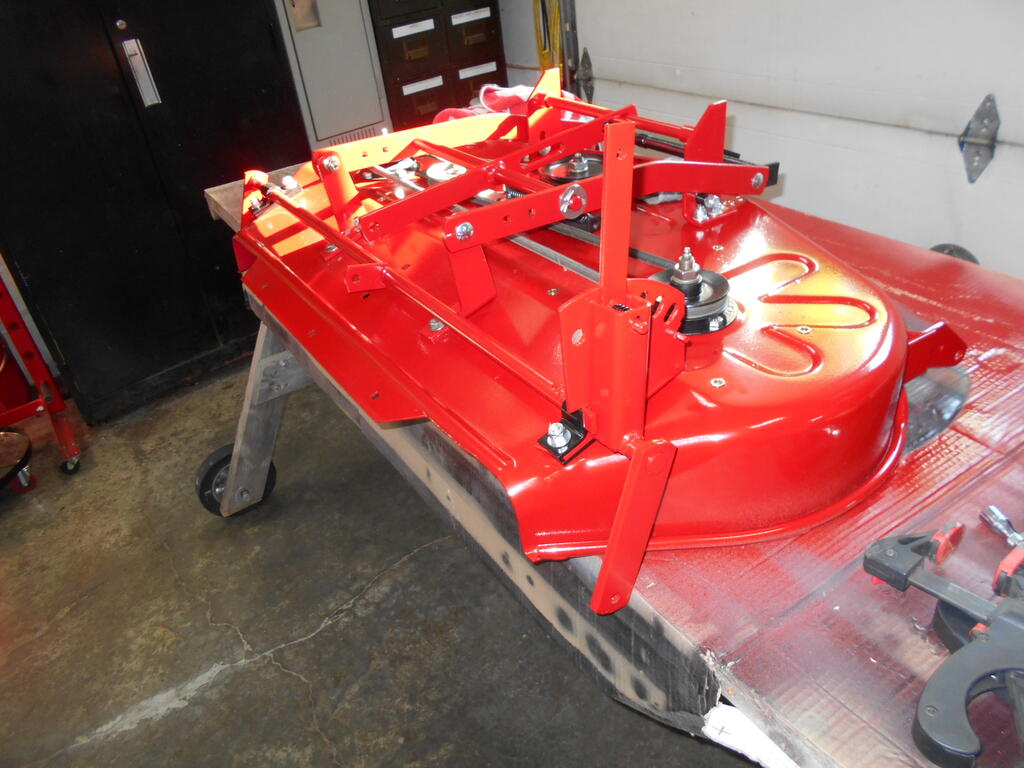

cleat 9,093 #32 Posted June 30, 2025 (edited) Deck complete except for decals. Bottom side complete. Edited June 30, 2025 by cleat 1 3 Share this post Link to post Share on other sites

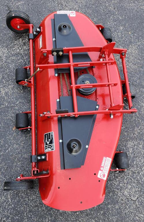

Brockport Bill 2,448 #35 Posted July 1, 2025 spectacular -- the BIG question is do you hang it on the wall like an art project so you can look at it???? -- or do you use it and get it dirty?!!!!!!!! -- Like you did --- When I do a deck rehab, I always like doing a few parts with the black paint as an accent -- the rear axle brackets - the pulleys - the lift index unit - even the pulley belt covers - also I do the front rollers in new black plus the rubber lift carriage bumpers get new paint - you did nice job -- now you'll want to do another -- then another, etc!!!!!!!!!! Here are couple different deck rehab photo examples 2 Share this post Link to post Share on other sites

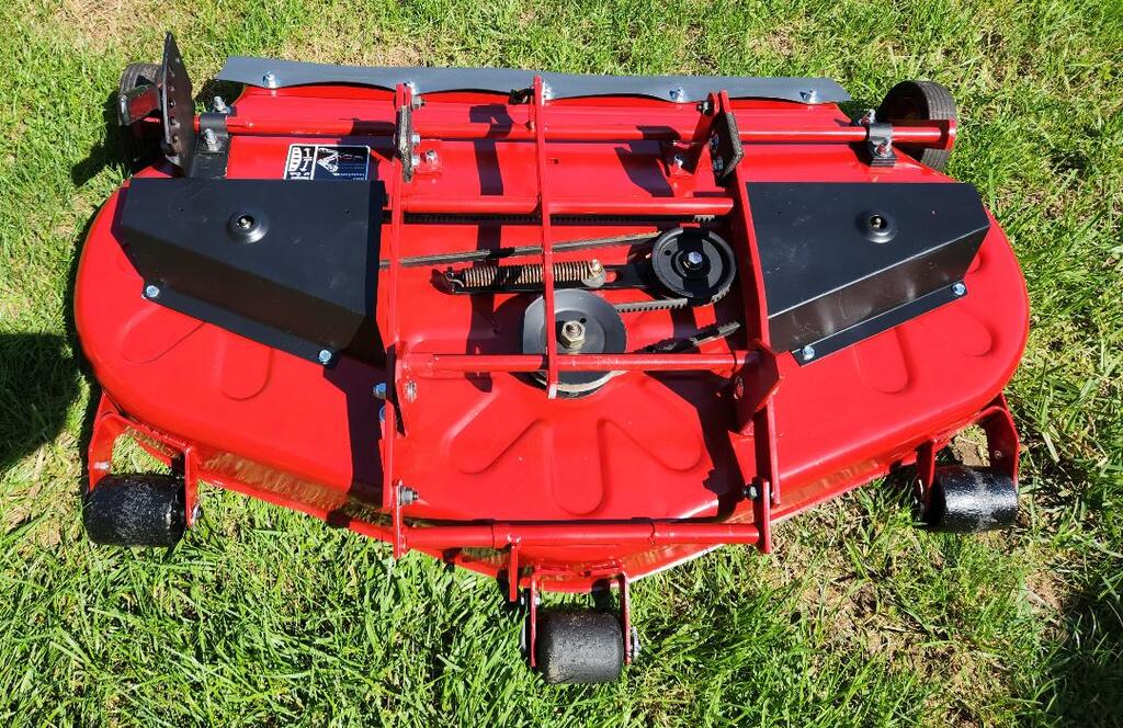

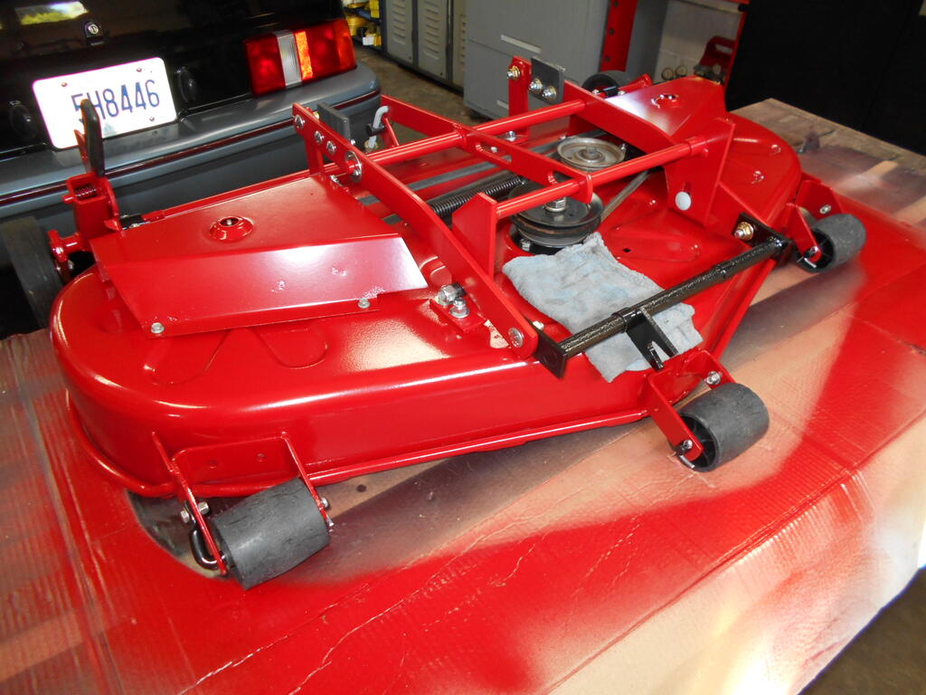

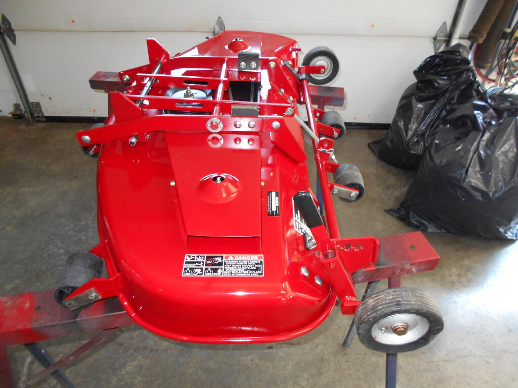

cleat 9,093 #36 Posted July 1, 2025 (edited) Yes, I have these decks here currently that I have refurbished. These have not been used since. 42" #1 42" #2 48" #1 60" This is the 48" I mow with so it is not as pretty any more. It currently does not have a bagger attached so it has the standard belt guard installed. Edited July 1, 2025 by cleat 1 Share this post Link to post Share on other sites

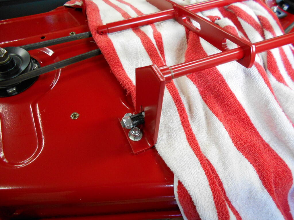

mrc 1,108 #37 Posted July 1, 2025 geez, even the towels you used to prevent scratching are color coordinated! (red and white) as always, your work is top notch! 1 Share this post Link to post Share on other sites

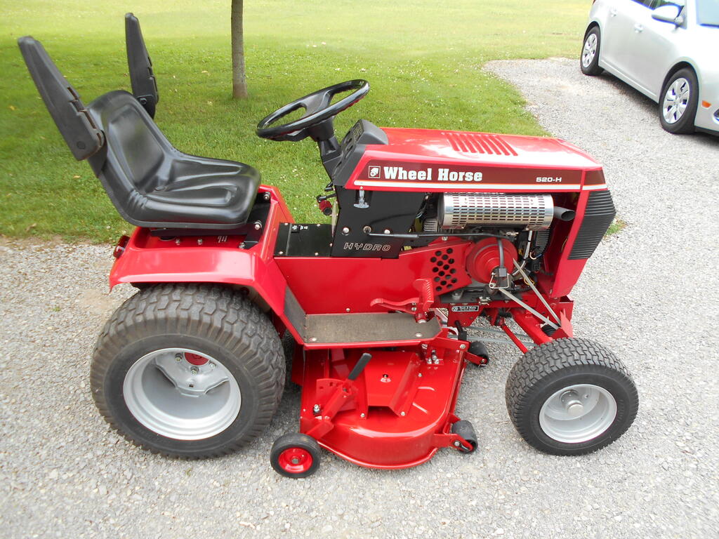

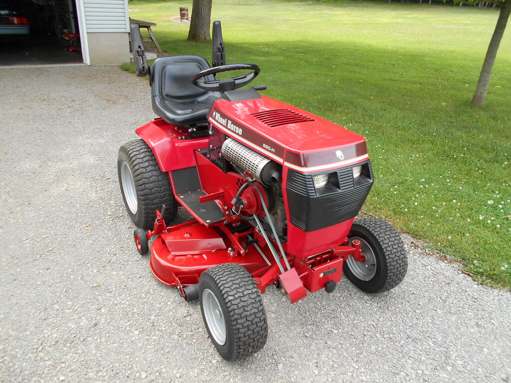

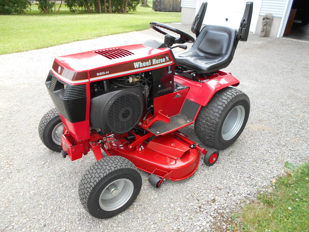

cleat 9,093 #38 Posted July 1, 2025 Installed the deck on a 520 mainly to get it moved out of my shop. I did run it without mowing grass and it is so quiet you can't hear it run at all. 4 Share this post Link to post Share on other sites
