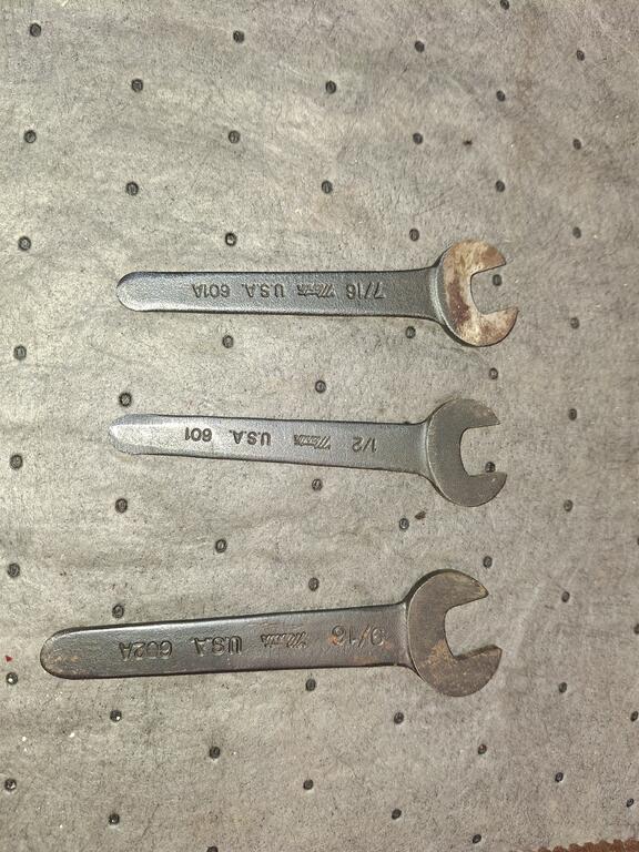

squonk 45,501 #3 Posted April 24, 2025 (edited) Big block carbs are1/2". Smallies are 7/16". I have a set of small thin wrenches for breaking them loose and final tightening. Run the bolts in and out with a long thin screwdriver Edited April 24, 2025 by squonk 1 Share this post Link to post Share on other sites
