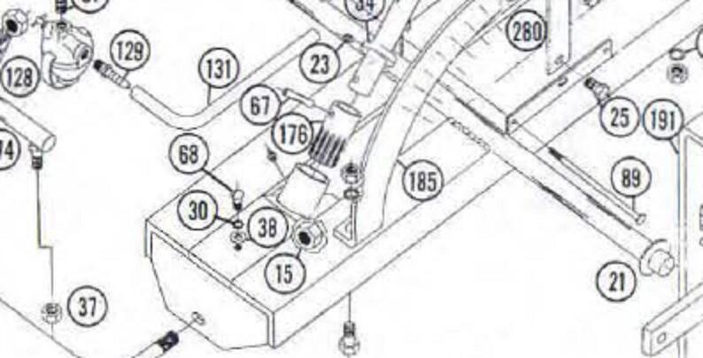

gwest_ca-(File Mod) 12,018 #2 Posted April 23, 2025 The illustrated parts list shows a pinned gear Share this post Link to post Share on other sites

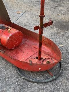

jsp_333 286 #13 Posted April 26, 2025 (edited) On 4/24/2025 at 9:20 PM, wallfish said: The lower roll pin on the gear is MUCH easier to remove than the steering wheel one. If you got the steering wheel pin out someone has definitely been there before you. Glad you got it! What's the issue with the gears? Is the fan gear stripped? There should be a merit badge or some special designation for anyone who can get the roll pin out of a steering wheel. I had to get the worm gear off to slide off the steering column support tube. It had been cut free of the hood support tower by the same numbnuts who tried to put a bigger engine in it. I think it will be easier to weld back in place if I don't have to fight with the hood while I'm trying to do it. Edited April 26, 2025 by jsp_333 Share this post Link to post Share on other sites

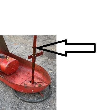

wallfish 19,403 #14 Posted April 26, 2025 2 hours ago, jsp_333 said: I think it will be easier to weld back in place if I don't have to fight with the hood while I'm trying to do it. Cut the lock collar off as it can be replaced with a split collar when you're done. That way the hood is off the shaft Share this post Link to post Share on other sites
jsp_333 286 #15 Posted April 27, 2025 cool, didn't know they were made like that Share this post Link to post Share on other sites
