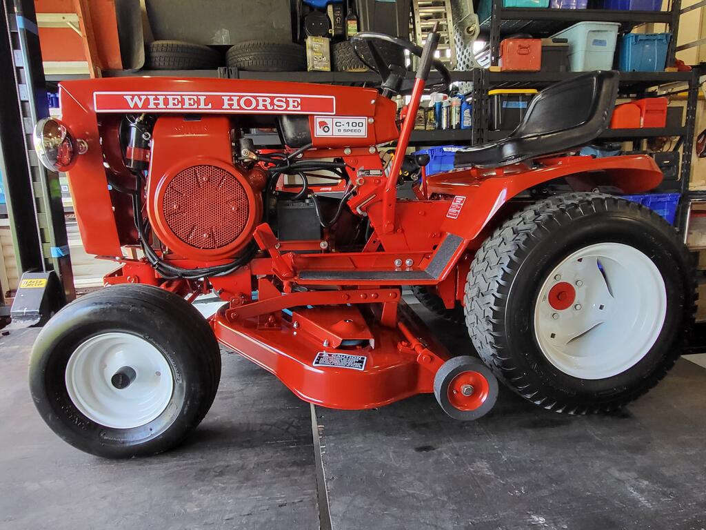

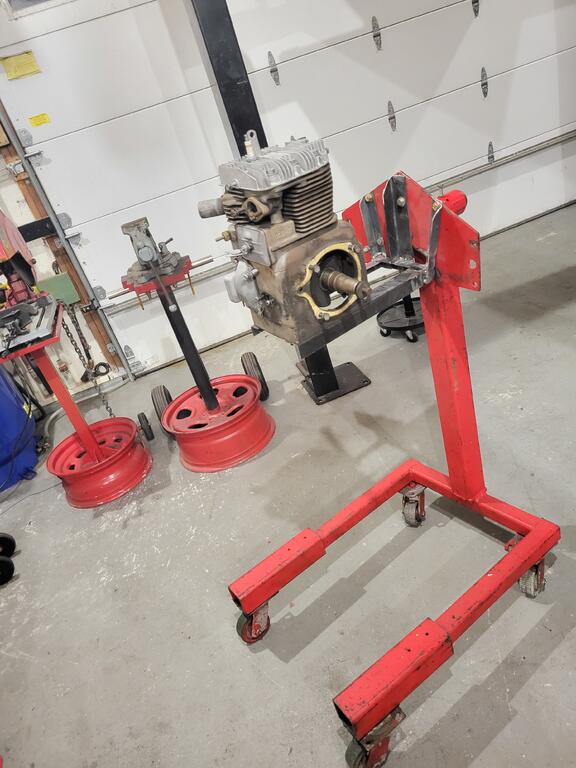

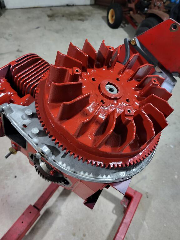

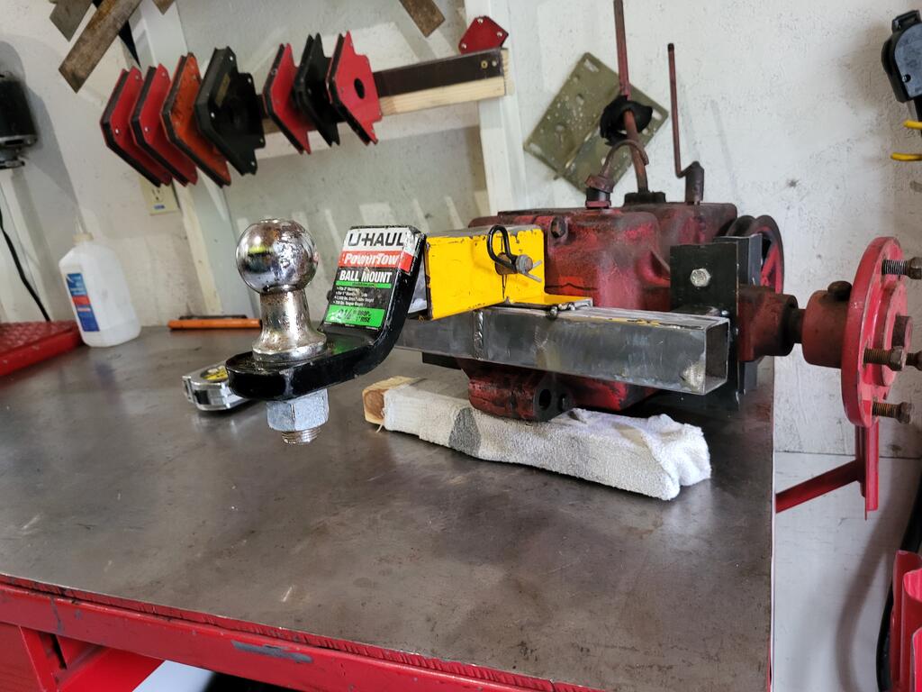

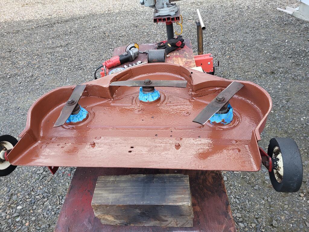

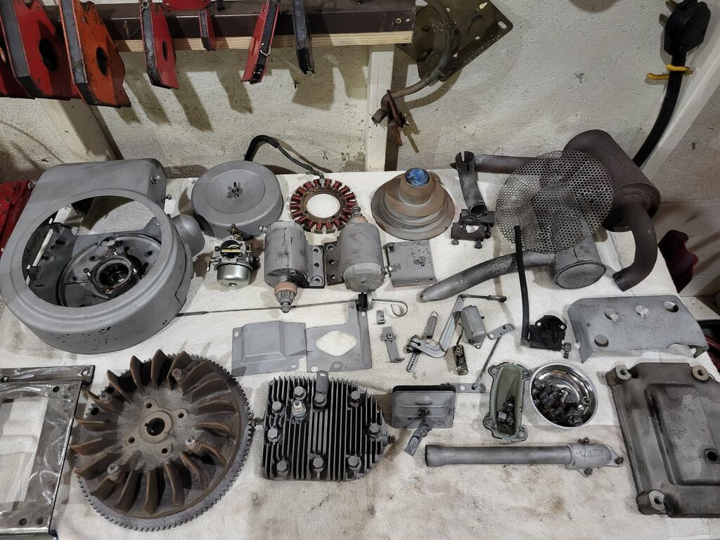

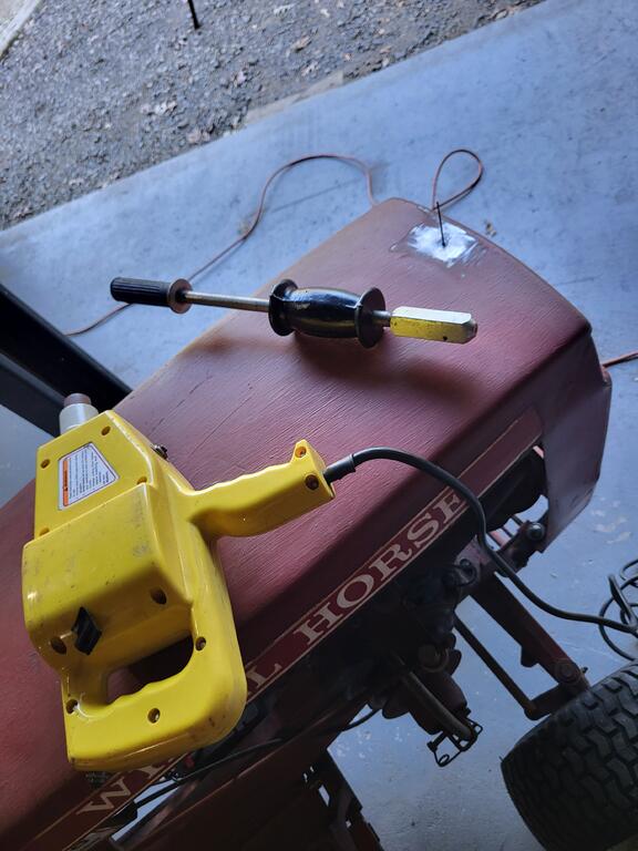

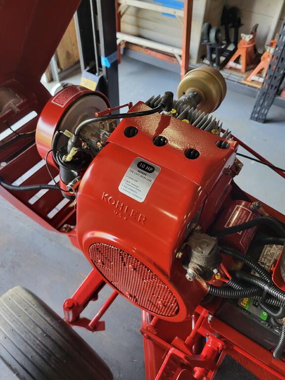

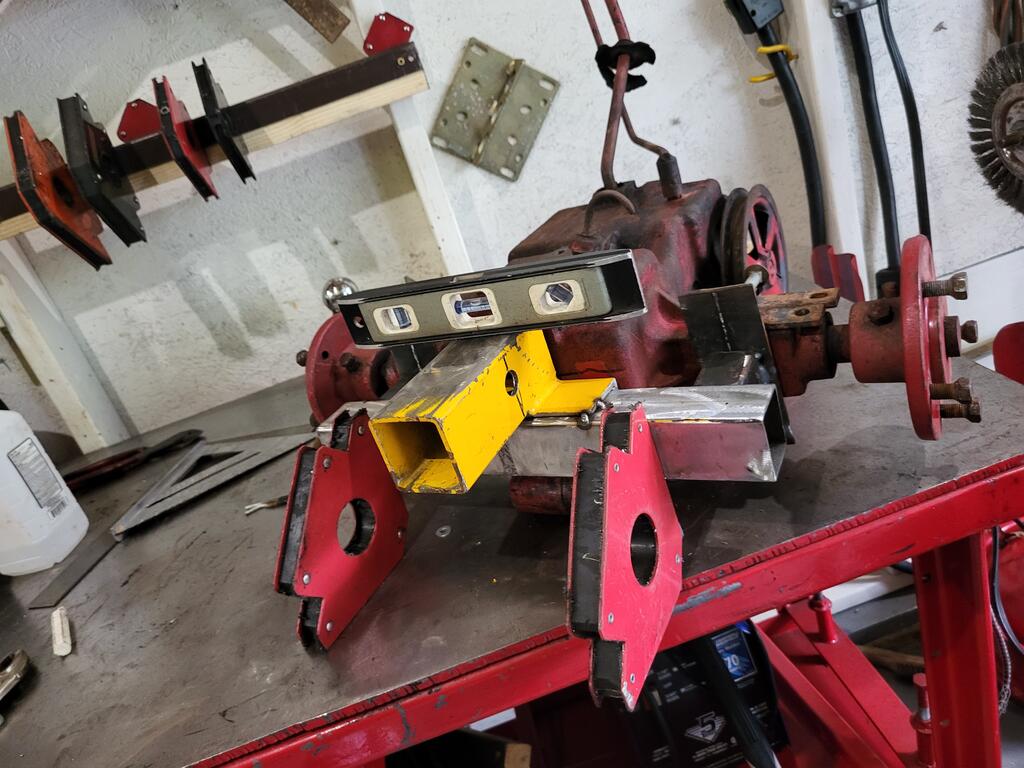

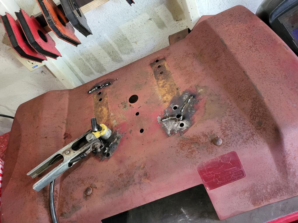

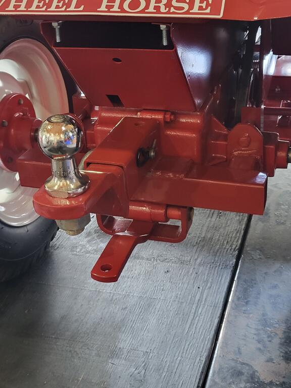

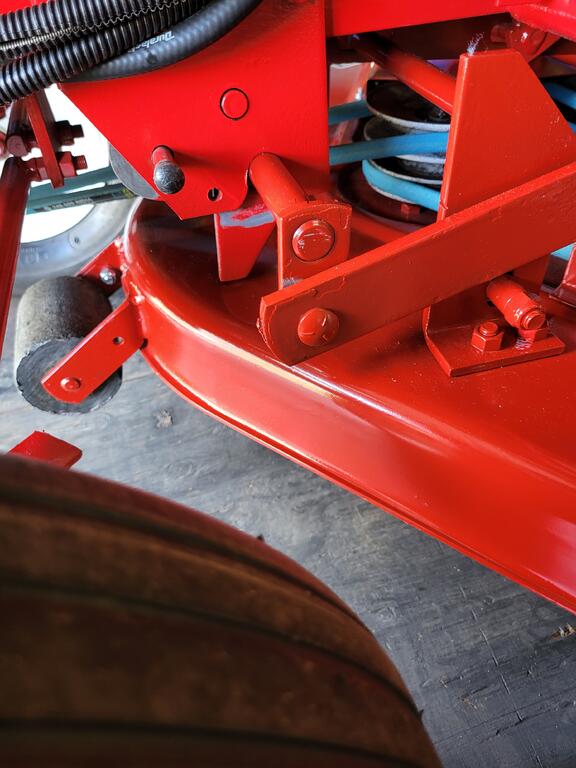

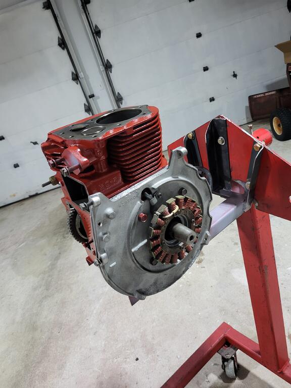

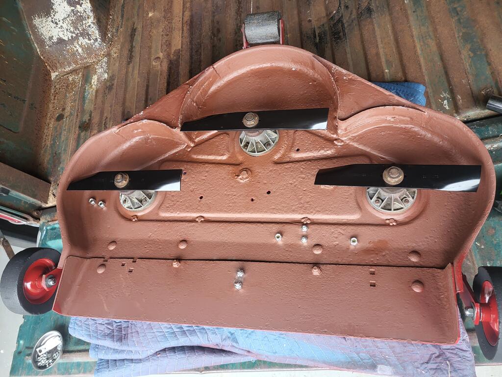

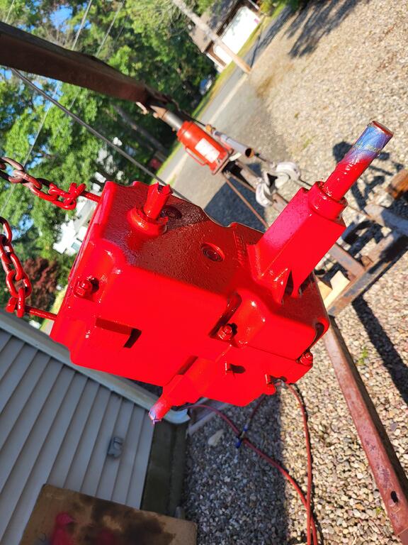

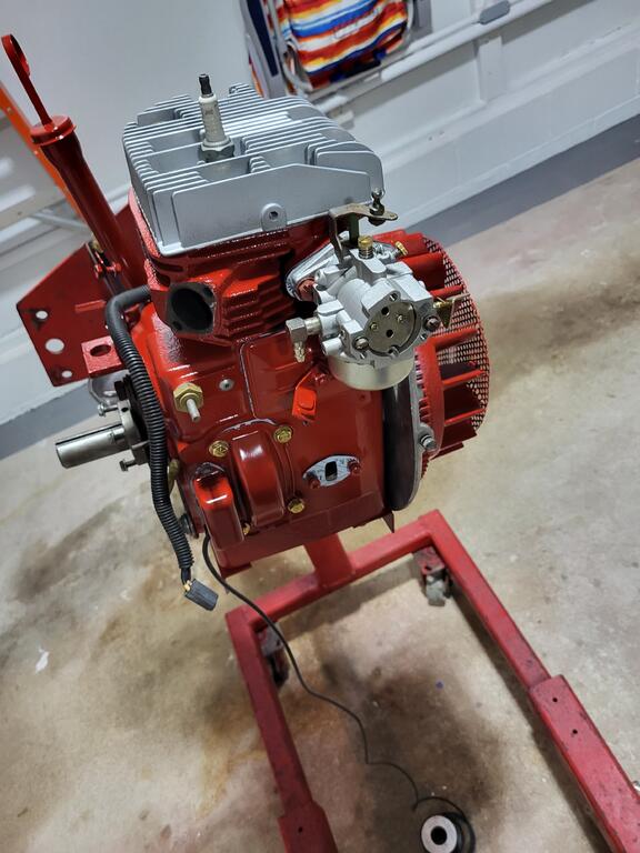

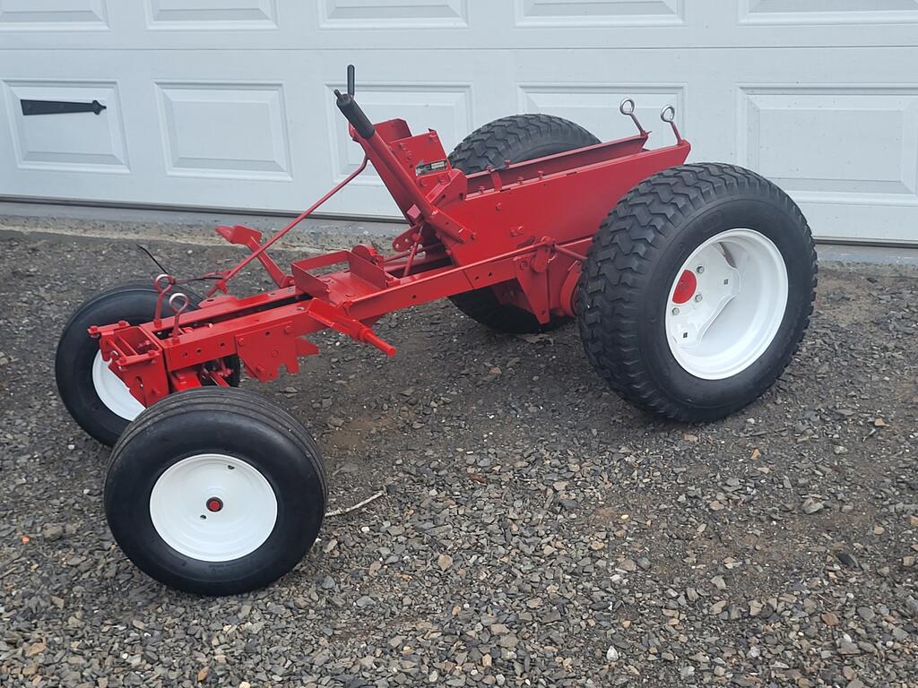

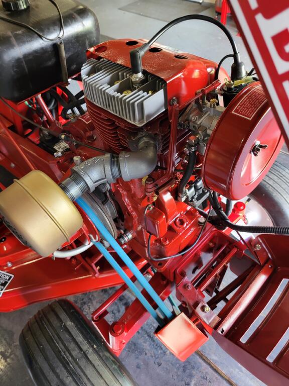

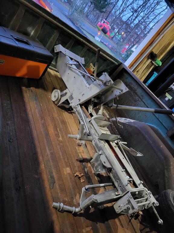

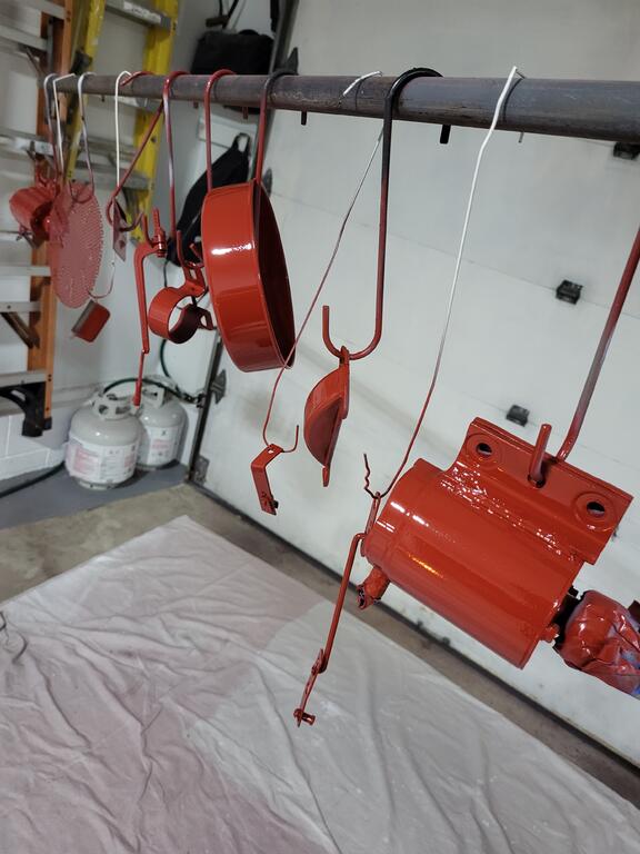

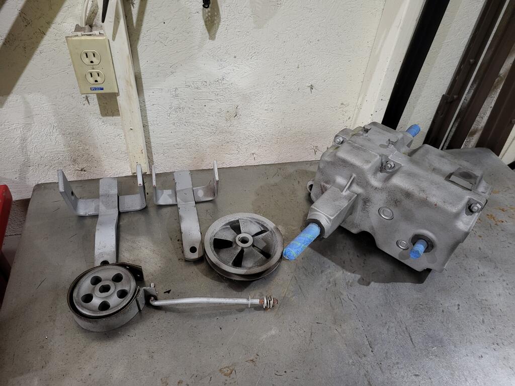

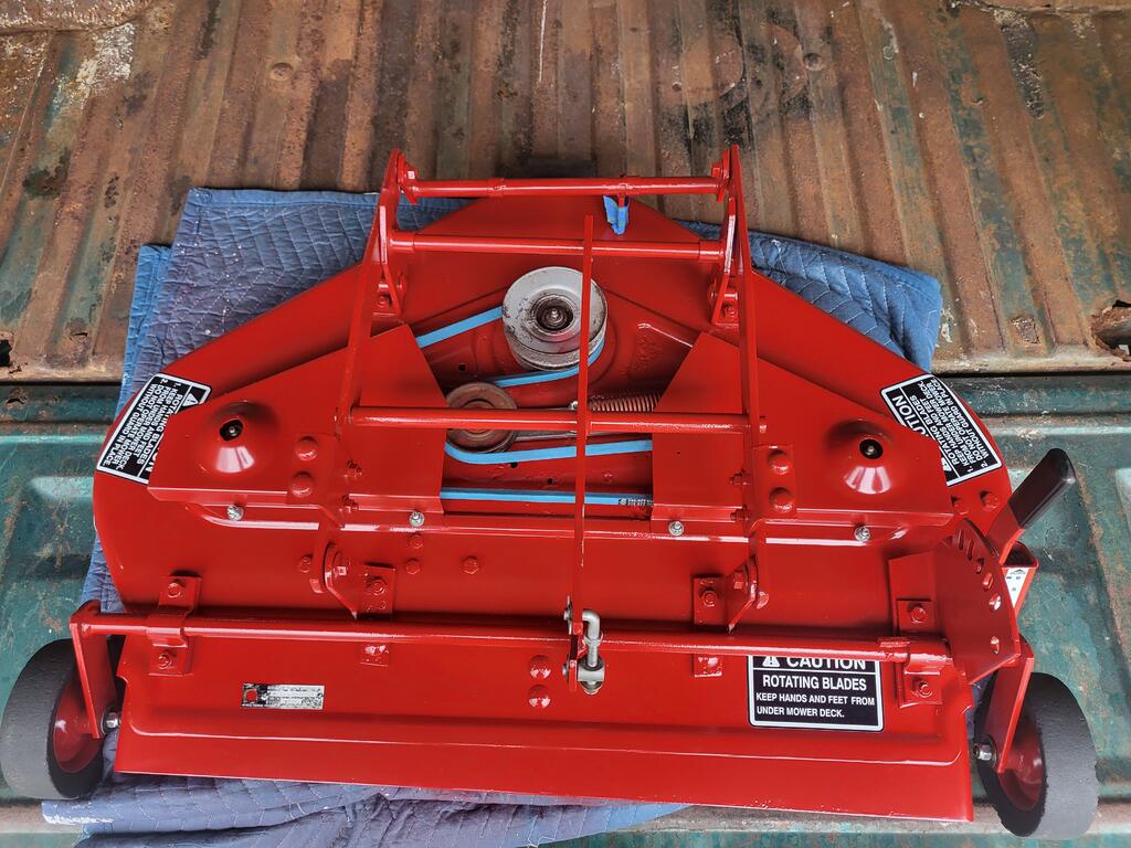

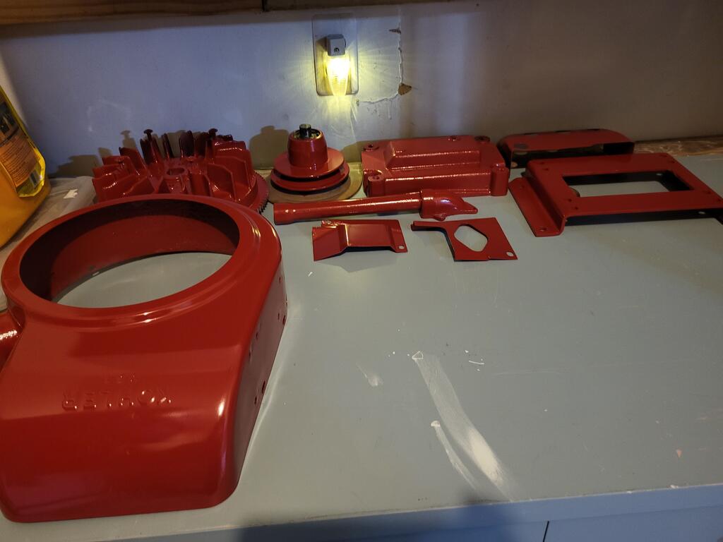

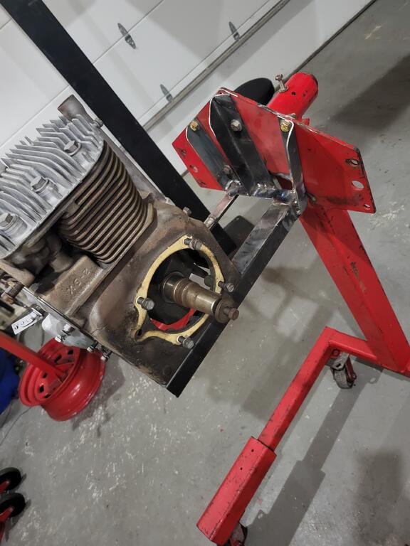

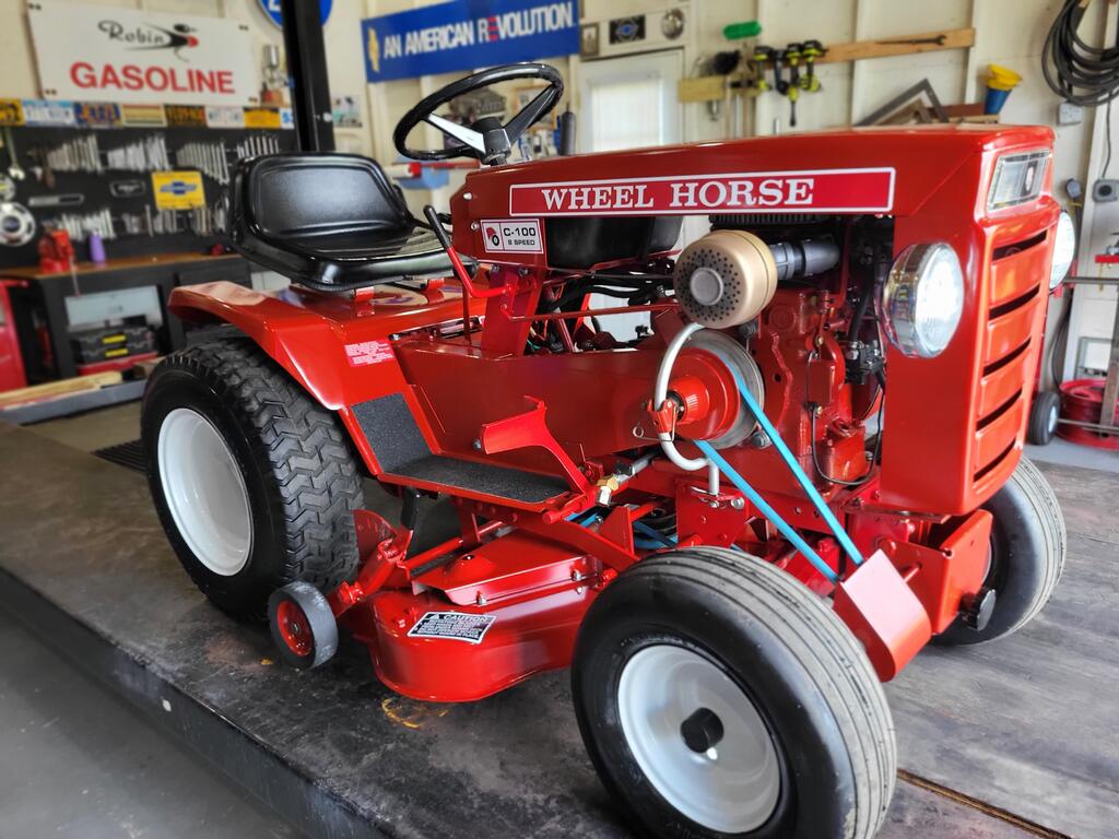

matt monte 232 #1 Posted April 21, 2025 Hello everyone, wanted take 1st take a moment to thank everyone here who helped with my questions and to the vendors who supplied me with the all the items needed to complete this build. This is not a "correct" restoration, more of a "resto-mod" if you will. Its a combination of a B-80,C-125, and a C-100. All were bought for less than a $100 a piece and non were in working order. It literally took all 3 to build one working one for one reason or another. They were all gonna be scrapped, all were MP scores that were left on someone's property outside in the elements 15-20yrs. All same story, owner passed, family left with the cleanup. Had alot of fun, other than the linkage to mower deck,everything was taken apart, media blasted and repainted. I ran outta media the day i was blasting deck. I use a coal slag from TSC. Its hit or miss if they ever have any, guess nobody really uses it, IDK. I built the trailer hitch receiver from a 2nd engine stand i never use. I took pictures of entire build and would be happy to answer any questions. Everything works as it should, however im on the fence if I should push her into normal yard work, I currently have a 312-8,B80,308-8 that are all working that I use regularly. Only issue i have with current build is after i leveled deck, i can only raise it if i lower wheels to lowest setting or deck hits nub from piece that holds deck linkage to bottom of tractor. 12 Share this post Link to post Share on other sites
peter lena 9,785 #6 Posted April 21, 2025 @matt monte amazing work and detail ! you done good ! noticing all the details , finish work , also like your deck restoration . deck belt choice , thank you for the picturol tour , pete 1 Share this post Link to post Share on other sites

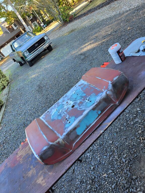

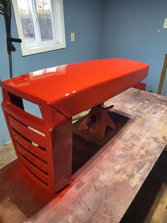

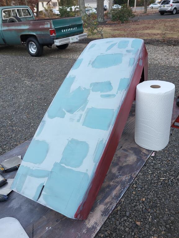

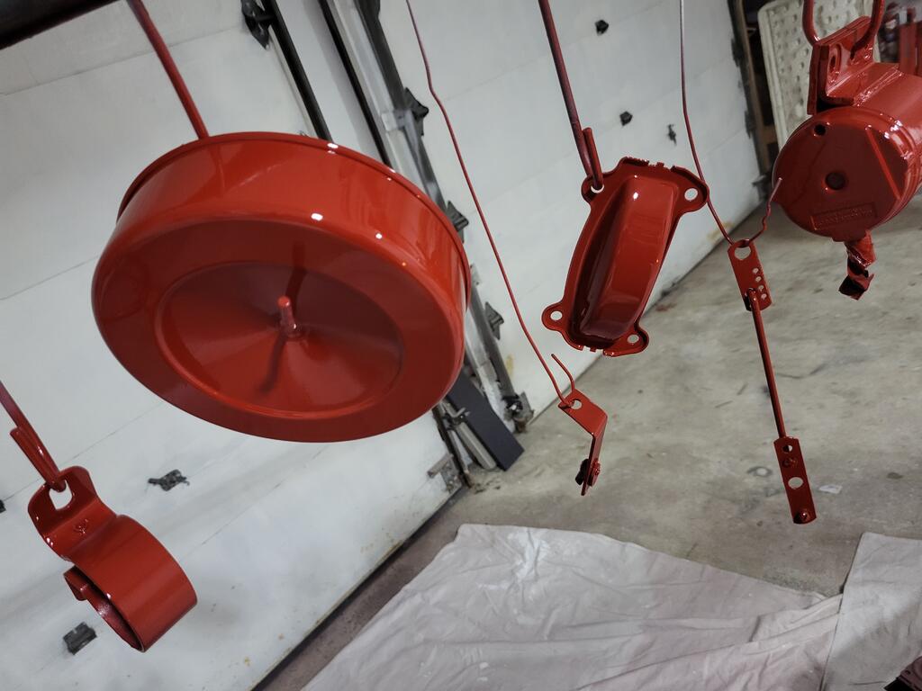

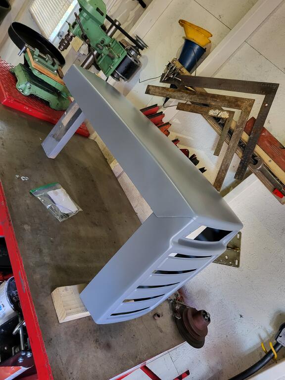

matt monte 232 #15 Posted April 22, 2025 Took about 2yrs, If i was single probably could of banged this out in 6 months,lol. Funny story about paint, i bought that "Majic" from tsc in the gallon size. I dont recommend using this. At the very least do not waste your time with the tech sheet for mixing. I suggest thinning it out way more than it says to. I use a DeVilbiss gun, i forget tip size i used, maybe 1.5. This paint flowed terrible. Had to really thin it and shoot multiple coats to get it to lay out nice. Primer from Summit Racing, epoxy 1st, did my filler then 2k urethane primer. 320,400,600 grit. So i did frame chassis in this. I built a "roller" then did bodywork on the tin, which took awhile. Over a year later i painted some smalls in a spray bomb can, rustoleum regal red. I was rather impressed with this product. Flowed well. Trick is to take your time thru the sanding, not getting lazy stepping down in grit and to have a clean working environment to spray. If you spray in the summer outside you will get bugs and trash. Engines, suspension parts etc ill paint outdoors, also stuff in primer coats, final on body panels inclosed area is a must. I used that regal red in cans to do all tin. Its 2 very different shades. I was very upset when i started final assembly and debated repainting chassis but just left it, whatever man, if anyone ever said anything regarding, id definitely have a few choice words, possibly speak ill of their mother! So in closing regal red rustoluem rattle cans produce a decent end result. The key is prep, do a couple of coats with enough flash time. Most importantly, know when to put the can down or you will get a run! If i ever build another one, id get a gallon of single stage from summit or eastwood. Ivepainted a few cars/trucks with it and got good results. The white for wheels i think some sherman williams i had left over from a tow truck cab i painted awhile back 6 1 Share this post Link to post Share on other sites
Achto 31,161 #16 Posted April 22, 2025 Excellent work !!!!! 7 hours ago, matt monte said: i bought that "Majic" from tsc in the gallon size. I dont recommend using this. Not a fan of this paint either. I was going to suggest Vansickle Performance Ag & Fleet, it's a single stage acrylic enamel. But after checking their web site it looks like they have stopped making it. 1 Share this post Link to post Share on other sites
953 nut 64,358 #17 Posted April 22, 2025 8 hours ago, matt monte said: i bought that "Majic" from tsc in the gallon size. I dont recommend using this. At the very least do not waste your time with the tech sheet for mixing. I suggest thinning it out way more than it says to. I use a DeVilbiss gun, i forget tip size i used, maybe 1.5. This paint flowed terrible. Had to really thin it and shoot multiple coats to get it to lay out nice. Your restoration is outstanding, you done goooood! I have ignored the manufacturer thinning instructions for decades. As you said, the Majic will give you a good finish if thinned to the point where a stir-stick pulled out of the pot stops dripping in less than three seconds, then add the hardener and shoot two light coats within a few minutes of each other. Walk away and don't touch it until the following day. 1 Share this post Link to post Share on other sites
