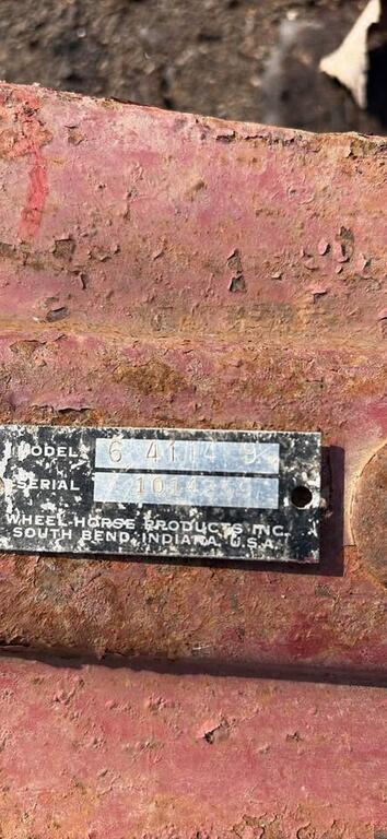

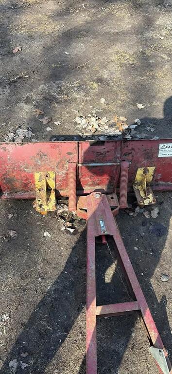

Andy G 8 #1 Posted April 20 The plow blade has the model number 6 4114 9 and I'm trying to figure out (quickly, unfortunately) if it will work on my C-81? Any help is greatly appreciated! Thank you!! Share this post Link to post Share on other sites
wallfish 18,782 #2 Posted April 20 Yes, that blade will attach to that tractor 4 Share this post Link to post Share on other sites
gwest_ca-(File Mod) 11,841 #4 Posted April 20 The 6-4114 is a 1974 model and the A-frame number. At the time the complete blade attachment came in two packages. A 42" and a 56" blade was available for larger tractors. The 42" blade sold at the time was model 6-9624 1 1 Share this post Link to post Share on other sites

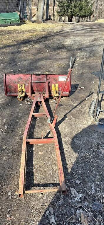

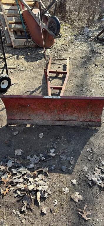

peter lena 9,555 #6 Posted April 20 @Andy G not only will it fit , but you can enhance its function very easily , obviousely total neglect of paint / finish , the STEERING QUADRANT AND RELATED SQUEEZE LEVER AREAS , need a detail servusing , do it up on a couple of milk crates one in back of frame the other just under / behind swing quadrant . get a roller stool , personally would soak down the entire unit with mineral oil / penetrating oil , would also turn over lower plow WEAR STRIP , the squeeze lever slide pin , lubrication is vital for rotation , like a combination of penetrating oil and aerosol red spray grease , can extension nozzle . hitch pin clips on rear of axel , swing levers . done a number of those , the movement swing difference is really amazing , pete 1 Share this post Link to post Share on other sites

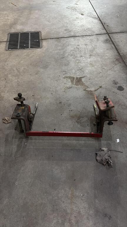

gwest_ca-(File Mod) 11,841 #7 Posted April 20 I don't see the rear axle brackets the A-frame mounts to. Often forgotten when items change ownership. 1 Share this post Link to post Share on other sites
Andy G 8 #8 Posted April 20 50 minutes ago, gwest_ca said: I don't see the rear axle brackets the A-frame mounts to. Often forgotten when items change ownership. Thank you! I’ll be sure to ask the seller if he’s got those… sure hope he does! Share this post Link to post Share on other sites
Andy G 8 #9 Posted April 20 1 hour ago, gwest_ca said: I don't see the rear axle brackets the A-frame mounts to. Often forgotten when items change ownership. This is the correct bracket, right? Looks like it’s missing an “L” but that should be easily replaceable. 1 Share this post Link to post Share on other sites
wallfish 18,782 #10 Posted April 20 1 minute ago, Andy G said: This is the correct bracket, right? Yes, that'll do it. 1 Share this post Link to post Share on other sites
peter lena 9,555 #11 Posted April 20 @Andy G on the rear axel hitch , note the lever swing area , there are small 1/8 holes in the lower push down to close , side area , get a couple of HITCH PIN CLIPS , to run thru the holes , push the clips all the way thru , so they are in the last big hole area . ? the last hole will insure that they will not fall out , lubricate as you go so things work easily / stop rust , have them on my 3 units , pete 1 1 Share this post Link to post Share on other sites

peter lena 9,555 #14 Posted August 6 @Andy G found it ! related swing movement points , that I have on my plows . basically ensuring a smooth swing movement spot and securing that with an elastic lock nut , also added heim joints to related movement swing areas , shoulder bolts built the entire set up on milk crates , roller stool around it , verifying . all function . hitch pin clips on rear frame swing levers , pushed in to last large hole ? they will NOT FALL OFF ! done a number of attachment GOLD MINE TROUBLE SPOTS , repetitive failure lets you dial right in to trouble spot , related areas , PTO lever start , mule drive detailing , heim joint on pto lever shaft . been bombproof for years now . plow frame , front eye hook , lift spring assist . looking right at you , pete Share this post Link to post Share on other sites
