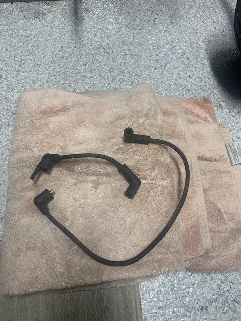

Thetbone 61 #1 Posted April 19 Needing to find 2 new ones, been to NAPA, Farm Fleet, Tractor Supply. Thanks. Share this post Link to post Share on other sites
squonk 44,860 #2 Posted April 19 Saw you other post. I can make those. Measure the length of both. 1 Share this post Link to post Share on other sites

squonk 44,860 #4 Posted April 19 (edited) 5 minutes ago, WHX?? said: Golly Geez all three of those places shoulda had them. I buy the kits and cut to order. I have multiple tractors ... https://www.farmandfleet.com/products/620790-tisco-4-cylinder-spark-plug-wire-set.html The guys there probably didn't think of a universal set because the computer "didn't list it" The 90° coil end can be tricky to find. I think a lot of the universal sets had straight distributor cap ends that don't fit on all of the coils. I have the proper round 90° coil connectors. Edited April 19 by squonk Share this post Link to post Share on other sites

squonk 44,860 #6 Posted April 21 39 minutes ago, Thetbone said: Sorry for my lack of knowledge on this, yes I can get the 4 cylinder wires as shown in the link, but will those work with 1993 technology? You can use the 4 cylinder set but it will have straight coil terminal ends instead of the 90 ° ones. Also you have to crimp one end. it can be tricky without the propeer crimping tool. Share this post Link to post Share on other sites
