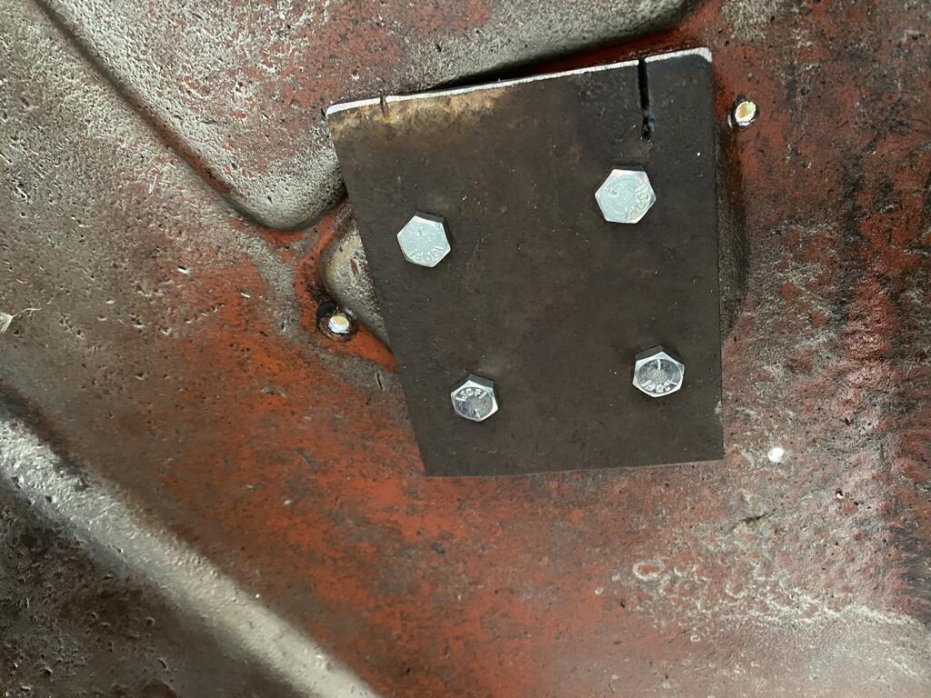

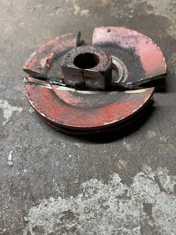

JimSraj 583 #8 Posted May 14, 2025 (edited) Finally got to the deck today. Center pulley and one outer pulley came right off. But, as you probably know, there always has to be one that doesn’t cooperate. The second out pulley is really stuck. Been soaking with Kroil. Tried heating it up a little. Didn’t want to damage the bearing so quit that once grease came out of the hole where the zerk threads in. Tried a puller on it and bent the pulley. Any suggestions? On a better note, the tool I made to bend the deck at the spindle mounting area seems to have worked well. 4’ ‘cheater pipe’ slid over the bar allowed me to move the deck metal without beating on it. I’ve ordered a new pulley from 8Ten. Hope it’s decent quality. Any and all recommendations for getting that pulley off the spindle shaft will be greatly appreciated. Here’s a photo of the tool I used to bend the deck. It’s 1/4” plate and solid rod. I didn’t have any 1” rod so I slid a short piece of conduit over the 5/8” rod to fill most of the inside of the 1” cheater pipe I used as a ‘handle’. Edited May 14, 2025 by JimSraj 1 Share this post Link to post Share on other sites
JimSraj 583 #9 Posted May 14, 2025 On 4/19/2025 at 10:32 AM, oliver2-44 said: if you find the deck mount area cracked Wheel Horse used to sell a weld in repair blank. A local shop or Lowel at Wheel Horse Parts and more can probable make you one. Do you know what gauge these were made from and were they welded over the existing deck metal? Share this post Link to post Share on other sites

oliver2-44 11,611 #11 Posted May 14, 2025 (edited) 9 hours ago, JimSraj said: Any and all recommendations for getting that pulley off the spindle shaft will be greatly appreciated. Since the pulley is toast, cut it off with a grinder. Be extra careful not to damage the spindle. I don't like to do a single slit as I always damage a shaft doing that. Try something like this. Cut roughly 1/2 of the pulley off leaving the collar on the shaft. Then flat grind the collar to where just a thin amount of metal remains Hit the remaining side of the pulley to stretch the thin metal and break the pulley free. Edited May 14, 2025 by oliver2-44 1 Share this post Link to post Share on other sites
oliver2-44 11,611 #12 Posted May 14, 2025 (edited) 9 hours ago, JimSraj said: Do you know what gauge these were made from and were they welded over the existing deck metal? Sorry I don't know the thickness. Yes they were intended to weld over the existing metal This vendor on EBay has reasonable priced round blanks. (this is just an example, I don't know exact size needed. He will also do custom sizes and hole layouts. https://www.ebay.com/itm/192266491194?_skw=3%2F16+steel+plate+%2C+6"+diameter&itmmeta=01JV7D1EHJVB64A976SPTATCZ1&hash=item2cc3f9d53a:g:GbQAAOSwDNdVgjX8 Edited May 14, 2025 by oliver2-44 Share this post Link to post Share on other sites
JimSraj 583 #13 Posted May 14, 2025 10 hours ago, oliver2-44 said: Since the pulley is toast, cut it off with a grinder. Be extra careful not to damage the spindle. I don't like to do a single slit as I always damage a shaft doing that. Try something like this. Cut roughly 1/2 of the pulley off leaving the collar on the shaft. Then flat grind the collar to where just a thin amount of metal remains Hit the remaining side of the pulley to stretch the thin metal and break the pulley free. It fought me all the way but I won in the end! I think the heat from the cutting wheel helped. Another dousing of Kroil and some back and forth with a vice grip locked on the collar started to get some slight movement that led to it giving up. Thanks for the tip Jim. 1 1 Share this post Link to post Share on other sites
