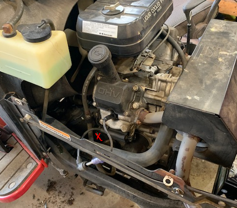

Fordiesel69 271 #1 Posted April 17 Almost like a timer, about 30 minutes of run time, engine stalls like it is running out of fuel. You can delay the issue by adding choke but it will still stall out. If you let it sit, you can get another 3-5 minutes out of it. When this is happening, there is still 12v at the fuel solenoid, and the solenoid is still clicking when manually connected and disconnected. I cannot find any fuel pump to test (I must be blind) as the tank is lower than the engine. Any ideas how to troubleshoot. I do not want to explore ignition coils and pickups just yet as this issue is seemingly a fuel issue. Also I confirmed the engine is not running hot or overheating. Radiator and hoses are at proper temps. Share this post Link to post Share on other sites

JoeM 8,888 #4 Posted April 17 (edited) Electric fuel pump is on the base plate near the bottom of the radiator on the left side. You can see it from the right side if the side cover is off. I have also seen the port on the tank clogged up. might want to blow air back through the fuel hose??? Edited April 17 by JoeM Share this post Link to post Share on other sites
Fordiesel69 271 #5 Posted April 18 Joe thank you for that info. It was the tank petcock. 1 Share this post Link to post Share on other sites
