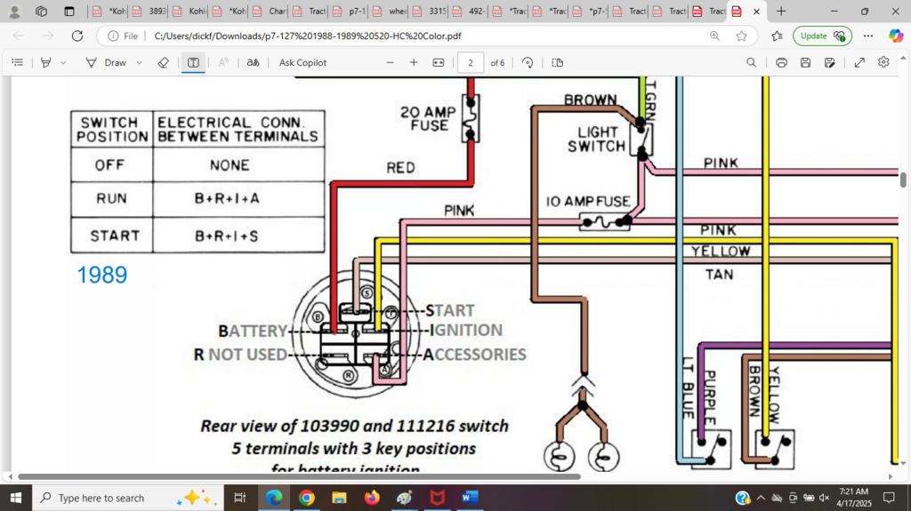

953 nut 62,989 #4 Posted April 17 I will take a wild guess that you are asking about the ignition switch on a 520-H. The wiring on various years of production of the 520-H saw some changes but the ignition switch and its wiring remained the same. If this is what you are working on the drawing below should head you in the correct direction. If you have further questions please feel free to ask us. 1 Share this post Link to post Share on other sites

WHX?? 53,294 #7 Posted April 17 2 hours ago, wallfish said: such vague information given. Would really help us help you if we knew the year/model of the tractor we are working on. Often times wire color means nothing as things changed over the years and PO changes. For example replacement switch pigtails colors will not correspond to tractor wiring colors. One must then wire according to wire & switch functions rather than color. 2 Share this post Link to post Share on other sites
