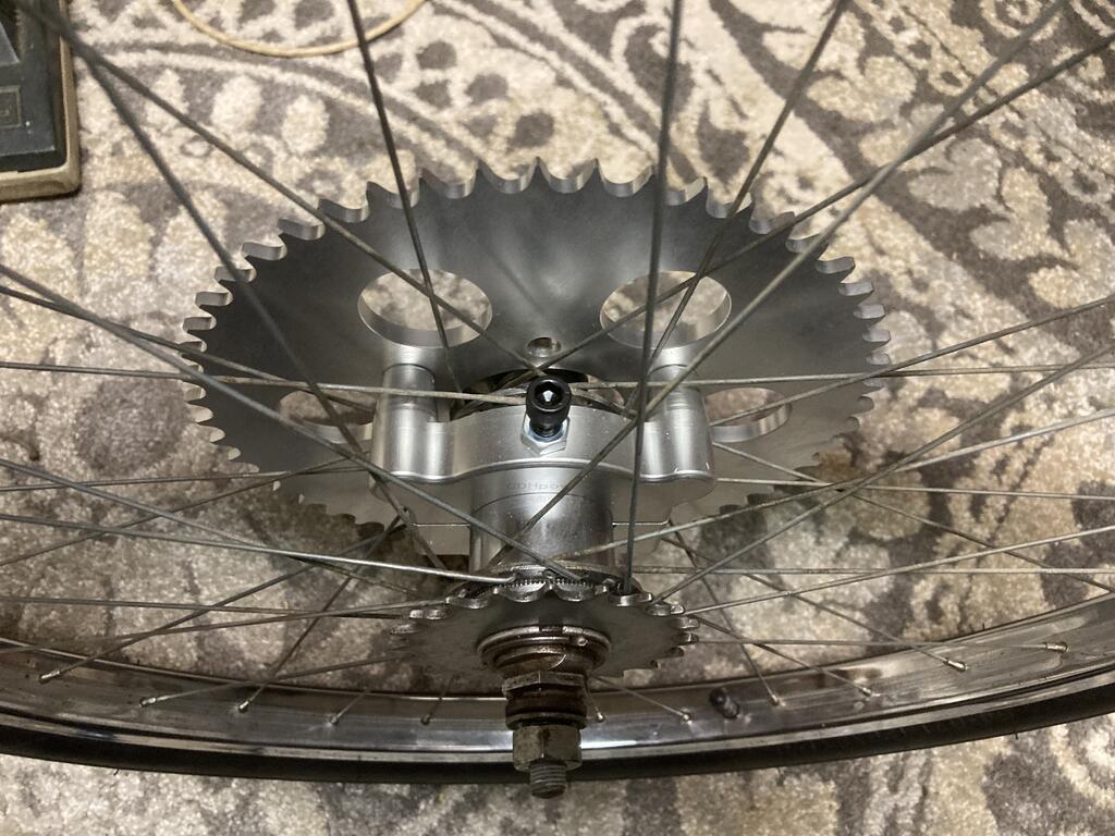

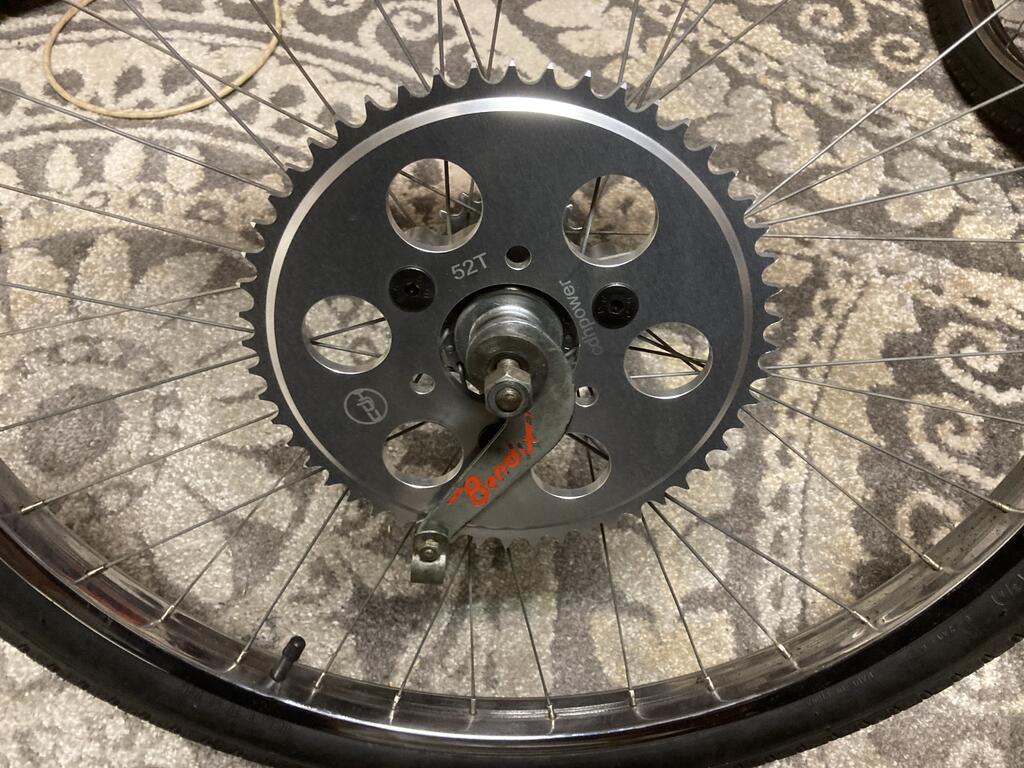

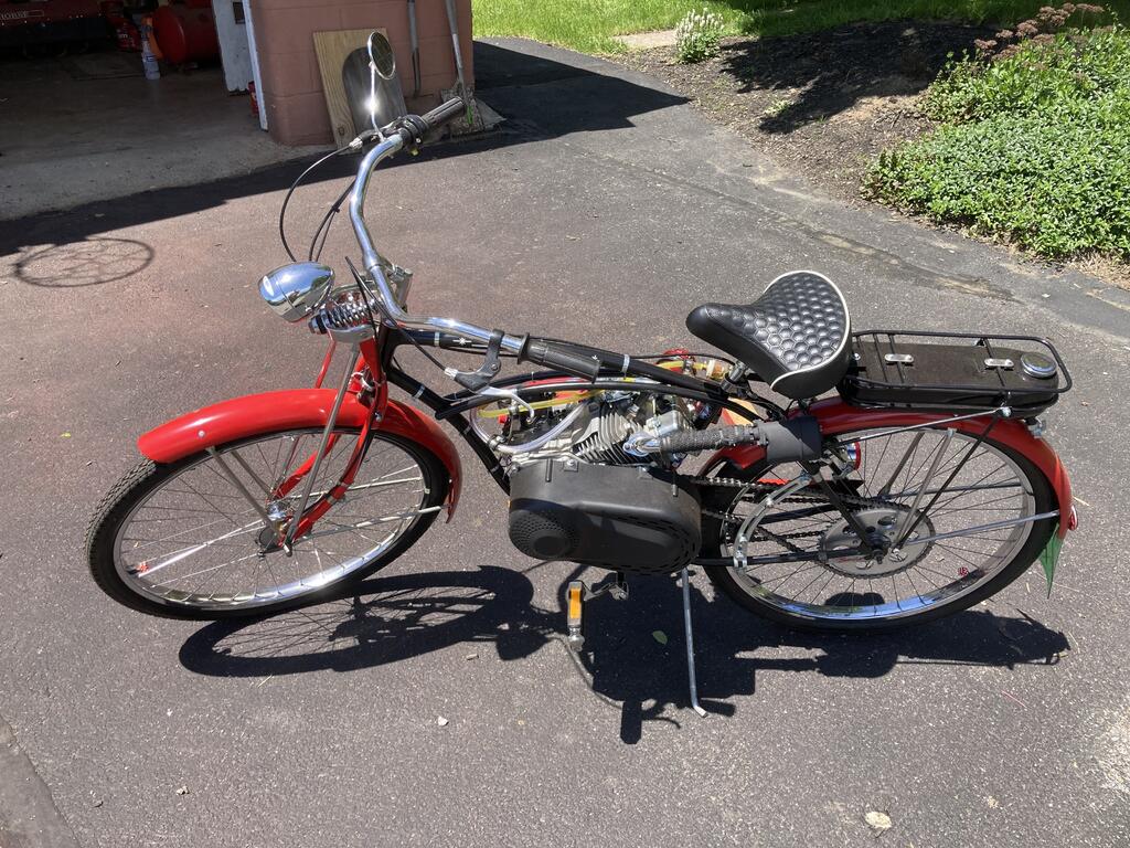

wallfish 20,158 #26 Posted April 13, 2025 The belt in that torque converter should wear a little and the sides will glaze which should help to make take off a little smoother from some belt slippage in the beginning. Maybe check around to see if you can find some different tension springs for the front variable pulley to engage at a higher RPM ???? Larger rear sprocket 1 Share this post Link to post Share on other sites
"Manic-Mechanic" 1,485 #27 Posted April 13, 2025 19 minutes ago, wallfish said: The belt in that torque converter should wear a little and the sides will glaze which should help to make take off a little smoother from some belt slippage in the beginning. Maybe check around to see if you can find some different tension springs for the front variable pulley to engage at a higher RPM ???? Larger rear sprocket The sprocket is an easy switch standard 3-bolt pattern. Was also considering upgrading the rear spokes anyways as per Handy Don suggestion. The springs, now that not sure of, have to get a picture to you of the innards, not like the one’s I’m familiar with, seems cheaply made compared to the 40’s. Originally made for the death row kit Share this post Link to post Share on other sites

gt14rider 1,223 #31 Posted April 14, 2025 Nice job, that looks like a hand full. How is the rear sprocket attached to the wheel? Mounted to the hub or the spokes. Remember no suspicion. I built one for a friend, had a 49cc motor, made it look like a old messenger bike. Seemed a little under powered. Looks like you got that handled. Nice job keep it shiny side up. 1 2 Share this post Link to post Share on other sites
"Manic-Mechanic" 1,485 #32 Posted April 14, 2025 (edited) 2 hours ago, gt14rider said: Nice job, that looks like a hand full. How is the rear sprocket attached to the wheel? Mounted to the hub or the spokes. Remember no suspicion. I built one for a friend, had a 49cc motor, made it look like a old messenger bike. Seemed a little under powered. Looks like you got that handled. Nice job keep it shiny side up. They can be a handful! The hub adapter sized to 1.6 to mate with the Schwinn S7 single speed wheel. That leaves about 6 thousands of clamp space. nice job on the messenger, color is dead on! 49cc, 79cc? I may find another set of drive springs for the CVT Transmission, engage at higher rpm. Tell, ya tho’, you think everything is tight, but needs to be “good & tight!” Edited April 14, 2025 by "Manic-Mechanic" Share this post Link to post Share on other sites
"Manic-Mechanic" 1,485 #33 Posted April 14, 2025 1950’s Schwinn Tiger 212cc Ducar (open exhaust walk around) 1 Share this post Link to post Share on other sites

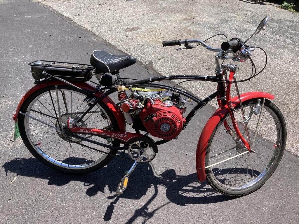

"Manic-Mechanic" 1,485 #34 Posted August 15, 2025 Tiger Update 2 3 Share this post Link to post Share on other sites
peter lena 9,934 #35 Posted August 15, 2025 @Manicmacanic agree with the steel fuel line , 5/16 - 3/8 , easy to bend up with a hand bender in a vise . go over to stainless flex on the end hook up . pete 1 Share this post Link to post Share on other sites
