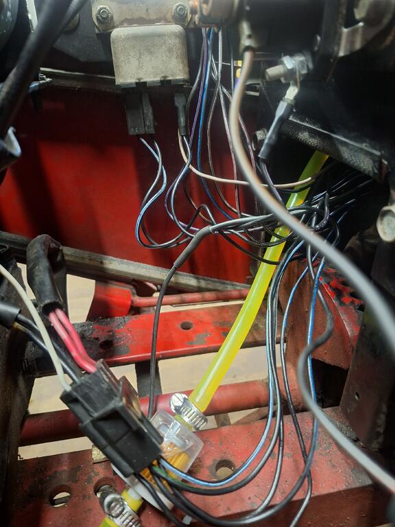

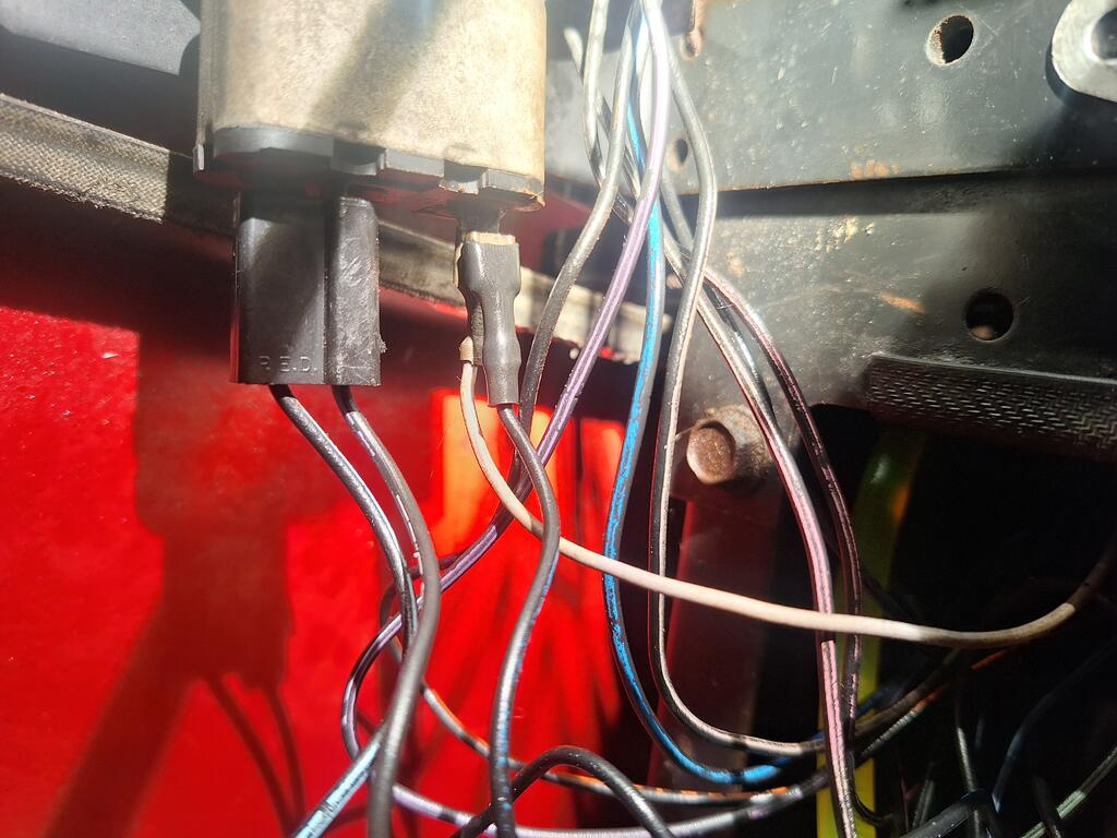

Bselectro12 0 #1 Posted April 8 Can anyone please tell me if this looks right with two wires sharing one terminal on the oil relay? The white wire goes to the oil test switch and the blue wire is going to the engine plug. Thank you Share this post Link to post Share on other sites
gwest_ca-(File Mod) 11,545 #2 Posted April 8 The wiring diagram shows 2 dark blue wires on one terminal One going to the low oil switch in the bottom of the engine One going to the oil light test switch 1 Share this post Link to post Share on other sites
