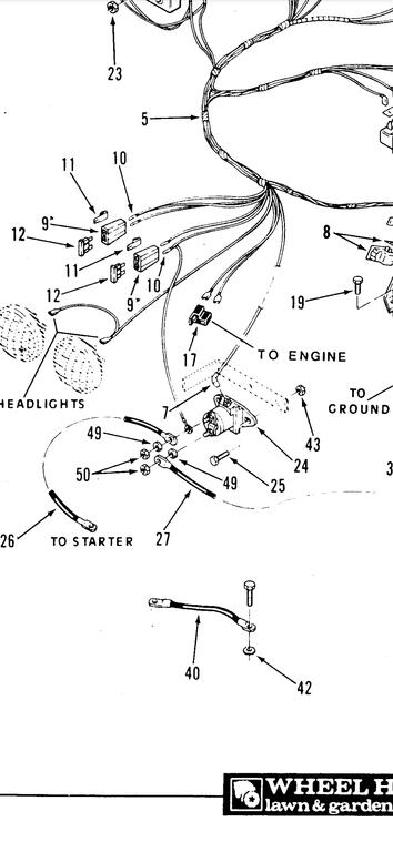

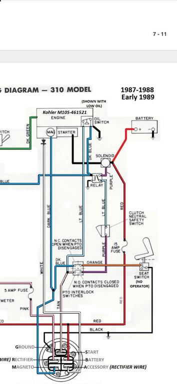

Bselectro12 0 #1 Posted April 7, 2025 (edited) I'm trying to figure out what solinoid post to put the 15a fuse to. One schematic says post to starter and one says post to battery. When I got the tractor the wiring was disconnected. Thank you Edited April 7, 2025 by Bselectro12 Share this post Link to post Share on other sites
cleat 8,828 #2 Posted April 7, 2025 To the battery cable. 2 Share this post Link to post Share on other sites
953 nut 64,636 #3 Posted April 7, 2025 The fuse is intended to protect the wiring from a short to ground. Place the fuse between the battery side of the solenoid and the ignition switch and everything in the wiring system will be protected. 1 Share this post Link to post Share on other sites
