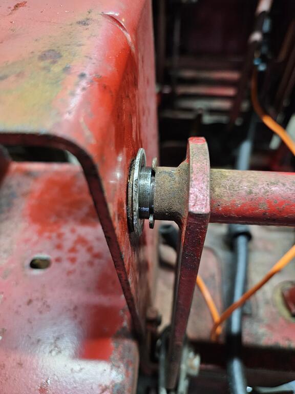

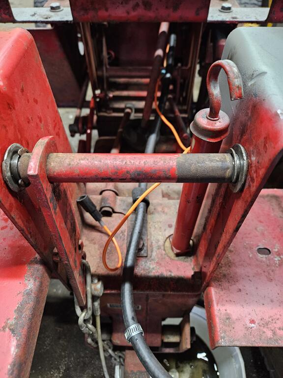

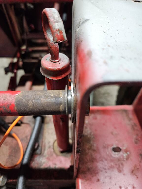

Mike'sHorseBarn 3,417 #1 Posted April 5, 2025 I'm putting in this rockshaft and it seems sloppy. Is it supposed to be that way or are my Fender posts bent? Share this post Link to post Share on other sites
Blasterdad 3,163 #2 Posted April 6, 2025 46 minutes ago, Mike'sHorseBarn said: are my Fender posts bent? I'd say yes, mine has hardly any play. Share this post Link to post Share on other sites
Blasterdad 3,163 #3 Posted April 6, 2025 Might be the camera angle but it looks like the left side is bent out... Share this post Link to post Share on other sites
oliver2-44 11,211 #4 Posted April 6, 2025 (edited) When you install the fender, aligning the bolts holes should draw it together. Edited April 6, 2025 by oliver2-44 3 1 Share this post Link to post Share on other sites
Mike'sHorseBarn 3,417 #5 Posted April 6, 2025 4 minutes ago, Blasterdad said: Might be the camera angle but it looks like the left side is bent out... I was wondering if that would help too. 3 minutes ago, oliver2-44 said: When you install the fender, aligning the bolts holes should draw it together. Kinda looks like that to me too in person Share this post Link to post Share on other sites
Blasterdad 3,163 #6 Posted April 6, 2025 I'd try to straiten the one side , use the fender pan as a template. Less likely to want to pull the other side toward it & have to fight threading the bolts in. Share this post Link to post Share on other sites
JimSraj 565 #7 Posted April 6, 2025 Can you measure the distance between right on top of the trans and compare at the rock shaft? Share this post Link to post Share on other sites
kpinnc 17,120 #8 Posted April 6, 2025 1 hour ago, oliver2-44 said: When you install the fender, aligning the bolts holes should draw it together. 1 Share this post Link to post Share on other sites
Lee1977 7,551 #9 Posted April 6, 2025 If you have the plastic fender, you will have better luck holding it together switching to the metal fender. Share this post Link to post Share on other sites
