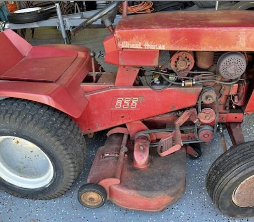

rmaynard 17,582 #27 Posted March 29, 2025 (edited) The transmission drain plug is on the bottom just to the left of the hitch. Best to lift the front end of the tractor at least 12 inches to help get the transmission oil over the hump in the bottom. The engine should have a drain plug on the back of the pan or on the side. Some have an elbow with a pipe attached to help in ease of draining. Transmission oil is filled through the shifter hole, however you can add it through the angled plug on the left side. It holds 1-1/2 quarts, so you may have to tip the tractor to the right to get all the oil in. Engine oil is filled through the dipstick hole on the top of the crankcase. Edited March 30, 2025 by rmaynard Spelling 1 Share this post Link to post Share on other sites

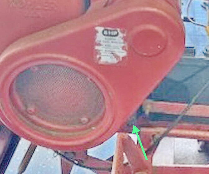

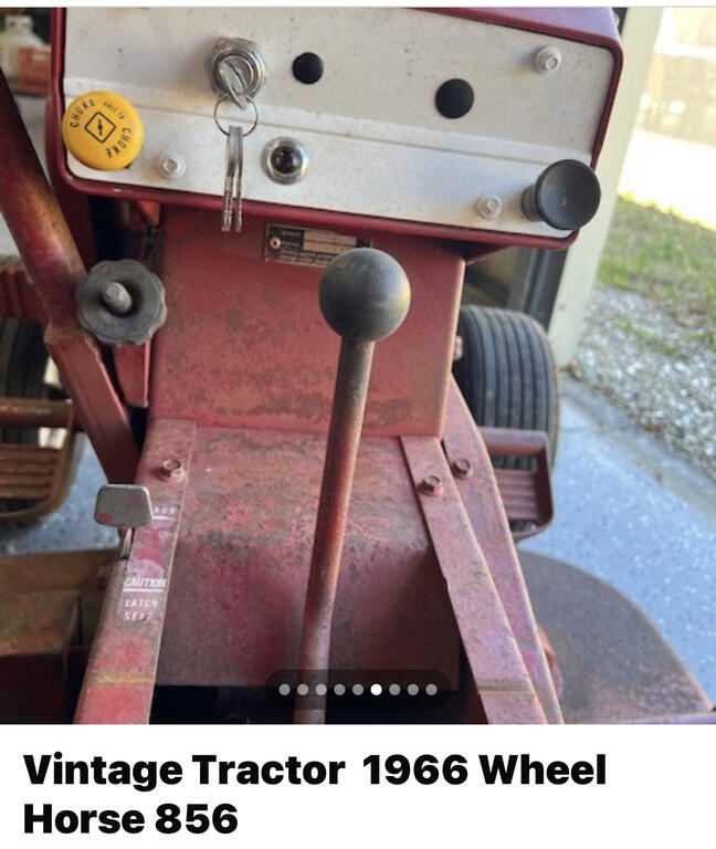

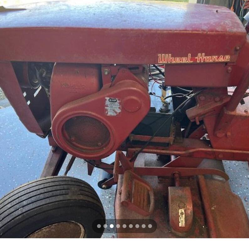

adsm08 5,149 #28 Posted March 29, 2025 Oil drains from the left side of the tractor. There is a pipe with a plug just in front of the battery. I can see it in the one picture you posted, but can't save the picture to draw on it. Shifter should be like this: https://www.redoyourhorse.com/wheel-horse-brushed-aluminum-shift-pattern-decals/ To check charging hook a volt meter to the battery and start the engine. Ideally it should charge around 13.5, may take a minute to settle. If it charges at 13 or higher I'd be happy, although that can indicate the S/G unit is worn. 1 Share this post Link to post Share on other sites
rmaynard 17,582 #29 Posted March 29, 2025 25 minutes ago, adsm08 said: Oil drains from the left side of the tractor. There is a pipe with a plug just in front of the battery. I can see it in the one picture you posted, but can't save the picture to draw on it. Here it is: 2 Share this post Link to post Share on other sites

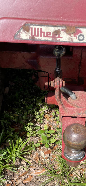

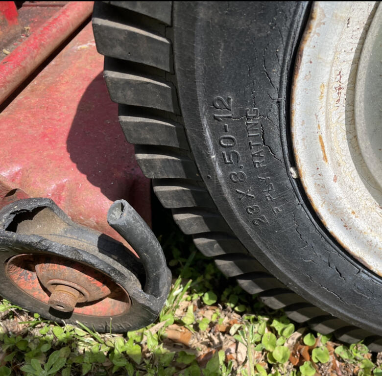

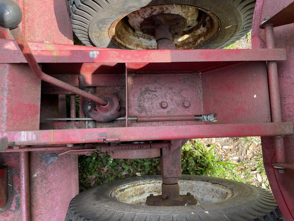

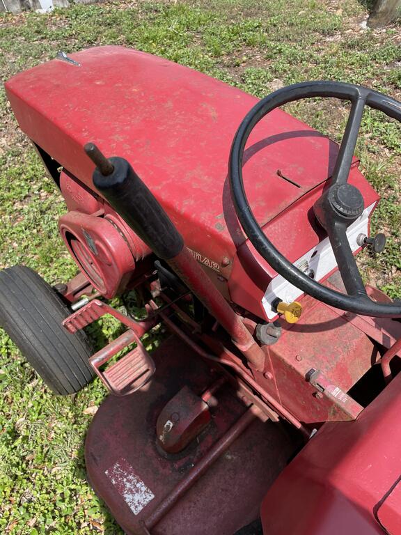

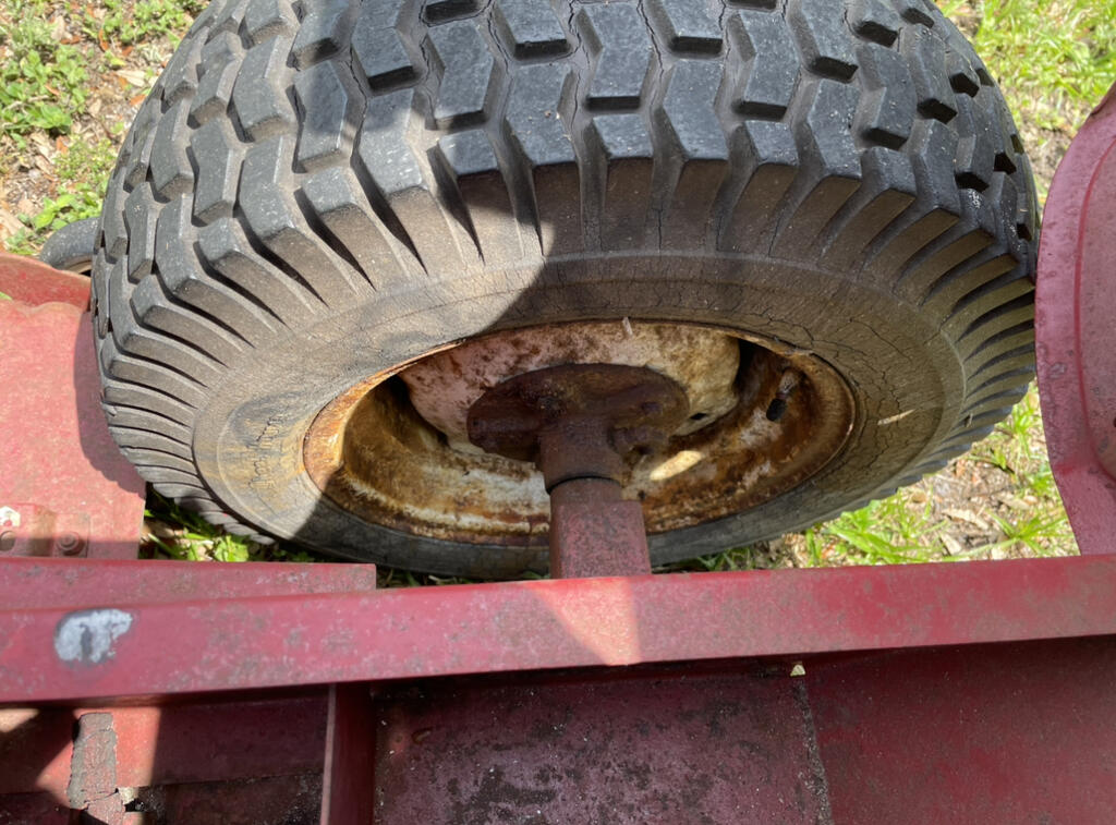

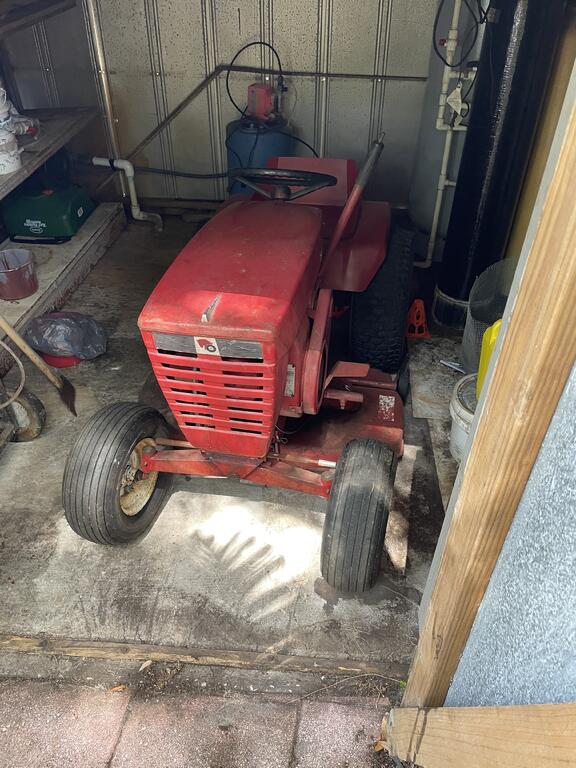

FLtractor 229 #37 Posted April 1, 2025 (edited) 5 hours ago, oliver2-44 said: @FLtractor You've got us hanging on the edge of our seats. It's been 5 long days! What's the conclusion to this Cliff Hanger? Did you bring it home??????????????? or was it a poor condition bust? Got the tractor home. Need to get new shifter boot, flush oil and transmission fluid. figure out what I’m gonna do about the rear tires, being cracked as they are, water fluid filled, Orginal wheel horse tires. Any idea what those would cost new for new wheels and tires? Advisable drive on them until they quite literally fall to pieces under the tractor? Edited April 1, 2025 by FLtractor 1 Share this post Link to post Share on other sites
FLtractor 229 #38 Posted April 1, 2025 Needs new deck wheels but gonna remove deck to two with. After I figure out how to 1 Share this post Link to post Share on other sites

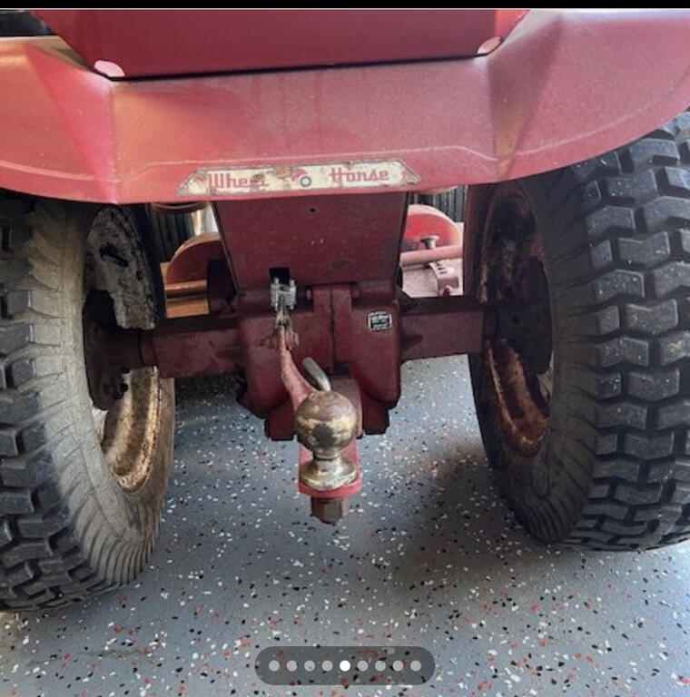

pfrederi 21,151 #39 Posted April 1, 2025 Probably not just water Calcium Chloride There should be a special place in Hell for people who put Calcium Chloride in tires...That maybe why there is so much rust on your wheels. Getting tires of wheels that have been filled can be a really fun experience then turn out to be he wheel is toast. I might run it till they fall apart, mean time save up for good used rims and new rubber... 1 1 Share this post Link to post Share on other sites
D_Mac 9,339 #40 Posted April 1, 2025 (edited) Congratulations on your purchase. I never had fluid filled tires but it better not be just water in there. Water freezes. It's always good to start with fresh fluids in the engine and tranny. You can also pick up the little plastic knob for the hood release. That will make it easier to open and close the hood. Lubricate the throttle and choke cables if they are a little sticky as well. Then grease all the zerk fittings. After I wash all mine I rub them down with boiled linseed oil. That thing will shine right up. Drive it around and have some fun with it. Congrats ! Edited April 1, 2025 by D_Mac 1 Share this post Link to post Share on other sites
FLtractor 229 #41 Posted April 1, 2025 1 hour ago, pfrederi said: Probably not just water Calcium Chloride There should be a special place in Hell for people who put Calcium Chloride in tires...That maybe why there is so much rust on your wheels. Getting tires of wheels that have been filled can be a really fun experience then turn out to be he wheel is toast. I might run it till they fall apart, mean time save up for good used rims and new rubber... What can i expect to pay for new 23x8.50x12 turf tires with wheels x2 these days?? Any places recommend to purchase from? Share this post Link to post Share on other sites
FLtractor 229 #42 Posted April 1, 2025 33 minutes ago, D_Mac said: Congratulations on your purchase. I never had fluid filled tires but it better not be just water in there. Water freezes. It's always good to start with fresh fluids in the engine and tranny. You can also pick up the little plastic knob for the hood release. That will make it easier to open and close the hood. Lubricate the throttle and choke cables if they are a little sticky as well. Then grease all the zerk fittings. After I wash all mine I rub them down with boiled linseed oil. That thing will shine right up. Drive it around and have some fun with it. Congrats ! Happen to have a diagram showing where all the zerk fittings are or where they’re located? Can I wash it with zipwax? Share this post Link to post Share on other sites
Ed Kennell 47,373 #43 Posted April 1, 2025 17 minutes ago, FLtractor said: What can i expect to pay for new 23x8.50x12 turf tires with wheels x2 these days?? Any places recommend to purchase from? Come to the Big Show in June and I'll sell you a mounted pair for $40. 1 Share this post Link to post Share on other sites
