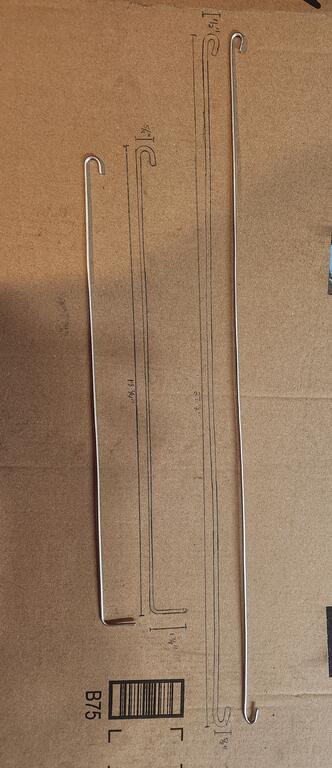

Goldnboy 1,081 #1 Posted March 23, 2025 (edited) I see a lot of discussion about the handle index wire length but very little about the lower wire to the angle lock pin. I am currently doing a refreshing of a 42" blade and thought I would share these dimensions... Handle index 27 1/2" long 1/2" hook and 5/8" hook > part #104341 Lower index 18 3/4" long 5/8" hook and 1 3/8" " L" end > part # 3771 Sticky maybe? Edited March 23, 2025 by Goldnboy Added part #'s 4 3 Share this post Link to post Share on other sites
