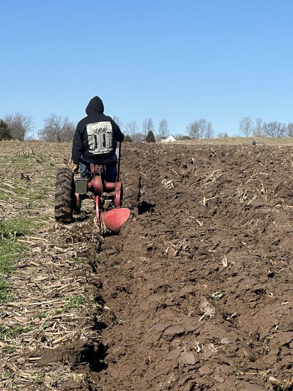

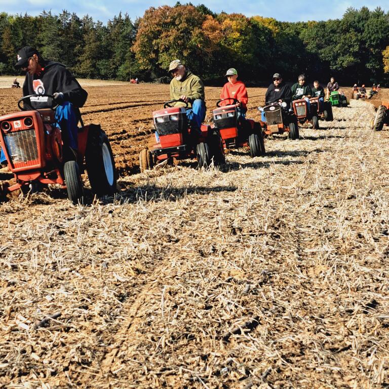

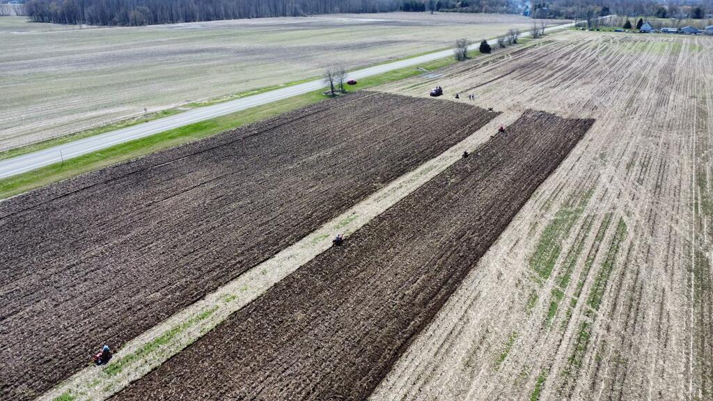

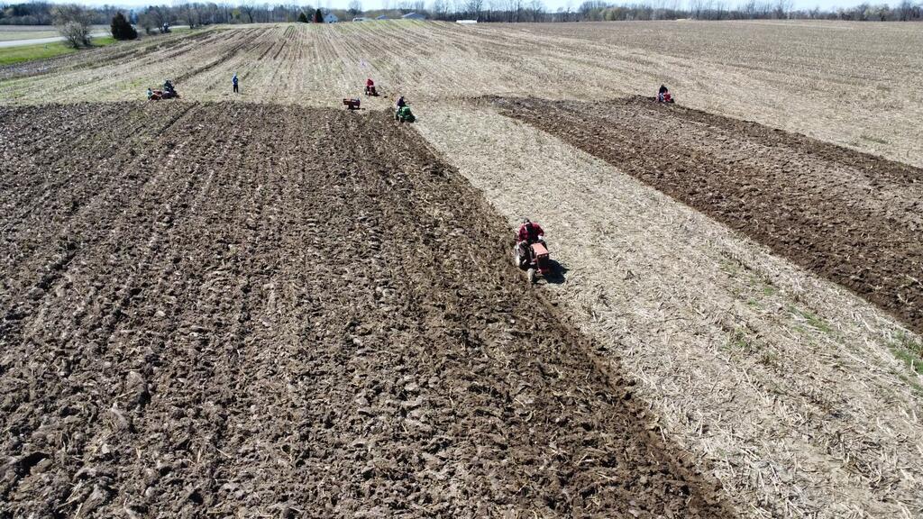

WHX?? 52,846 #7 Posted March 21 (edited) If you mean field ploughing there is plenty of that action here! Edited March 21 by WHX?? 1 3 Share this post Link to post Share on other sites
