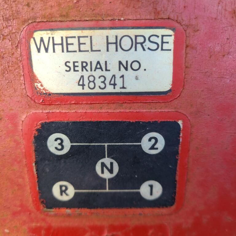

parsonsponyz 259 #1 Posted March 17 I rescued another Horse this weekend and am attempting to identify. I think it's a 701 but want to make sure. The serial number fits in the 701 range but I'm no expert. Share this post Link to post Share on other sites
rmaynard 16,642 #2 Posted March 18 (edited) please. 701 has double pulley on flywheel, and a double wide s/g belt cover. Has a hood with no vents in front. Rear fenders have support brackets that come up at 45 degree angle from seat spring. Edited March 18 by rmaynard 2 1 Share this post Link to post Share on other sites
ri702bill 10,271 #3 Posted March 18 Also, there is no indent for the model ID on the belt guard. Rear fender ends are "pointed", there is no parking brake or sheet metal guard. All those changed in 1962. 1 Share this post Link to post Share on other sites

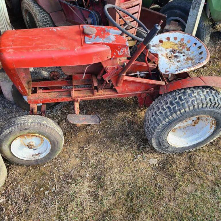

parsonsponyz 259 #4 Posted March 18 Well, it was a rescue so it's not all there and I definitely don't need another Horse but to save it from scrap and for the price it had to gallop home with me. Here's a quick pic I took of it. 5 1 Share this post Link to post Share on other sites
rmaynard 16,642 #5 Posted March 18 Looks like it was a 701. 1 Share this post Link to post Share on other sites
Blasterdad 3,045 #6 Posted March 18 Look like it's in pretty good shape! 1 Share this post Link to post Share on other sites
Racinbob 12,292 #7 Posted March 18 No doubt it's a 701 and a very nice example. Apparently the lift quadrant was upgraded somewhere's along the way. 1 Share this post Link to post Share on other sites
ri702bill 10,271 #8 Posted March 18 (edited) 51 minutes ago, rmaynard said: Looks like it was a 701. The RJ style steering wheel says yes, but it looks like a later 2 piece gas tank..... the slifter would have been a straight one, and yes, it has a 1963 or later adjustable quadrant... Edited March 18 by ri702bill 1 Share this post Link to post Share on other sites
