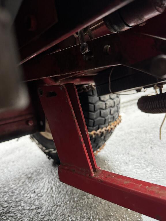

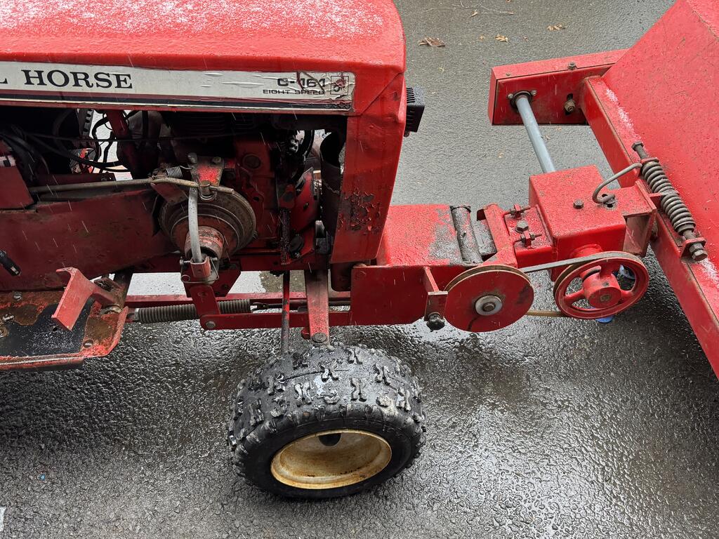

Mareik 4 #1 Posted March 12, 2025 Hi, i recently got a power broom for my wheel horse and I have some questions. Is a belt tension adjustment missing? See photo And is it only to drill a hole in the lifting mechanism and put a bolt and a nut? See photo Share this post Link to post Share on other sites
Blasterdad 3,168 #2 Posted March 12, 2025 4 hours ago, Mareik said: Hi, i recently got a power broom for my wheel horse and I have some questions. Is a belt tension adjustment missing? See photo And is it only to drill a hole in the lifting mechanism and put a bolt and a nut? See photo Yes the tensioner is missing, part #78 on the IPL. The lift rod should bolt to the rock shaft higher up, like a snowblower. Figure 21 & 22. 1 Share this post Link to post Share on other sites
