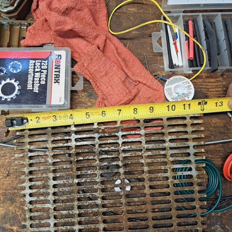

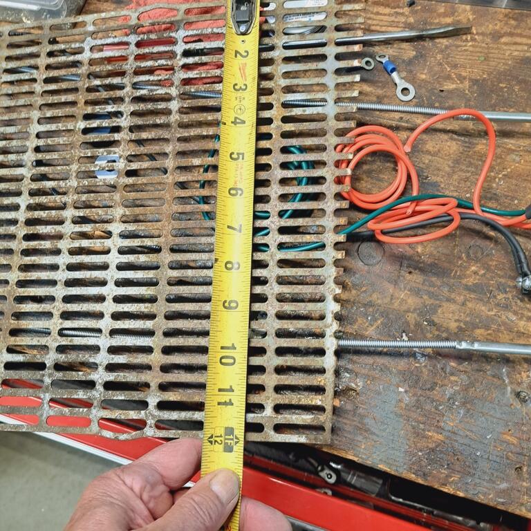

Achto 30,941 #8 Posted March 12, 2025 (edited) @Tonytoro416, Here is what I worked with. A couple of text from Jim. Edited March 12, 2025 by Achto 2 Share this post Link to post Share on other sites
