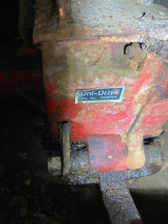

Gilou15 42 #1 Posted March 3 Hello Here is the photo of my transmission number Someone can tell me more about it ... Axle shafts are 1"1/8 ..... Do you know the type of final pignon and diff.. What is the différence between it and 103916 eight speed ? Stronger or not ? Share this post Link to post Share on other sites
gwest_ca-(File Mod) 11,832 #2 Posted March 3 That is the patent number that was on all the Uni-drive transmissions. From the information we have the 512-D had 1" axles using transmission model 110996. Click on the first picture. What we have with a 512-D search https://www.wheelhorseforum.com/search/?q=512-d&quick=1&type=downloads_file 1 Share this post Link to post Share on other sites

Blasterdad 3,045 #6 Posted March 4 If your tractor has 1 1/8" axles you should have this 8 pinion transmission. Some models....(Toro lists this model as using the 110996 with 1" axle 4-pinion differential which is wrong) 1 Share this post Link to post Share on other sites

stevasaurus 23,509 #14 Posted March 5 This you can count on...if it has 1" axles, it IS a 4 pinion differential. If it has 1 1/8" axles, it has 8 pinions in this case. Share this post Link to post Share on other sites
