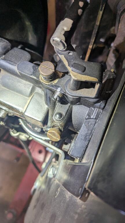

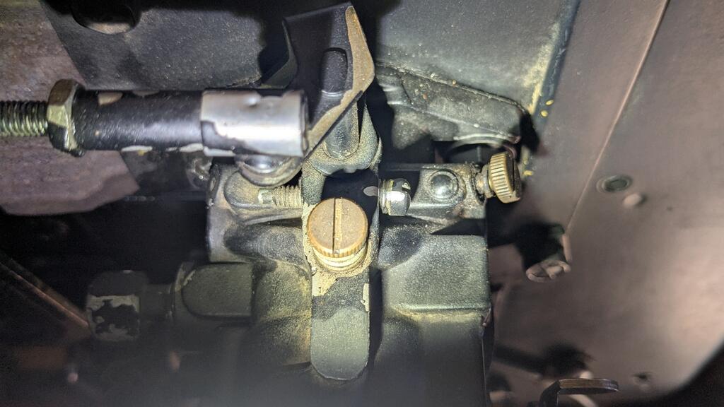

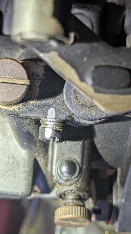

Alrashid2 433 #5 Posted March 2, 2025 Everything else seems to be in order and the tractor runs perfectly otherwise. I had tuned the carb as per the Kohler manual previously. Here are some photos of my idle screw from various angles. Share this post Link to post Share on other sites

pfrederi 19,491 #7 Posted March 3, 2025 1750 is faster than Kohler spec idle speed to get that you had to tighten the idle speed set screw. Extended period tightened up could weaken an old spring. 1 Share this post Link to post Share on other sites
Alrashid2 433 #8 Posted March 3, 2025 Thanks for weighing in, yes I know that is higher than the spec idle speed of 1200 RPM (or maybe it's 1250? can't remember). I let my tractor idle more than many here would recommend so to help alleviate any woes of oil lubrication and cooling, I raised the idle speed a bit. What you said makes sense, thanks ! Share this post Link to post Share on other sites
pfrederi 19,491 #9 Posted March 3, 2025 If you want to maintain the higher speed once you get it set a little blue loctite may keep it in position... 1 Share this post Link to post Share on other sites
