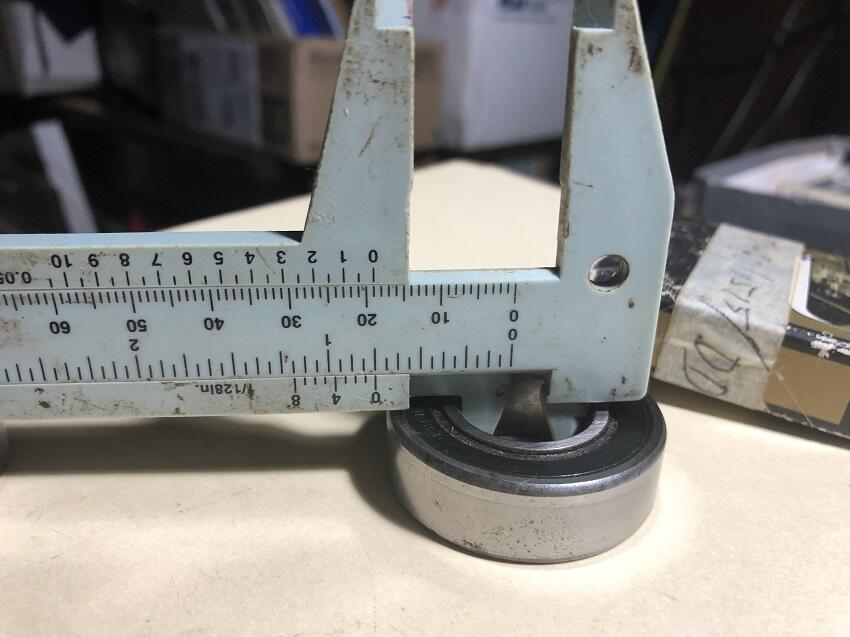

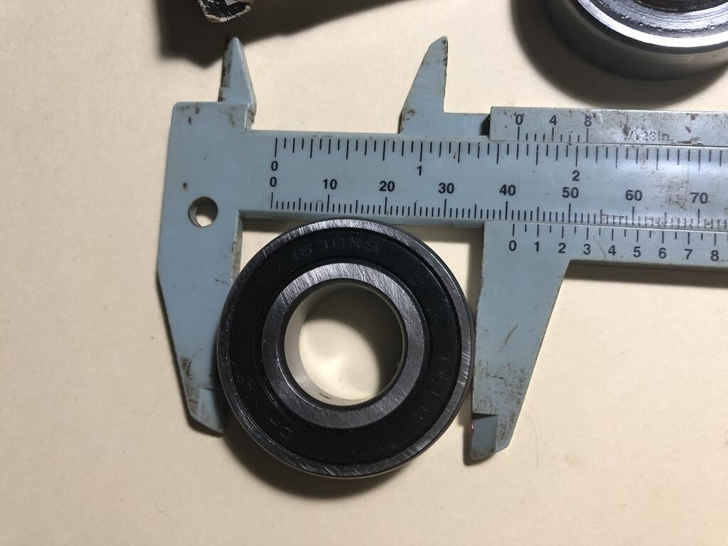

Maynardb 19 #1 Posted February 26, 2025 Hi i have a question about this deck. The only info I see on this site is for a similar looking deck with an rounded outside edge bolted on. Mine is flat sheet metal but I think the same bearings apply. Someone had been in here before and replaced the bearings on the spindles with the wrong OD ones and shimmed them. I measure 1 5/8”OD x 3/“4 ID x 1/2” w. It appears the same bearings go in the cross shaft that powers the spindles as well. It appeared that they were sealed bearings with one side seal removed so the grease would get to them. my question is under the top gears on the spindle shafts, there are two thin washers but I expected to see a flat bearing with small needles and a thin washer so I’m not sure if this is correct. Also, no washer under the spindles. I’d appreciate advice from someone who’s been there before thx Share this post Link to post Share on other sites

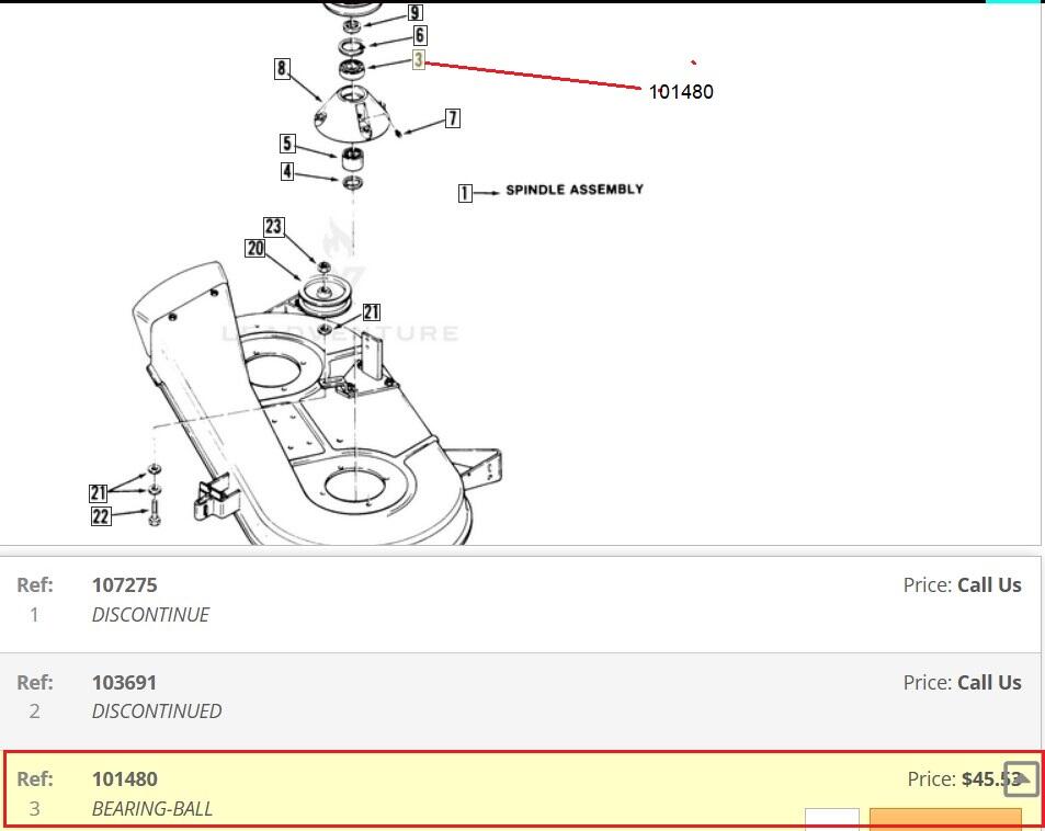

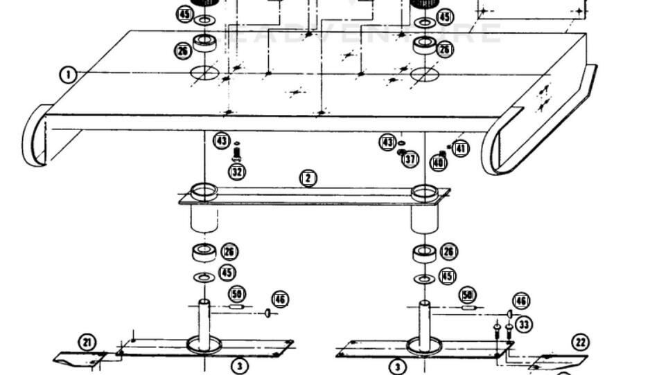

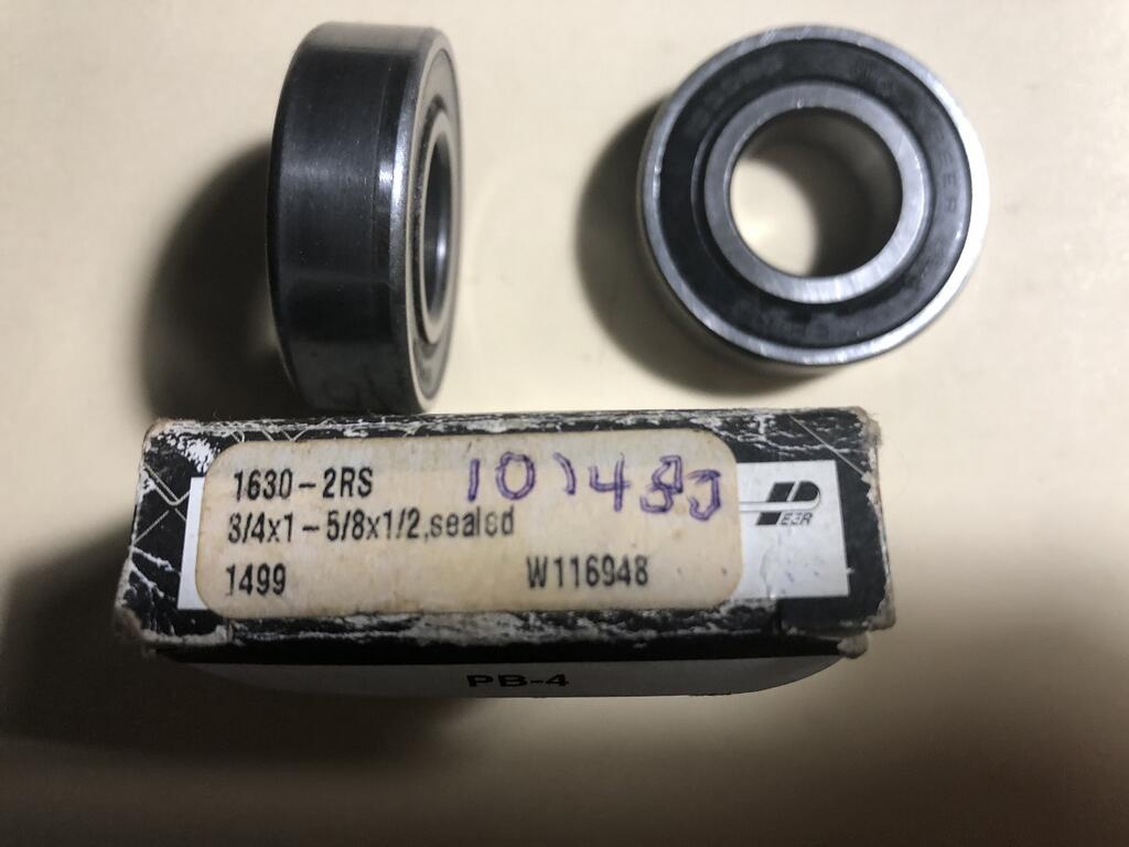

daveoman1966 3,882 #2 Posted February 27, 2025 I have that bearing... it is part # 101480. Measurements are 3/4" ID x 1-5/8" OD x 1/2" thick. This is for the 32" deck...or 37" according to Toro schematics (pic attached). Actually, I have two of them. Exact same dimensions, but different part # on them is different....revised part#s from Toro are common. This bearing lists at $44... I can send one for $32...shipped. OR--- both for $52...shipped. Share this post Link to post Share on other sites

Maynardb 19 #6 Posted February 27, 2025 Yes, I think it’s an rmr-32. That gives a nice clear schematic showing how the bearings are set up, as well as it not having a thrust bearing under the spur gear. I found a seller on Amazon that sells 5 of the bearings for $18 which is dirt cheap. Thanks for all the advice and the schematic link👍 1 Share this post Link to post Share on other sites

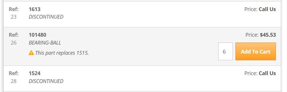

daveoman1966 3,882 #8 Posted February 27, 2025 The RMR-32 schematic shows spindle bearings to be #101480...which replaces bearing #1515. Share this post Link to post Share on other sites
