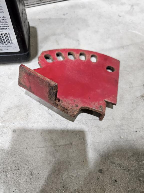

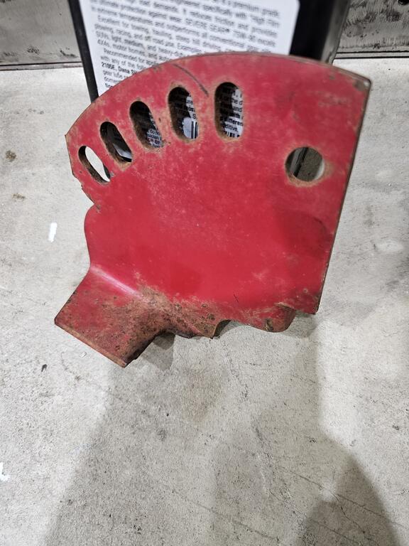

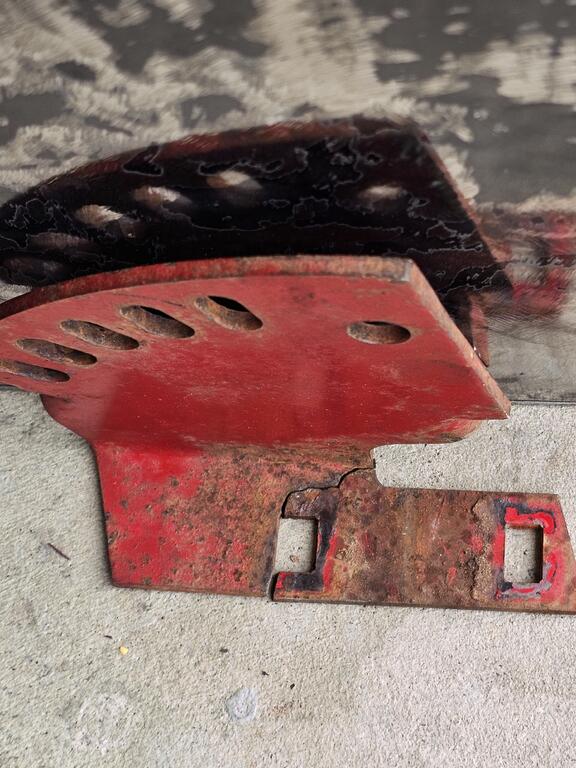

HyperPete 939 #36 Posted March 1, 2025 (edited) On 2/26/2025 at 5:02 PM, Blasterdad said: The quadrant is not welded to the deck, it bolts on under the axle bracket like the pic shows. @Blasterdad - today, while doing a little work to ithe tractor, I took a closer look at the quadrant. It's broken, thus the missing bolt hole. If I can find one inexpensively, I'll just buy it, along with the missing spring. If not, I'll weld a new piece on and drill the hole for the mounting bolt. Edited March 1, 2025 by Pete D Share this post Link to post Share on other sites
Blasterdad 3,168 #37 Posted March 2, 2025 44 minutes ago, Pete D said: If I can find one inexpensively, I'll just buy it, along with the missing spring. If not, I'll weld a new piece on and drill the hole for the mounting bolt. The broken piece is stiil under the axle bracket in your last pic. Should be able to have it welded back together, if not I probably have one... 1 Share this post Link to post Share on other sites
HyperPete 939 #38 Posted March 2, 2025 1 minute ago, Blasterdad said: The broken piece is stiil under the axle bracket in your last pic. Should be able to have it welded back together, if not I probably have one... I have a MIG that doesn't get enough use. I'll give it a try, and if it doesn't hold, I'll contact you. I didn't recognize the other piece,; I'll look more closely. I'm sure it's obscured by rust, there's a ton of it! Thanks! 1 Share this post Link to post Share on other sites

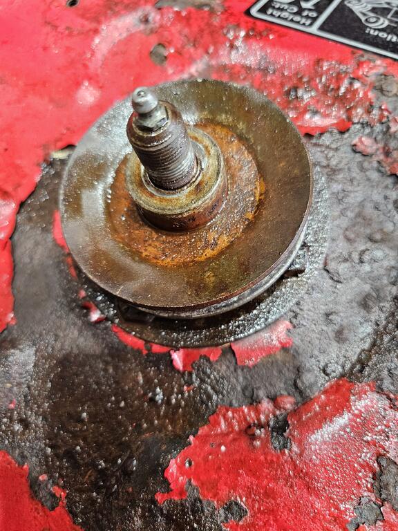

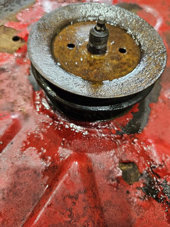

HyperPete 939 #39 Posted March 4, 2025 I'm disassembling the deck. How do I get the pulleys off without damaging them? Do I remove the zerk fittings and use a three jaw puller? Share this post Link to post Share on other sites
HyperPete 939 #40 Posted March 4, 2025 On 3/1/2025 at 7:25 PM, Blasterdad said: The broken piece is still under the axle bracket in your last pic. Should be able to have it welded back together, if not I probably have one... Found it! 1 Share this post Link to post Share on other sites
HyperPete 939 #41 Posted March 4, 2025 (edited) 2 hours ago, Pete D said: I'm disassembling the deck. How do I get the pulleys off without damaging them? Do I remove the zerk fittings and use a three jaw puller? I found THIS. Going to go inspect further. EDIT: Not pertinent. Edited March 4, 2025 by Pete D Share this post Link to post Share on other sites
Blasterdad 3,168 #42 Posted March 4, 2025 1 hour ago, Pete D said: I found THIS. Going to go inspect further. A 3 jaw puller is a no no, it will damage the pulley. Never try to remove a hub with one either, it will break the hub. A collar puller like you found the pic of is the correct way, sometimes if they're not rusted bad you can put 2 pry bars underneath the pulley & try to slowly "rock" the pulley off. I've done both but the puller is the way to go... 1 Share this post Link to post Share on other sites
HyperPete 939 #43 Posted March 4, 2025 (edited) 2 hours ago, Blasterdad said: A 3 jaw puller is a no no, it will damage the pulley. Never try to remove a hub with one either, it will break the hub. A collar puller like you found the pic of is the correct way, sometimes if they're not rusted bad you can put 2 pry bars underneath the pulley & try to slowly "rock" the pulley off. I've done both but the puller is the way to go... Will it be safe to use one on that shaft? I'll remove the zerk fitting but I am worried about damaging the threads for the zerk. I'll hit up Advanced Auto and borrow one. Thanks! Another issue, I need a float bowl gasket. (Mine is getting old and hard.) My small engine shop says that they're no longer available. Which one of the vendors listed here should I hit up for this part? A to Z, or somebody different? Thank you! Edited March 4, 2025 by Pete D Share this post Link to post Share on other sites
