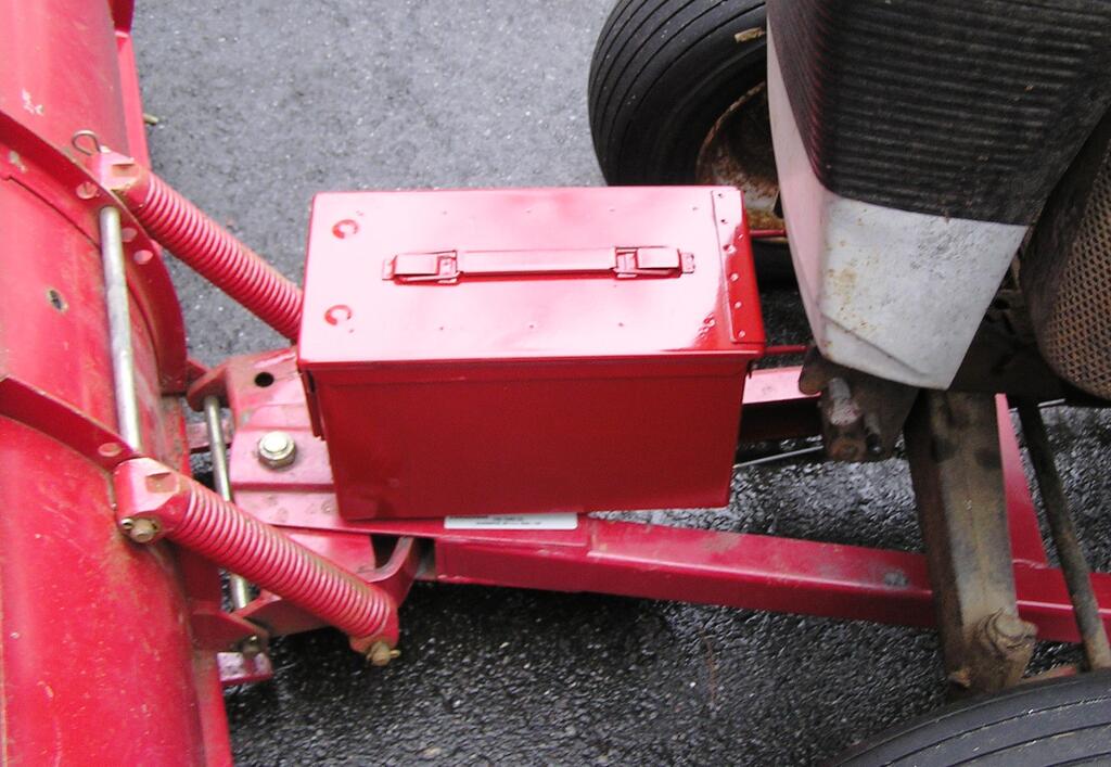

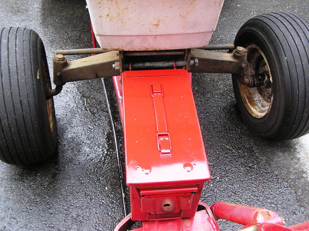

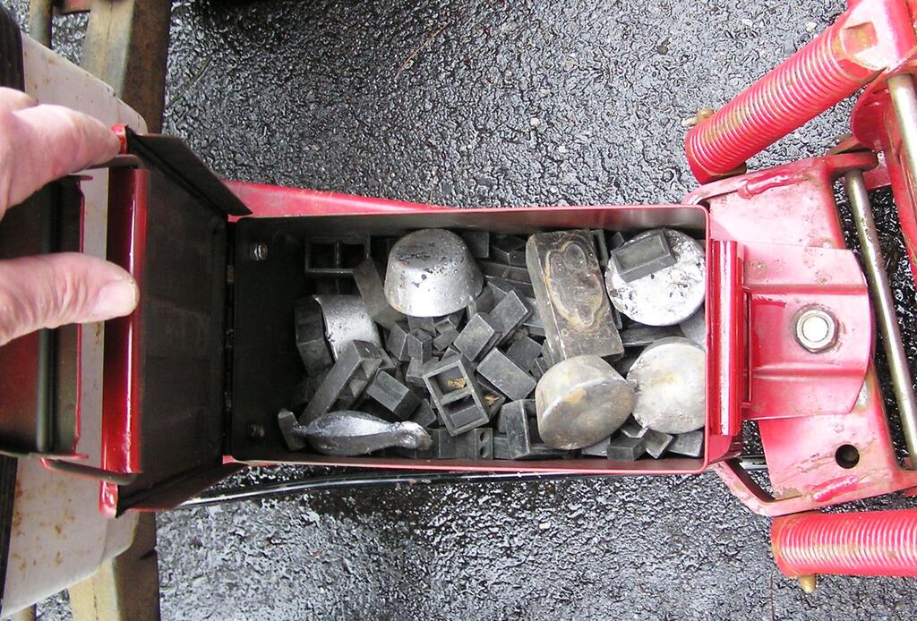

Wayne0 1,528 #1 Posted February 24, 2025 As some of you know, I've been using a piece of railroad track for weight on my plow. Well, it's hard to get it to stay put. I fabbed up a weight box from a 50 cal ammo can to hook on to the front tatchomatic. It rests on the plow frame instead of the blade. Having been in the printing trade 45 years or so, I've accumulated a 5 gal bucket of lead type. Now I have a box to put it in! Waiting for paint to post pics. 2 Share this post Link to post Share on other sites

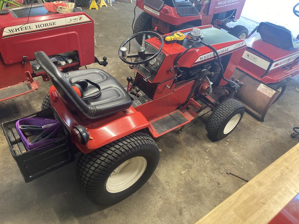

SylvanLakeWH 30,661 #4 Posted February 24, 2025 (edited) I used an old metal milk crate mounted on a winch plate to a 2" receiver... works like a charm... Edited February 24, 2025 by SylvanLakeWH 2 Share this post Link to post Share on other sites

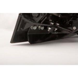

Wayne0 1,528 #5 Posted February 24, 2025 1 hour ago, rmaynard said: I don't know what type of driveway you plow, but the weight of the plow alone is more than enough to keep my 48 incher tight to the asphalt. On the other hand, if I try to pull snow with it, it will ride up over the snow. However, that is not the intent of a snow blade which is meant to push only. Something else in my mind is a "back drag" blade attachment similar to the Fisher plows. I'll have to brain storm that one. The weight box came to me laying in bed last night! 2 Share this post Link to post Share on other sites

wallfish 19,400 #13 Posted February 24, 2025 4 hours ago, Wayne0 said: Something else in my mind is a "back drag" blade attachment similar to the Fisher plows. A regular blade will back drag better when the blade is tilted forward. 1 Share this post Link to post Share on other sites
Wayne0 1,528 #14 Posted February 25, 2025 32 minutes ago, wallfish said: A regular blade will back drag better when the blade is tilted forward. Yeah, I could see that, but to change tilt mid plow would be a PITA. It would be nice to have a swinging edge that would come into play on the back drag. Have you seen the way the Fisher works? Share this post Link to post Share on other sites
wallfish 19,400 #15 Posted February 25, 2025 12 minutes ago, Wayne0 said: Yeah, I could see that, but to change tilt mid plow would be a PITA. It would be nice to have a swinging edge that would come into play on the back drag. Have you seen the way the Fisher works? Leave the blade forward all the time if you drag a lot. It doesn't need to be moved back and forth mid plow. No I haven't seen that 1 Share this post Link to post Share on other sites
Wayne0 1,528 #16 Posted February 25, 2025 (edited) 14 minutes ago, wallfish said: Leave the blade forward all the time if you drag a lot. It doesn't need to be moved back and forth mid plow. No I haven't seen that With the blade tilted forward, it skips over wet, packed snow. I don't have to drag much. Only a bit in front of the garage door. Not a big issue. I'm always trying to improve things. Edited February 25, 2025 by Wayne0 2 Share this post Link to post Share on other sites
SylvanLakeWH 30,661 #17 Posted February 25, 2025 23 minutes ago, wallfish said: Have you seen the way the Fisher works? Pretty slick... I'm thinking not to hard to add to a WH plow if you do a lot of back dragging... 1 Share this post Link to post Share on other sites
Wayne0 1,528 #18 Posted February 25, 2025 (edited) Pics as promised. About 50 lbs in there with room for more. The box pivots on the tachomatic to move up and down with the plow. I may have to re-think the attachment if it doesn't hold up. Edited February 25, 2025 by Wayne0 1 1 Share this post Link to post Share on other sites
ebinmaine 77,566 #19 Posted February 25, 2025 Looks good from here. Share this post Link to post Share on other sites
Handy Don 16,025 #20 Posted February 25, 2025 1 hour ago, Wayne0 said: I may have to re-think the attachment if it doesn't hold up. All good except that I would make sure the ⅝” bolt’s theads are not rubbing on the hitch’s frame, especially since there will be regular movement there. Share this post Link to post Share on other sites
Wayne0 1,528 #21 Posted February 25, 2025 (edited) 2 hours ago, Handy Don said: All good except that I would make sure the ⅝” bolt’s theads are not rubbing on the hitch’s frame, especially since there will be regular movement there. Actually, it's a 1/2" bolt. A little small, but it was handy. I'll dig through my "pile-o-stuff". I think I have a piece of 5/8" stainless. I'll drill it for pins. Confirmed it works as expected. I just finished scraping 2" of ice off my driveway. Edit- The stainless is 3/4", however I can sleeve the bolt to cover the threads. Edited February 25, 2025 by Wayne0 1 Share this post Link to post Share on other sites
