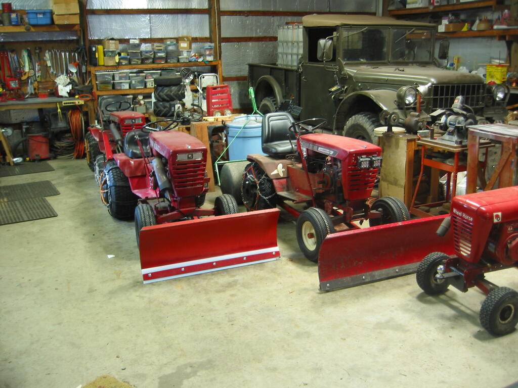

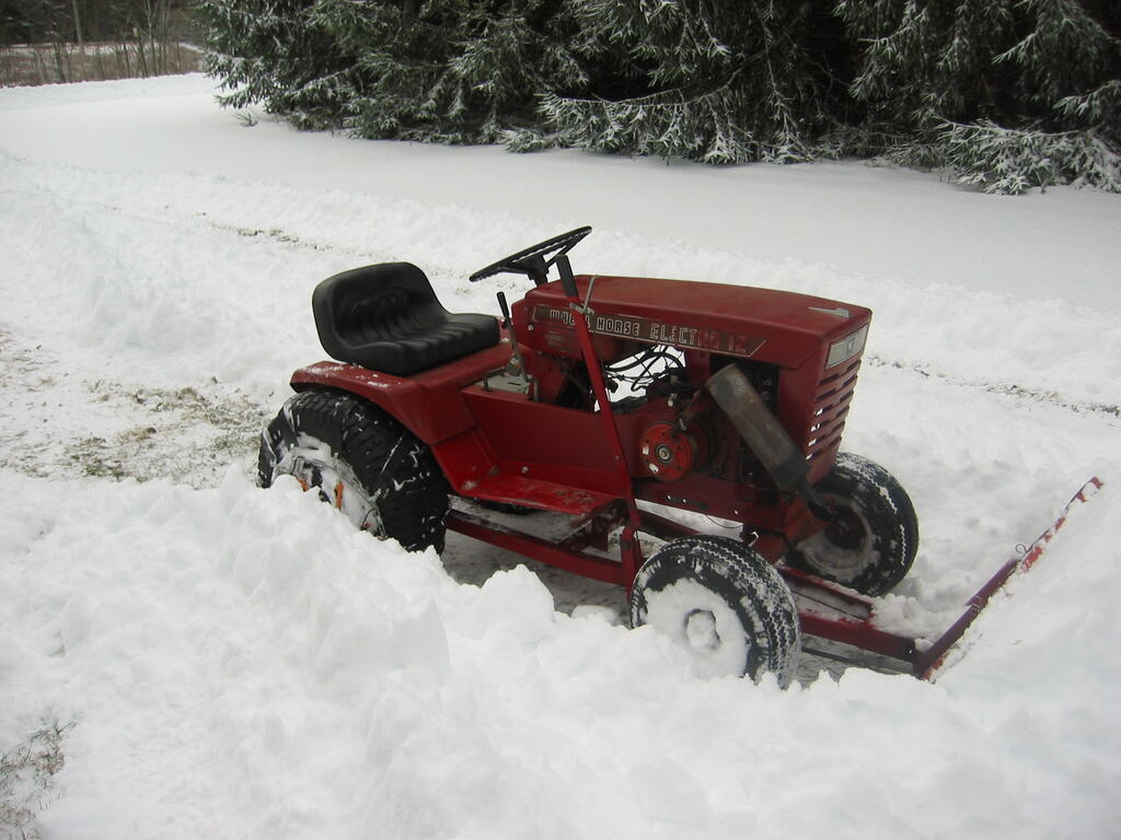

pfrederi 19,794 #2 Posted February 20, 2025 (edited) Had to look this up...you mean rubber chains. They work I use them on one plow tractor that works the pavers area (plastic blade edge also) I did tear off one cross link They need to be kept Tight as they try to get diagonal for 96% of what I plow Steel works better Edited February 20, 2025 by pfrederi 3 Share this post Link to post Share on other sites
ri702bill 11,140 #3 Posted February 20, 2025 Got a blade for the M-37?? Share this post Link to post Share on other sites
pfrederi 19,794 #4 Posted February 20, 2025 6 minutes ago, ri702bill said: Got a blade for the M-37?? NO and if you ever tried to steer an M-37 you would know why Share this post Link to post Share on other sites
ri702bill 11,140 #5 Posted February 20, 2025 Gives a good upper arm workout!! 1 Share this post Link to post Share on other sites

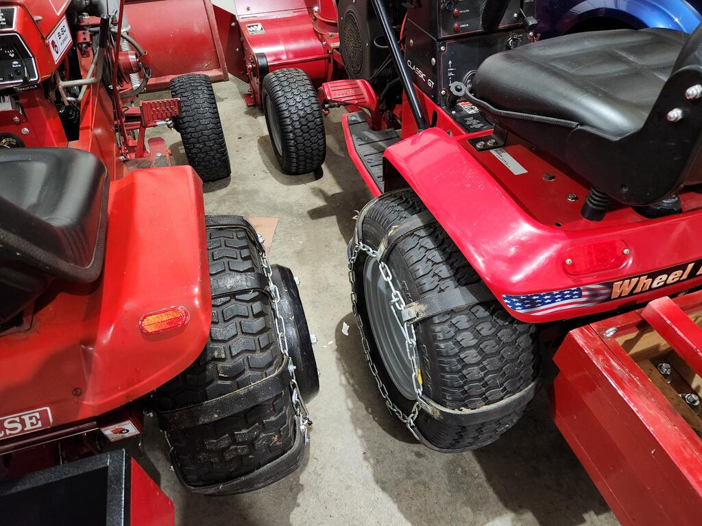

Racinbob 12,666 #7 Posted February 21, 2025 (edited) I have a set of Terra Grips on one tractor and Softclaws on another one. Absolute musts on concrete or asphalt areas. On the first install I deflate the tires. I fit the chain to the tire and remove any extra links just because it makes for a clean install (spell OCD). Make sure the circular chains don't have any twists and I work the rubber cross links as tight as I can to the tire. Once reinflated it stays put and I never need to use spring tensioners. On the following reinstalls I do deflate again but it's never a guess as to which links I used. When removed in the spring I keep them straight and hang them on a wall to tagged to the particular tire they were fitted to. I did the same when I used steel in both 2 link and 4 link. Never had a floppy chain issue. One of the sets came with chain tensioners but they are still in the bag unused. They do ride rougher but really no worse than 2 link steel. 4 link steel are a little smoother riding and that was my go to. You could add rubber links to make them 2 link but I don't think that would work well. As far as traction I'd say as good as steel except for glare ice. I use the blade a lot in the summer for dirt and whatever in the woods. I was surprised to find the rubber were actually better on the sandy gravel we have. I thought I'd switch to steel in the summer but the steel haven't come off the barn wall for several years now. We used to have a railroad stone/slag drive. I didn't have the rubber at that time but I suspect the steel would definitely win on that stuff. Terra Grips are somewhat heavier than the Softclaws making them more durable. I used the blade on the tractor with the Softclaws and they did show some minor damage. The dirt and woods use is much tougher on them than the snow. Terra Grips also use bolt in links which I like but I've never had the real need. It would be easy to drill out the rivets on the Softclaws if needed. Terra grips left, Softclaws right. You can see a little bit of crosslink movement as they 'settle' in but they won't go any further than that. Edited February 21, 2025 by Racinbob Share this post Link to post Share on other sites
