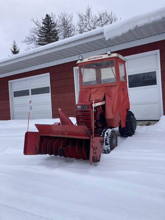

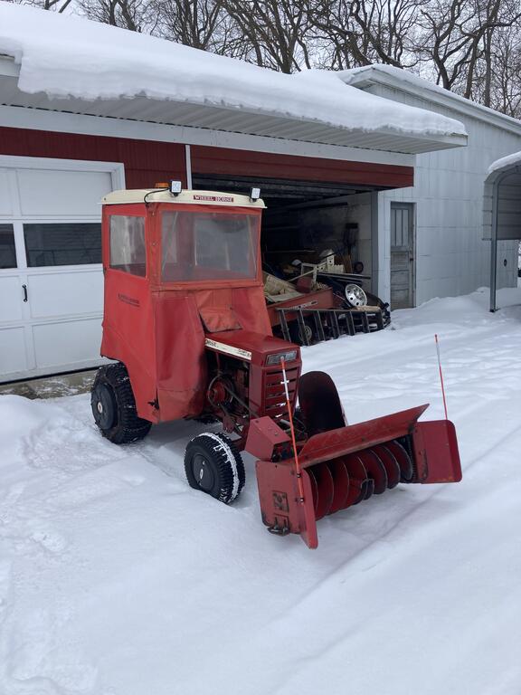

Blasterdad 3,163 #18 Posted February 21, 2025 3 hours ago, JCM said: Again, Started second crank! Here she is ready to eat some snow... 2 Share this post Link to post Share on other sites
