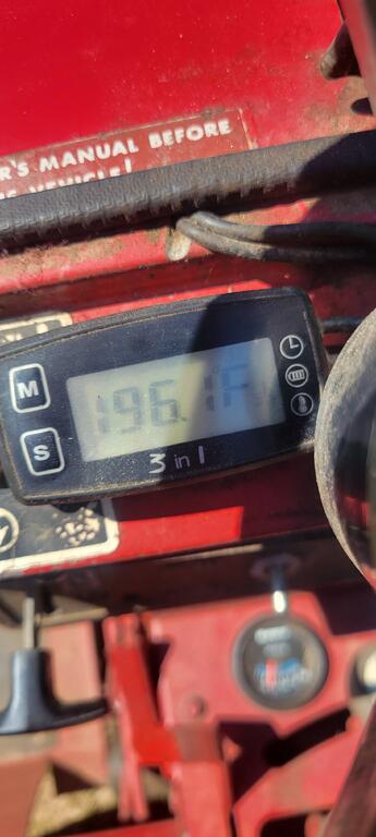

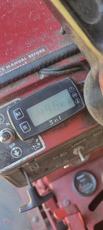

RED-Z06 2,613 #31 Posted February 20 Always love data. I took my C100 out just now, it has a CHT gauge on it, it normally runs 270⁰-280⁰ mowing in the summer, but the ambient today was 50⁰, i fired it up, checked idle speed which was 1206rpm, and set low idle for 16 minutes, the temperature had stabilized at 195⁰-197⁰ for a few minutes, thats well under any kind of dangerous temperature. 2 2 1 1 Share this post Link to post Share on other sites
