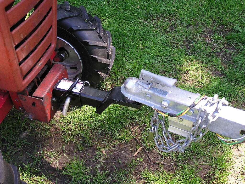

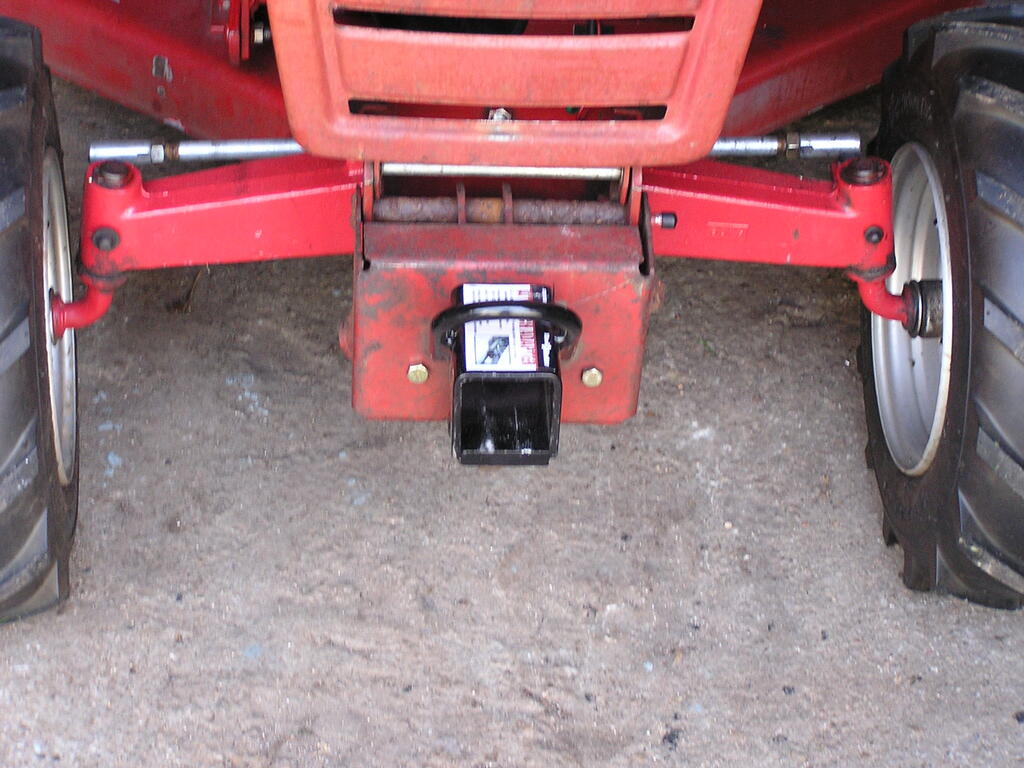

Chaz54 92 #1 Posted February 19 Some time back I bought the front receiver hitch mount pictured for the front of my 520H. I want to find another one like this or one similar. I’ve done a search here and online, but I can’t seem to find one. I know you guys can get me headed in the right direction. Thanks, Chuck W. Share this post Link to post Share on other sites

Handy Don 15,202 #5 Posted February 19 (edited) 1 hour ago, Chaz54 said: Of particular value here is the “U” that fits around the Attach-a-Matic locking rod putting the lower support directly against the hitch's frame to carry a heavy load. Can you share the dimensions? I'd ask a fabricator friend to give me an estimate to replicate it. Edited February 19 by Handy Don 2 Share this post Link to post Share on other sites

ri702bill 10,576 #9 Posted February 19 (edited) 37 minutes ago, Handy Don said: Of particular value here is the “U” that fits around the Attach-a-Matic locking rod putting the lower support directly against the hitch's frame to carry a heavy load. Can you share the dimensions? I'd ask a fabricator friend to give me an estimate to replicate it. Mine has two fixed supports inside to distribute the load. Made up out of a rusty Tach-a-matic Mule Drive and an $11 HFT ATV front hitch adapter. Bonus - the "D" ring makes a great handle to mount it... Edited February 19 by ri702bill 6 1 Share this post Link to post Share on other sites

ri702bill 10,576 #13 Posted February 19 (edited) 22 minutes ago, WHX?? said: OK... I'll make two and you get the first experimental one that will be all boogered up & farmer welded. Lost me there Bill on the back side of the mule? I got a bunch of those... missing knob no pullies. I did not have them at first, but had to add them. The hitch assembly would pivot on the pull rod and the hitch would droop. I repurposed a stock pair of 1/2" WH tierods for the material. Sorry, no pictures from the inside... Bill Edited February 19 by ri702bill 1 Share this post Link to post Share on other sites

ri702bill 10,576 #17 Posted February 20 Milled a square cut thru, shortened the back of the mount until it hit the rod inside and seated out the front. Weld there and several other spots of contact..... 2 Share this post Link to post Share on other sites

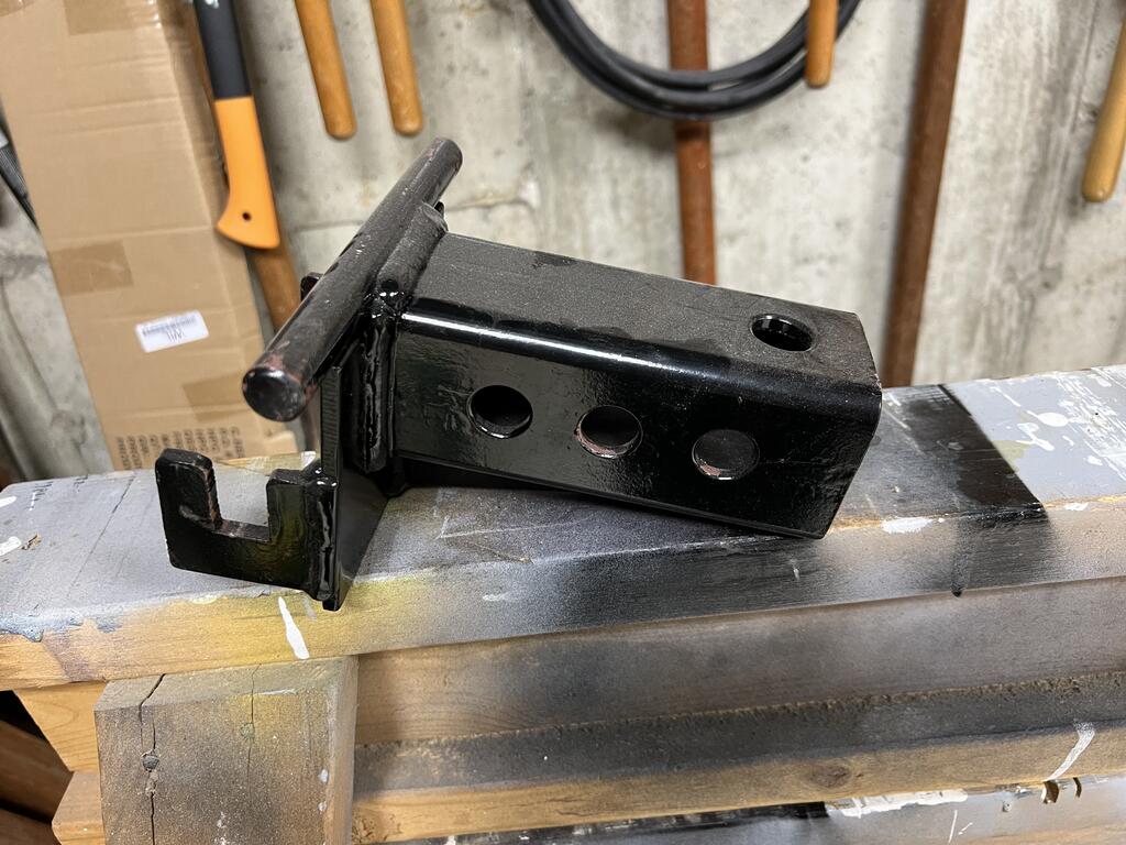

Lee1977 7,456 #18 Posted February 20 (edited) Here's one I made. It's bolted together with a 1/2" bolt. I used a 5/8" bolt in the hitch just because I had some. There a few more home made designs that members made that go back to the mid hitch Edited February 20 by Lee1977 4 Share this post Link to post Share on other sites
ri702bill 10,576 #19 Posted February 20 Lee - I like the way the mid-hitch rod is turned down at the ends - keeps it centered and gives ample material to drill the center out to accept the short portion of the stay rod. I passed on doing that as I keep the cutting deck on all summer. Can't mount both at the same time.... my version allow that. 1 Share this post Link to post Share on other sites
Lee1977 7,456 #20 Posted February 20 (edited) 25 minutes ago, ri702bill said: Lee - I like the way the mid-hitch rod is turned down at the ends - keeps it centered and gives ample material to drill the center out to accept the short portion of the stay rod. I passed on doing that as I keep the cutting deck on all summer. Can't mount both at the same time.... my version allow that. My Raider 12 is the towing tractor as it's a little short on power with a mowing deck. It will do it just slow, when I have another strong 12, 16, 18, and 20. That's a 5/8" bolt that that I had. Edited February 20 by Lee1977 1 Share this post Link to post Share on other sites
