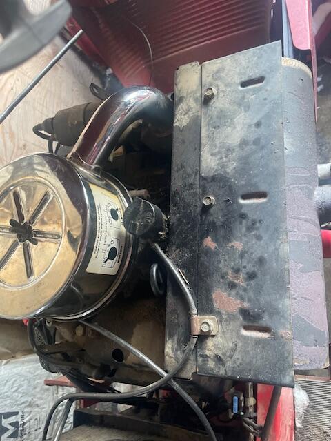

AHS 1,594 #5 Posted February 18, 2025 3 hours ago, lynnmor said: In real cold temperatures ice can form in the carburetor, when throttle is reduced the ice can melt. Try blocking the cold air and possibly pull air from the muffler. Tecumseh engines on generators have air intakes that can be turned towards the muffler in cold weather. If you altered the exhaust it might be part of the problem or maybe the fuel contains water. The air is coming from the muffler. Share this post Link to post Share on other sites

AHS 1,594 #8 Posted February 18, 2025 1 hour ago, pfrederi said: I use ABC plugs....Anything But Champion Have Autolite #25 in a couple of them. You might want to pick up the tins and round air cleaner on later Series II and Magnums You move the air intake to a place by the exhaust manifold in winter. I have both swung over by the exhaust. Let me change the plugs and clean the points. I think i have some points gaskets somewhere. 1 Share this post Link to post Share on other sites

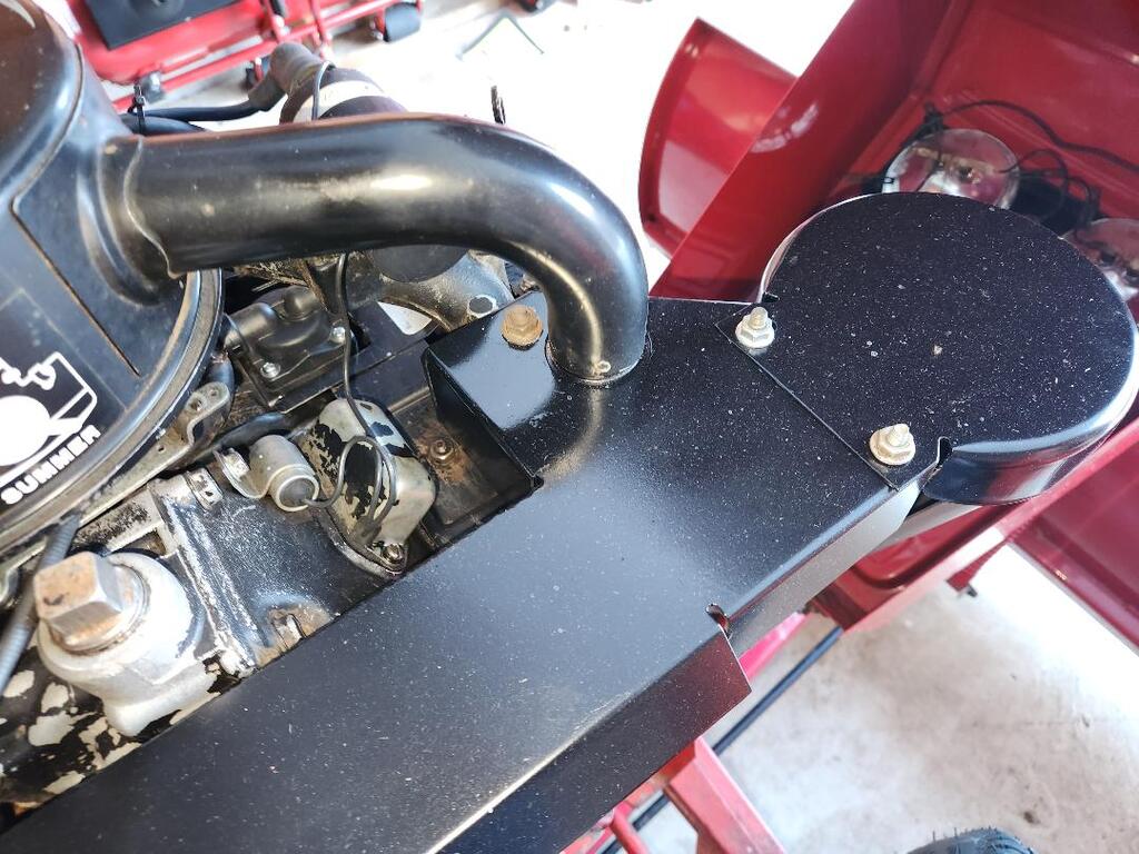

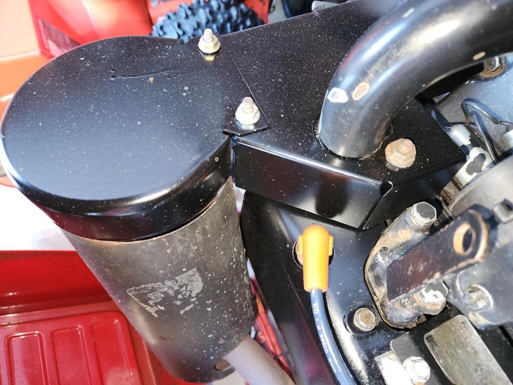

Brockport Bill 2,216 #9 Posted February 18, 2025 1983 c175 Series 1 winter breather position 1 Share this post Link to post Share on other sites
