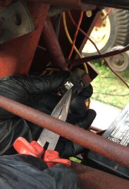

Phan 49 #1 Posted February 16 (edited) Hi There Update -- I just checked the PTO Interlock Switch is fine, but the connector has lost a terminal wire connector. https://www.partstree.com/parts/toro-105303/ Edited February 16 by Phan Share this post Link to post Share on other sites

Lee1977 7,443 #3 Posted March 1 You can use single push on wire connectors, just have to know where each wire goes. Some of us used this method on connecting the key switch. 1 Share this post Link to post Share on other sites
8ntruck 8,327 #4 Posted March 4 A lot of the connectors are Packard automotive connectors. You might be able to find contacts and housings at a NAPA store. These connectors are a modular system, using male and female crimp on connectors that snap into a variety of plastic plug housings. 1 Share this post Link to post Share on other sites
