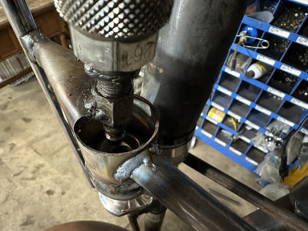

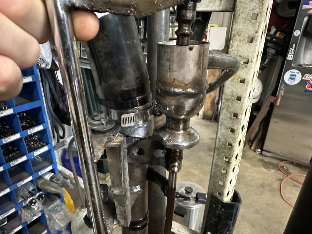

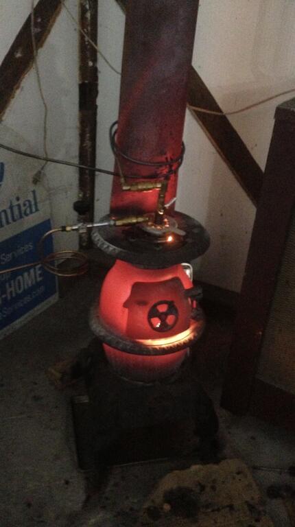

Pullstart 71,259 #101 Posted March 8, 2025 23 minutes ago, wallfish said: Nice! That thing is cranking out the heat. Interesting with the oil drip feed over the top as a preheat system. Does it not burn as good or clean with the oil feeding directly into the bottom reservoir area? The only reason I ask is because it seems like the partial burn/heat of it on the way down would or might cause some more soot or smoke because it's not as clean or thorough of a burn in that area on the way down. Adding the air tube around the oil drip seems like it cleaned things up a ton. It pushes the fire away from the end of the tube, so it doesn’t burn back, plus it breaks apart the oil like a crude injector nozzle, or a MAPP gas torch. The reason I didn’t feed oil directly into the bottom of the pot, was merely ease of assembly. The air tube likely also maintains a level of cooling so I don’t cook the oil inside the tube. 2 Share this post Link to post Share on other sites

Tractorhead 9,217 #103 Posted March 9, 2025 Hey Bro, another interesting Work you made. Congrats to your Success. It seems the both brakediscs designed and made for that. Pretty cool burnersystem. i thinkered about an nozzleburner when i read the headline. but a dripburner is also pretty Cool. At a friends place we fired several years ago lot of old Oilfilters in an Wood oven when temps drops below -18 degC to heat up his Workshop. They heated up the Stove extreme quickly, but i would suggesting keep the combustion air from outside like the exhaust to outside also. So you be in an Combustionfree Area. a flame backfire ain‘t be funny - believe me 😎😎👍 1 Share this post Link to post Share on other sites

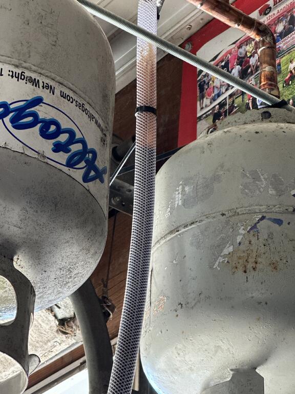

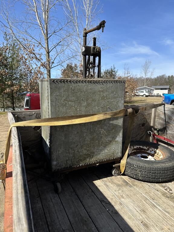

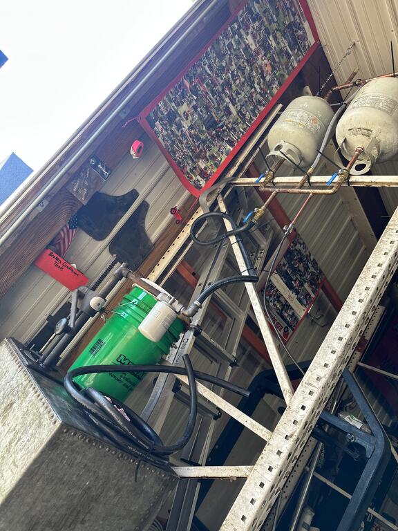

Pullstart 71,259 #104 Posted March 10, 2025 I picked up a pretty cool oil storage bin this weekend. It’s a 65 gallon capacity and has a dipstick, pump, extra large fill port, and it’s on casters! I have some 5 gallon sized paint strainers to clean the oil going in, and an in-line filter setup to filter it on the way up to the gravity bin storage tanks. 3 3 Share this post Link to post Share on other sites

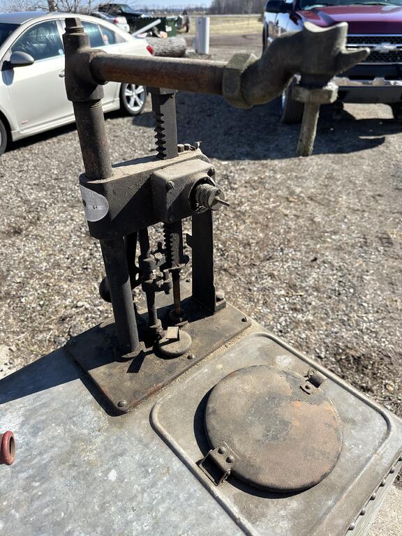

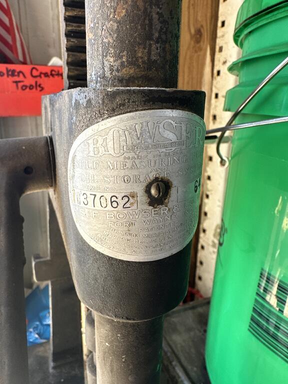

Pullstart 71,259 #105 Posted March 10, 2025 I found the patents on that pump and tank are from 1909-1912, made in South Bend, Indiana. Maybe it was a family member of the Ponds that had to do with such a cool pump! It is (was) calibrated to deliver 1/2 pint, 1 pint, or 1 quart. The 1 quart pump was a 10 second advertised promise. I just filled my LP tanks in a matter of a few minutes. I’m happy! 2 2 Share this post Link to post Share on other sites
Tractorhead 9,217 #106 Posted March 12, 2025 The Old things they just lasting and lasting.... interesting oil Cabinett you built. as far as i understand, the clear hose between the both tanks is the Filling gauge - isn‘t it? Cool idea ! 1 Share this post Link to post Share on other sites
Tractorhead 9,217 #109 Posted March 13, 2025 As allready suggested bro, Please get the Combustion Air with a separate piping directly from outside the Workshop. So combustion chamber and Heated Air beeing as strictly as possible separated when the Door is closed. So even in a case of any kind of Backfire you be save and no combustion smoke will occur to you rooms Air. That is happen on all Car or Truck Air heaters to prevent poisoning or harm yourself. I would thinkering that the closed Brakediscs you’re using now works more like a Combustion chamber at the top. With the Air blowing i supposing it gives inside them a whirl, what keeps the Fire burning and reignite the Oil that Way by a nearly low pressurized Areal like the very early multifuel Heater systems back in the late 1930‘s did. They had also a smoothened part in the Combustion chamber, where the airflow was restricted to preheat and reignite the Oil or Fuel. They also had a similar Burner but as a horizon stack not as a vertical stack and with a fuelpump and a nozzle to inject a wider spread of the incoming gasoil. The idea with your „Oildrip feeding system“ is genious. 👍 1 Share this post Link to post Share on other sites

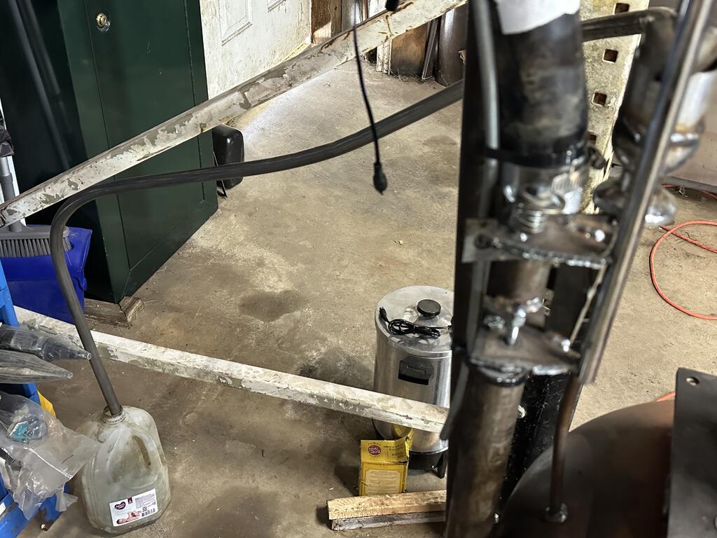

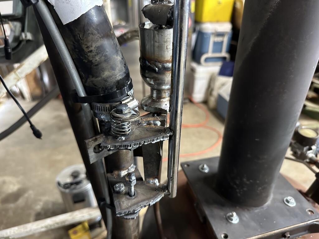

Pullstart 71,259 #110 Posted March 19, 2025 It was mentioned on the FB waste oil burners group, “What about an overflow condition?” I made a 3/4” drain system for the top of the hitch ball. I can’t see this being able to overflow at the rate that oil flows through the delivery line. It’s supposed to drop 30 degrees overnight and be terrible weather all day tomorrow. I’m looking forward to running this a bit. 1 1 Share this post Link to post Share on other sites

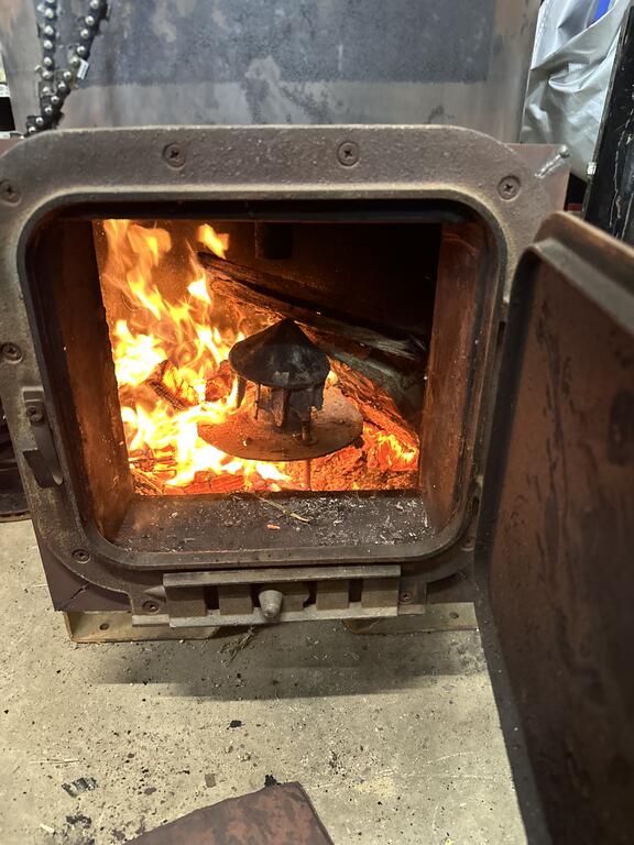

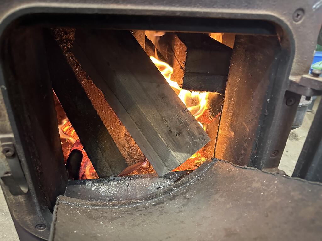

Pullstart 71,259 #111 Posted March 18 The shop is 68 degrees currently and it’s in the 20s outdoors. Just burning scrap 2x4 chunks. It’s much less volatile than the oil, and maybe a bit safer too. 4 Share this post Link to post Share on other sites

Pullstart 71,259 #113 Posted March 19 Like the volume of oil I have, I also have piles of milled wood, pallets, and logs. Lots of fuel to keep this running. Now, it’s test and tune time. How much additional air do I need from my make up fan(s)? How full can I pack it, and how long will it last? I have the burn box packed full and the bottom fan on low. The top fan tube is sealed off. I filled it at 10:15 am. Share this post Link to post Share on other sites
Handy Don 17,474 #114 Posted March 19 30 minutes ago, Pullstart said: Like the volume of oil I have, I also have piles of milled wood, pallets, and logs. Lots of fuel to keep this running. Now, it’s test and tune time. How much additional air do I need from my make up fan(s)? How full can I pack it, and how long will it last? I have the burn box packed full and the bottom fan on low. The top fan tube is sealed off. I filled it at 10:15 am. The challenge of burning stuff is the gases created by combustion, especially when combustion is at a low temperature or with limited oxygen. What’s in the stuff being burned? Where are the gases condensing, what is left behind, and is that substance flammable? Share this post Link to post Share on other sites

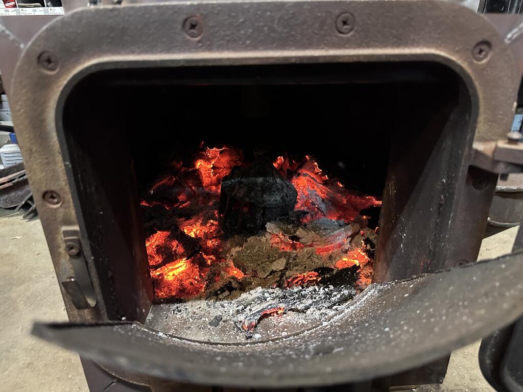

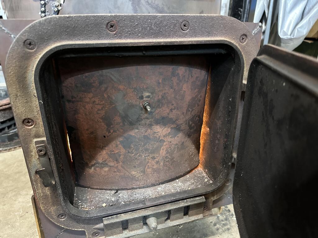

Pullstart 71,259 #115 Posted March 19 I have had blue flames from the wood, so that tells me combustion is pretty well complete. Heating with wood for many years and spending time in an R&D lab for water heaters in a past life, I’m fairly comfortable with that type of work. With no co/co2 analyzer here, I have to trust that I’m doing it right for a hillbilly. After an hour and 45 minutes, I am reduced to a good bed of coals and a refill is in order. For reference, the crude cone diffuser is the source of oxygen, so the burn is fed from the inside. Share this post Link to post Share on other sites
Blaine 276 #117 Posted June 5 (edited) Cool project. If you have access to a good supply of oil, like lots of it, and not contaminated with coolant or water, and a way to store a lot on hand, it can be a great way to heat, IF it’s done safely. A gallon of waste oil is around 125,000btu, and i can burn 3/4gal - 1gal an hour with my setup, so 10+gal on a weekend in my garage is typical if i have a project to do. I have 3 55 gallon drums that i like to have full by when winter arrives. I started playing with drip feed over a decade ago. Nobody seems to talk much about or realize all of the babysitting involved, but i knew i didn’t want to waste so much of my time constantly scrounging for and feeding wood to my wood stove. I’ve learned a lot about burning waste oil with drip feed back then. Pre-heated oil burns cleaner and hotter. Cleaning ash sucks. Cleaning gooey ash really sucks. The warmer it gets the faster it flows. Thermal runaway is scary and dangerous. I put off using a siphon nozzle setup because I didn’t want my air compressor running all the time. I wish I would have made the switch long before i did. It actually uses very little air. My 60 gallon 2-1/2hp only cycles on 2-3 times an hour. The air atomizes the oil and it burns SO much hotter and cleaner. I might clean it out twice a season, burning 10-20hrs on weekends. But babysitting was still required maybe every 30-45 minutes, just a slight tweak, but it would still gradually creep up, but nothing like the drip feed. About 5 years ago i came up with the cure. A two circuit PID controlled oil feed. When it gets too hot, the PID slows it down. Now i can walk away and not worry. Seems like every year i tweak something with it to make it even better, a little more refined. It’s always evolving, but i know it’s safe now just the way it is. Edited June 5 by Blaine 2 1 Share this post Link to post Share on other sites
