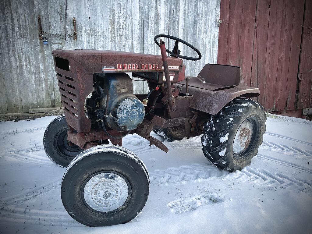

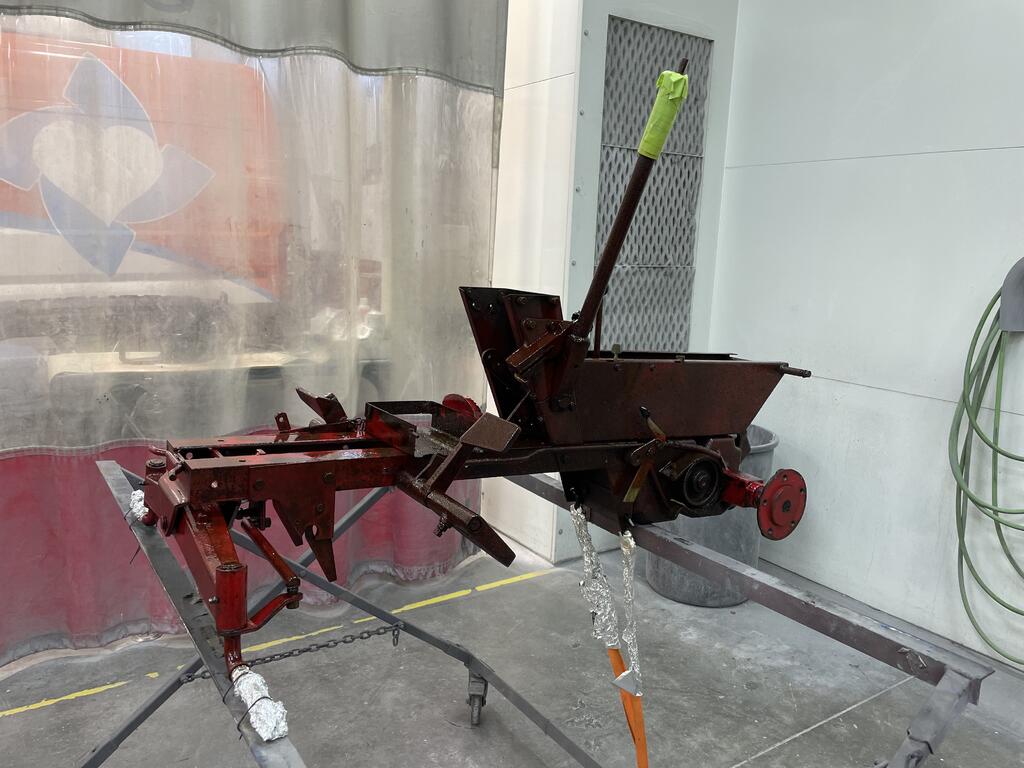

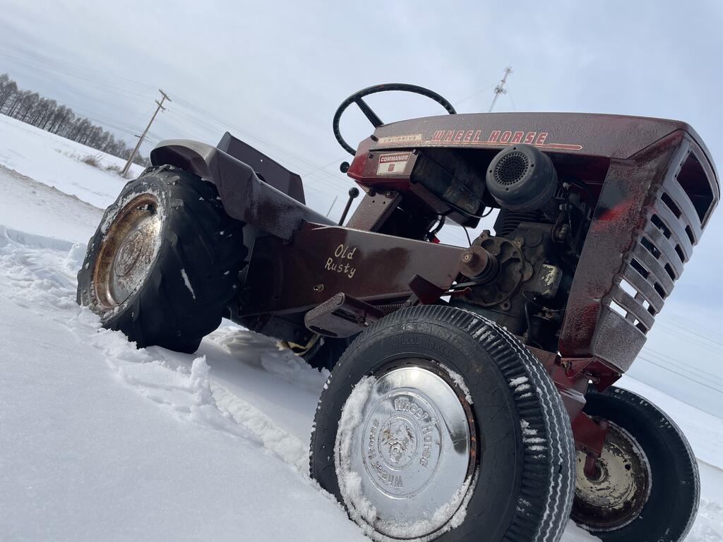

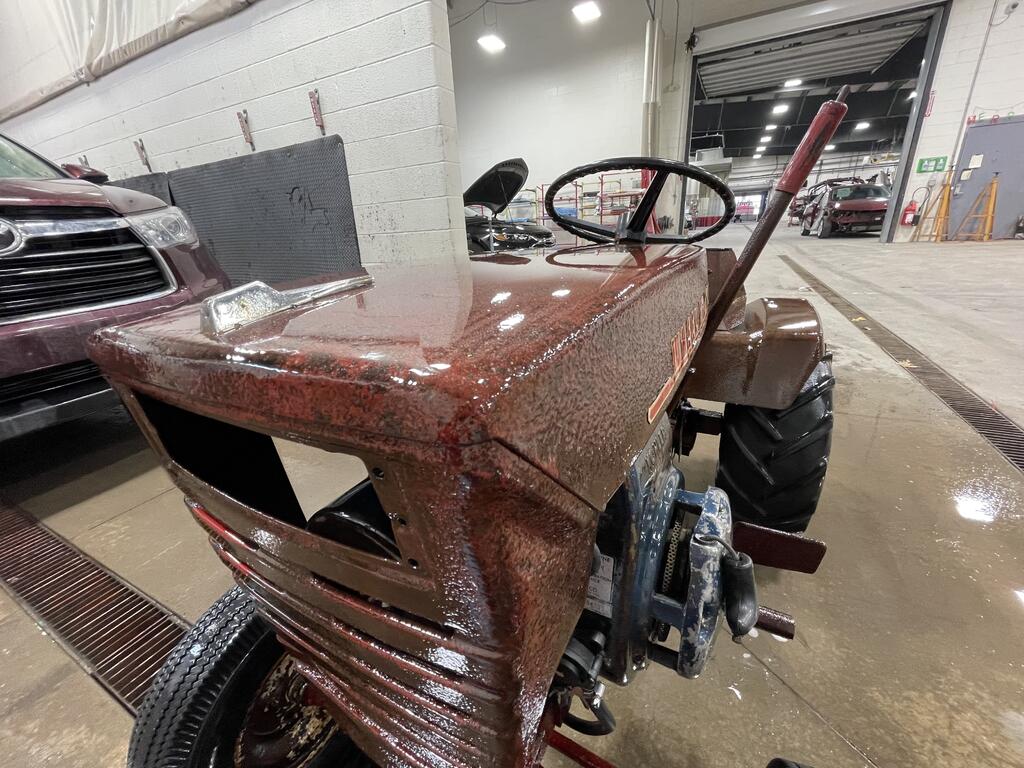

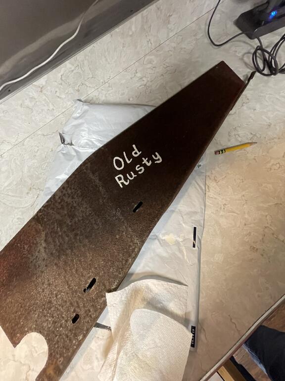

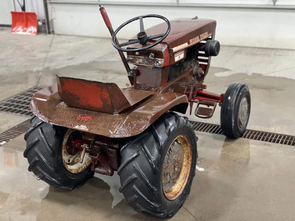

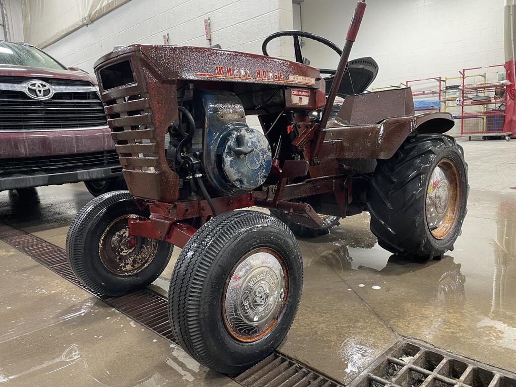

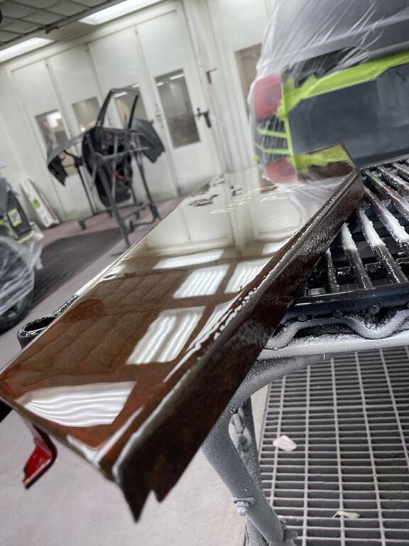

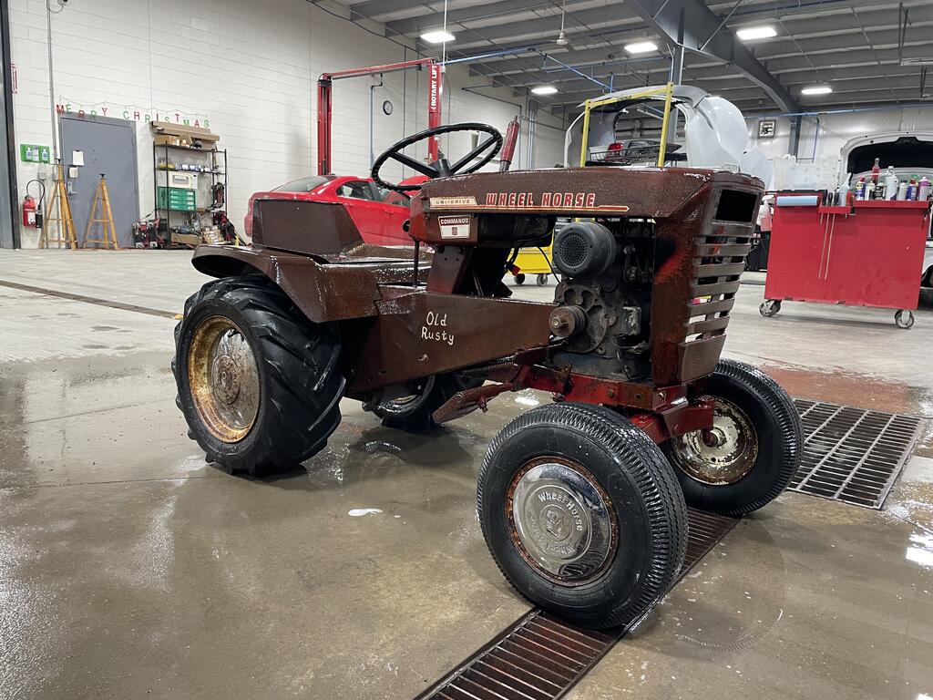

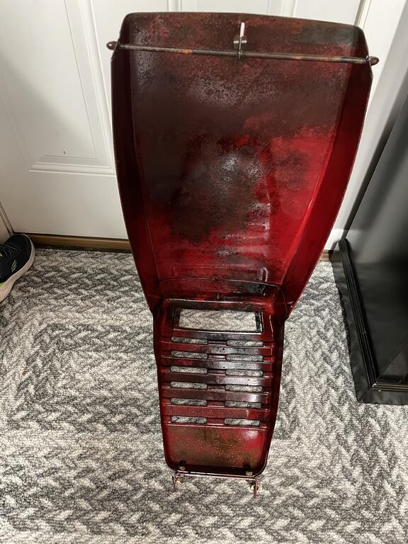

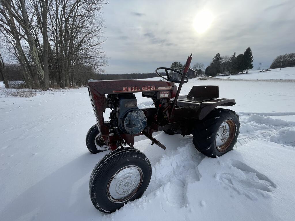

Sarthurs01 1,024 #1 Posted January 30, 2025 It was one of my more fun and easier being that there is no bodywork priming involved. Just smoothed up some of the old paint and hammered clear coat to it! A total of 9 coats on the tin work. Quick tune up on the k181 and found a broken flywheel too. All back together and running like a top! My youngest (4), named it and my oldest (7), wrote its name on the belt guard. Always fun getting them to help out! 4 6 Share this post Link to post Share on other sites

TonyToro Jr. 2,227 #3 Posted January 30, 2025 Wow! How’d you get it that glossy? Share this post Link to post Share on other sites
Sarthurs01 1,024 #4 Posted January 30, 2025 28 minutes ago, TonyToro Jr. said: Wow! How’d you get it that glossy? I sprayed 5 coats of clear sanded it smooth then put 4 more coats back on. 1 1 Share this post Link to post Share on other sites

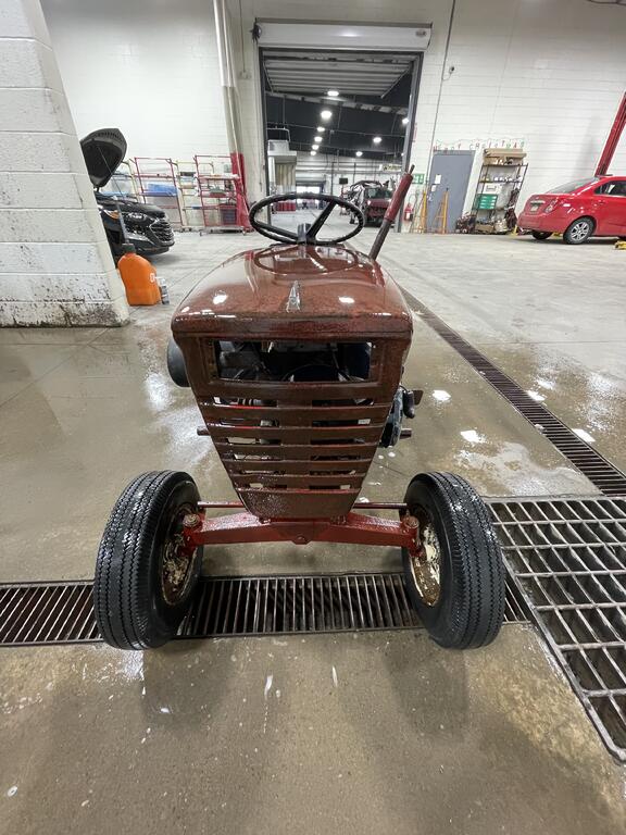

RJ Hamner 1,028 #5 Posted January 31, 2025 Great name! Too bad you have to work in such a small garage 1 4 Share this post Link to post Share on other sites
JCM 10,507 #6 Posted January 31, 2025 Nice job, nice shop. 1 1 Share this post Link to post Share on other sites
rjg854 12,727 #7 Posted January 31, 2025 Love that you saved it just the way it is. Share this post Link to post Share on other sites
