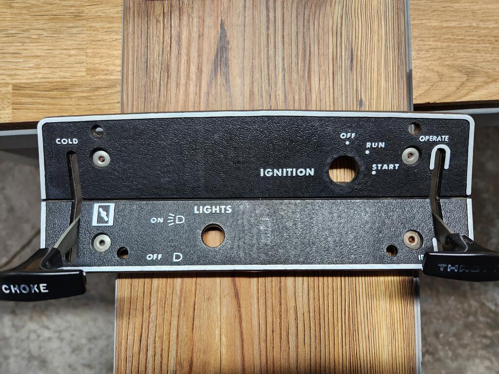

Racinbob 12,665 #10 Posted January 31, 2025 As mentioned the rivets are 3/16". I've used button head stainless 10-32 several times. This Dino dash has the rivets and I saw no need to change them but the rivets will get black paint to look better. 3 Share this post Link to post Share on other sites

Racinbob 12,665 #12 Posted January 31, 2025 1 hour ago, ebinmaine said: Just out of curiosity, is this a certain level, type, time range of production? Or two different assembly stations at the factory? Any ideas? I've seen mostly screwed on dashes up here but most of my tractors had been disassembled prior to my ownership. I haven't got a clue Eric. The one I pictured is Dino, a 78 C-121. I don't remember if I've come across rivets before. If I did I probably drilled them out to make it easier to work on. This one really didn't need work so they are staying. 2 Share this post Link to post Share on other sites
rmaynard 16,838 #13 Posted January 31, 2025 Just to clarify. The rivets or screws are not meant to attach the plastic part of the dash to the metal back-plate. Many of the plastic dash plate have a piece of double-sided tape on the back to keep it aligned during the final assembly. The entire dash assembly is finally attached to the dash housing with a 102168 black panhead sheet metal screw into a 5442 speed nut. 4 Share this post Link to post Share on other sites

Racinbob 12,665 #15 Posted January 31, 2025 Note what rmaynard said. The rivets don’t hold the plastic plates or even touch it. I really don't think aluminum would hold too well. 1 Share this post Link to post Share on other sites
