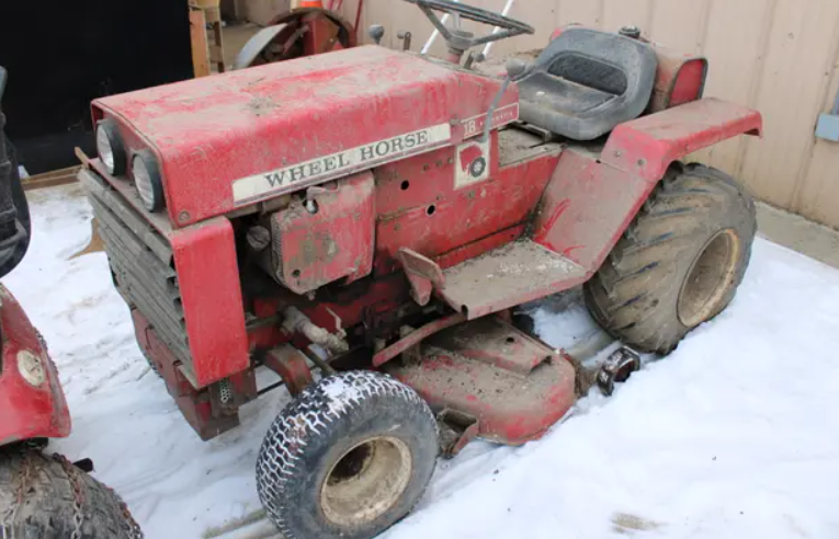

S416-8 398 #1 Posted January 30, 2025 I just picked up a 1973 D-180 tractor. Been wanting one of these since I saw one at the show a few years back. Now comes the fun in getting it running. First thing I found is that both the key swicth and the plug that goes into the back is coroded to the pint that it is falling apart. First parts needed so off to the search.. Overall after sitting for years in a barn it needs a hell of a bath but it seems solid. there is little ruat anywhere so great starting point. Found a plow alread adn reached out to the guy with the 3-point here with "I'll take it" and last will hope to find a grader blade. 5 5 Share this post Link to post Share on other sites
OutdoorEnvy 1,807 #2 Posted January 30, 2025 Nice find! That looks pretty original and altogether which is a great starting point! My friend picked up a D200 a couple years back and is slowly working on it but it's been fun to help on. I like the looks of these. Kind of a transformer look to the front with the big headlights. Some like, some don't. I do. Looking forward to seeing your progress! Share this post Link to post Share on other sites
S416-8 398 #3 Posted January 30, 2025 I love the look.. kinda of has a "go ahead step in front of me and I will eat you" look Share this post Link to post Share on other sites
