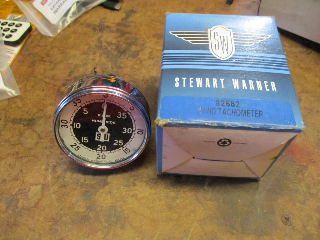

pfrederi 21,215 #27 Posted January 27, 2025 Can't address your tac readings but that engine is as Squonk said above. ( I do know that digital multimeters frequently give flaky readings on Kohlers something about the electric aurora) I use the infrared tacks and my favorite is this one. Can't beat mechanical 2 1 Share this post Link to post Share on other sites
ebinmaine 80,881 #28 Posted January 27, 2025 1 hour ago, pfrederi said: I use the infrared tacks and my favorite is this one. Can't beat mechanical Does that have a rubber bumper ish thing? Share this post Link to post Share on other sites
pfrederi 21,215 #29 Posted January 27, 2025 Yes you just press it against the end of the crank shaft or the PTO shaft 1 Share this post Link to post Share on other sites
ebinmaine 80,881 #30 Posted January 27, 2025 1 hour ago, pfrederi said: Yes you just press it against the end of the crank shaft or the PTO shaft Yep. I got one here I'd bought off fleeebay not knowing exactly what it was. Neat piece. Share this post Link to post Share on other sites
