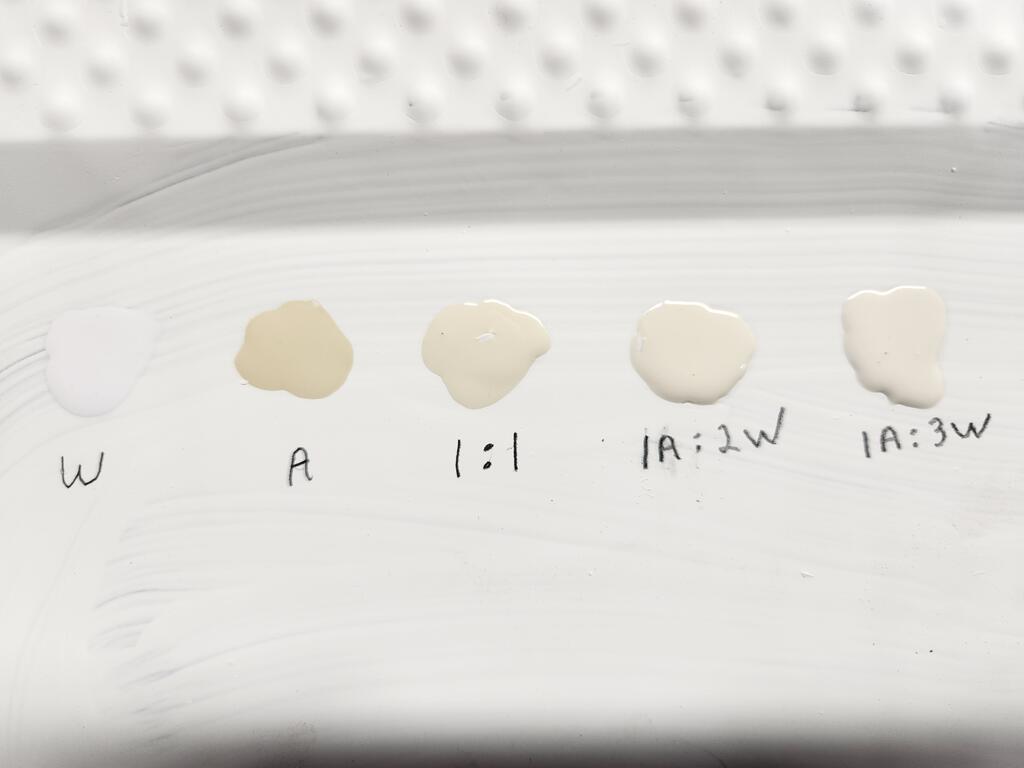

Racinbob 12,965 #1 Posted January 21, 2025 (edited) OK guys, what color red is best? Just kidding but I do have a couple questions and need your opinions. First, I'm painting the Dino C-121 with Rusty Regal Red. I've had excellent results with rattle cans but this will be the first time I'm trying a HVLP sprayer (once the weather breaks). I'm still pondering if I'll use acetone or mineral spirits to thin it but my question is what catalyst hardener have you guys used? Because of availability around here I was leaning towards the Magic that the local TSC stocks. Have any of you used this with Rusty enamel? Then there's the rim color. Back in the day they called out linen white by name. I don't want gloss white. But gloss almond is too dark for my liking. So out come the mixing cups. White, almond, 1 to 1 mixture, 1 almond to 2 white, 1 almond to 3 white. Your preference? Edited January 21, 2025 by Racinbob 1 Share this post Link to post Share on other sites
Achto 31,814 #2 Posted January 21, 2025 (edited) I like the 1:2 mix As far as reducer - Acetone will shorten your dry time (good for cold weather) & mineral spirits will increase your dry time (better for hot weather) The Magic hardener should work well. Edited January 21, 2025 by Achto 4 Share this post Link to post Share on other sites
ri702bill 12,106 #3 Posted January 21, 2025 Bob - use a light gray primer that is the same brand as your finish coat paint. I agree on the 1A:2W mix. Have also used Rustoleum Shell White in the rattle can.... Hardener - be sure to disassemble the spraygun once done to properly clean it. 3 Share this post Link to post Share on other sites

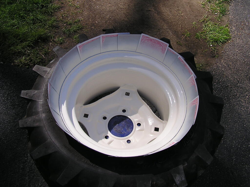

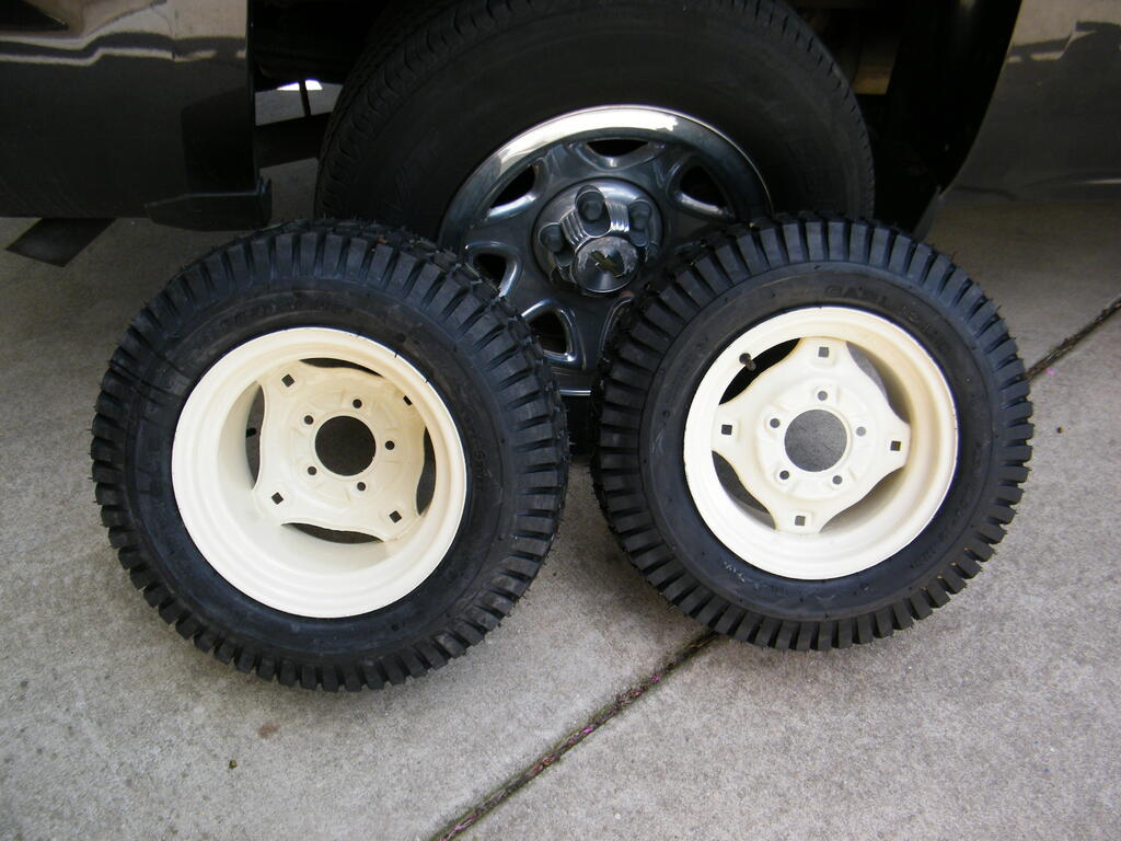

ebinmaine 78,856 #4 Posted January 21, 2025 The tint of the white seems to be a personal preference to some extent. Around hour acreage we prefer Cottage White, formerly known as Navajo White. It is a dead match to a mid-60s wheel on the inside that still had a Wheelhorse Tire on so it had never seen Sun. I'd say that's closest to the 1:2 mix. 2 Share this post Link to post Share on other sites
stevasaurus 23,689 #5 Posted January 21, 2025 I agree with the guys above. I think ///cottage white and the 1:2 mix should be close to linin biege. This is Rust-o-ieum Almond it looks like 1:1 or maybe 1:2. 3 Share this post Link to post Share on other sites

Racinbob 12,965 #7 Posted January 21, 2025 6 hours ago, ebinmaine said: The tint of the white seems to be a personal preference to some extent. Around hour acreage we prefer Cottage White, formerly known as Navajo White. It is a dead match to a mid-60s wheel on the inside that still had a Wheelhorse Tire on so it had never seen Sun. I'd say that's closest to the 1:2 mix. I agree 100% on the personal preference thing. I don't think the wheel color was consistent during any given year, let alone through the years. I've seen first hand how these things were painted at the factory and it's amazing that they even got a decent finish. Dino is nonthing near a 'factory correct' refurb. I'm just having fun. The biggest reason for this thread is my concerns about the correct hardener. In my research on it they used too many big words for me to be comfortable with my choice. So I turn to the tried and true resource. Oh yea, I was leaning towards the 1:2 ratio too. 3 Share this post Link to post Share on other sites
