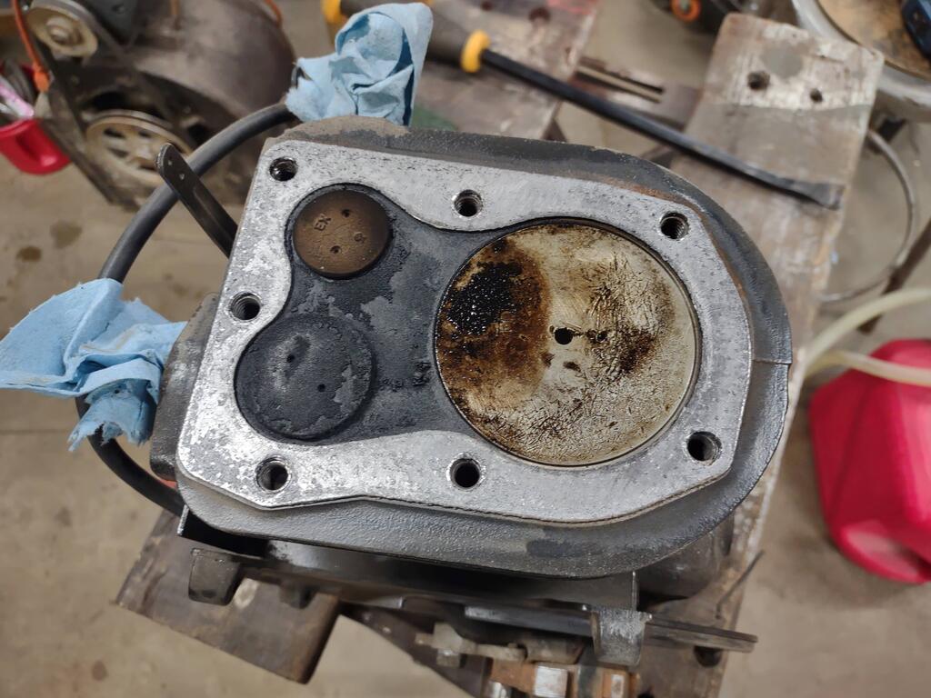

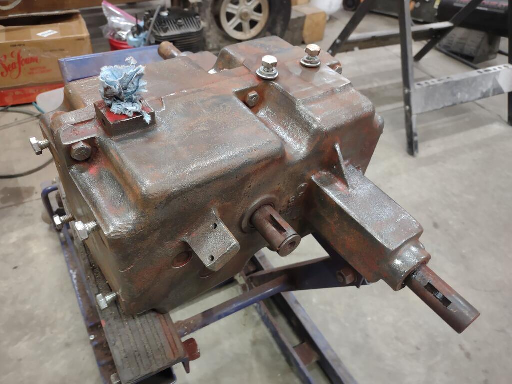

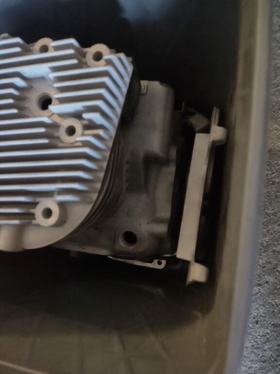

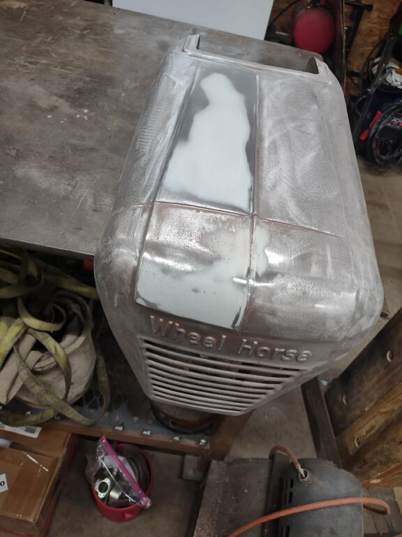

Achto 32,035 #30 Posted February 9, 2025 (edited) Some forward progress & 1 set back. First the forward progress. Got the body work done on the sheet metal. Paint stripped off the transmission, ready for a wash & some paint. Pulled the head off from the engine to see what was what. This was the set back. I was planning on just a paint over haul on this one but plans have changed. When I pulled the head I thought "Holy piston wash Batman". Well guess I'm doing an engine rebuild too. Given this fact the engine is now torn down and ready to go to the machinist as soon as the new parts get here. Crank measures out perfect, bore is not out of spec but finding the early small bore parts is not easy. So late model 2 15/16" bore will be in order. Took the time to blast all the engine parts as well. Wanting more forward movement I decided to squirt a little more paint. All I got for this weekend. Edited February 9, 2025 by Achto 6 8 Share this post Link to post Share on other sites

Achto 32,035 #32 Posted February 10, 2025 1 hour ago, AlexR said: Upside to the set back, is at least the engine will be fresh. True that. Tranny felt sound, still gonna pop all new seals in it. 3 2 Share this post Link to post Share on other sites
WHX?? 57,278 #33 Posted February 10, 2025 2 hours ago, Achto said: 2 15/16" bore will be in order. Did you even bother to look for the small bore rings if that's all it needed? I thought I found some in my 161 hunt but not in oversize. Since the bore needed work anyway. 2 1 Share this post Link to post Share on other sites
Achto 32,035 #34 Posted February 10, 2025 Go big or to home. She'll get the full Monty 3 3 Share this post Link to post Share on other sites

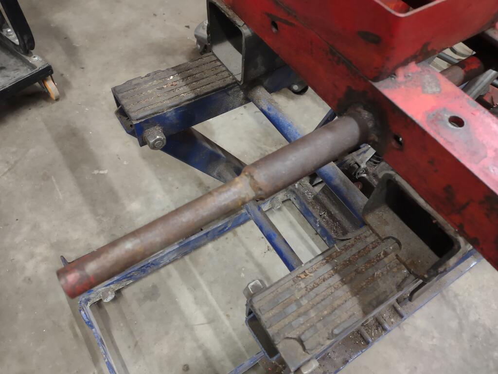

Chrishar 1,026 #37 Posted February 12, 2025 I put the piece of pipe there so it would match the other side I did this to the other wheel horses I think it looks better this way 2 1 Share this post Link to post Share on other sites

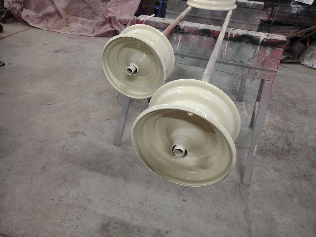

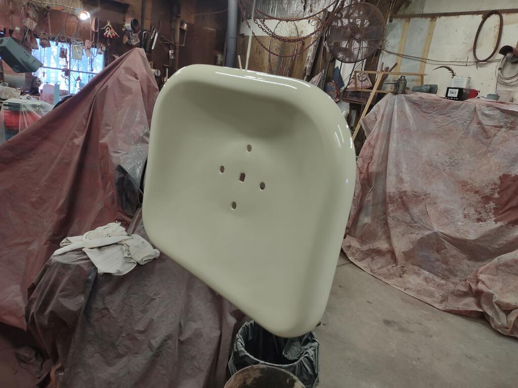

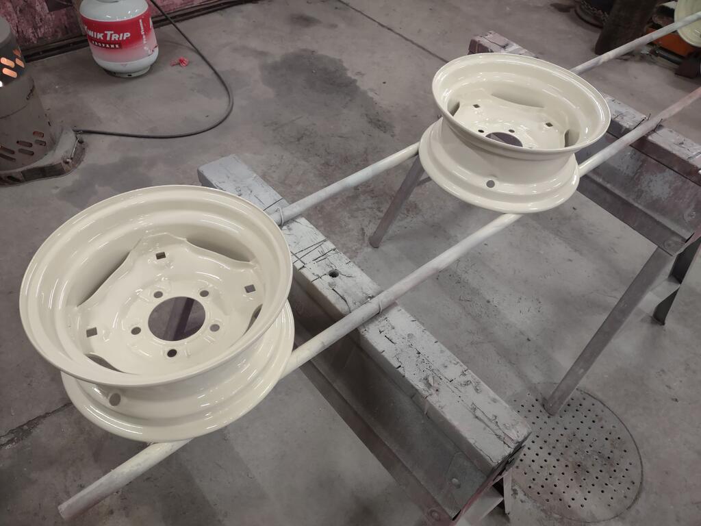

Achto 32,035 #40 Posted February 23, 2025 Woke up, looked at the thermometer, said 15 degrees. Thought "It's a great day to paint !" The seat had a fair amount of pitting so that received the treatment of high build primer last weekend. Today I wet sanded it with 400grit to smooth it out as best as I could. The rims received 1 coat of self etching primer, 2 coats of enamel primer. After that all the pieces were finished with 3 coats of Case IH off white. 4 8 Share this post Link to post Share on other sites

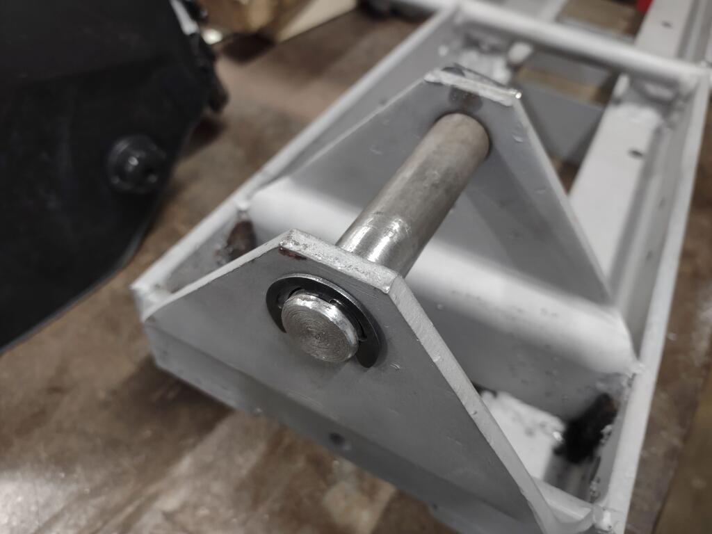

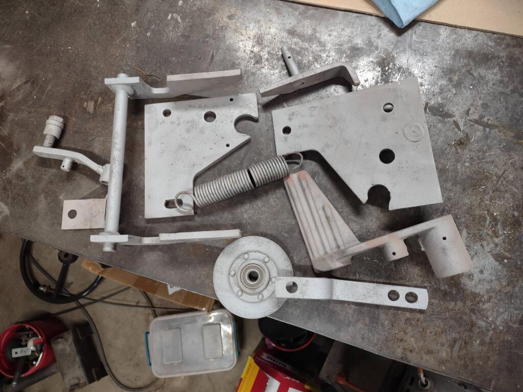

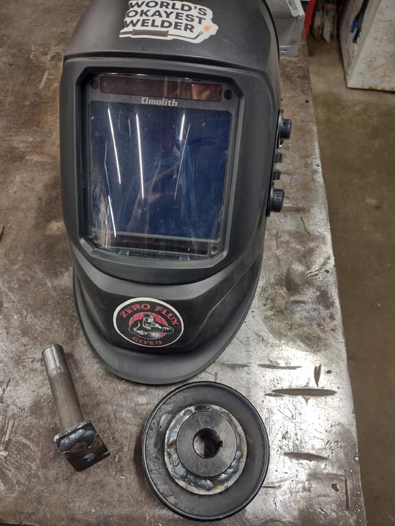

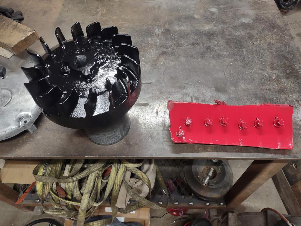

Achto 32,035 #41 Posted February 24, 2025 (edited) Spent some time today helping out friends with their tractors. I did manage to get a couple things done on mine though. First I welded up a new hub & pulley. Also made a new axle pin. The old ( I'm guessing homemade) pin used a cotter key where it extended out of the front. The new one that I made will use an E-clip instead of a cotter key. Did a little diggin' through my secret stash and found all the parts I need to install a mid mount and PTO. Cleaned all these parts up so they can be painted with the rest of the ruff parts. Edited February 24, 2025 by Achto 2 10 Share this post Link to post Share on other sites

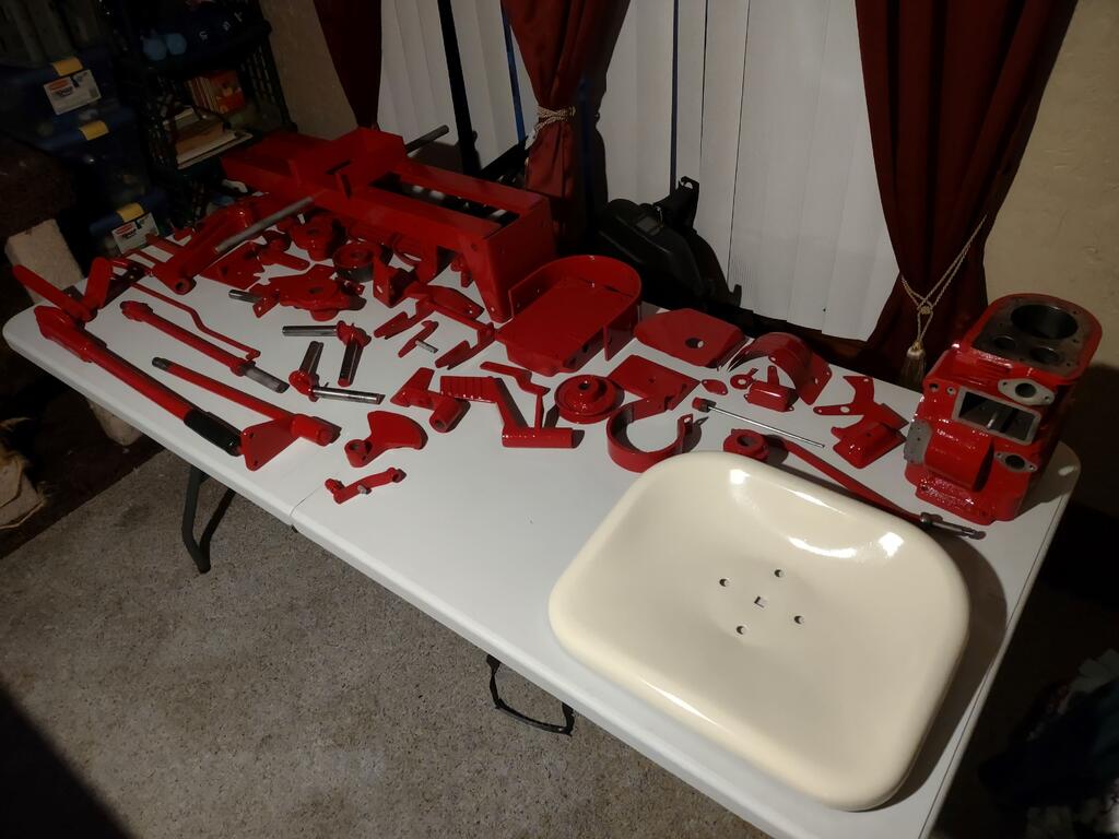

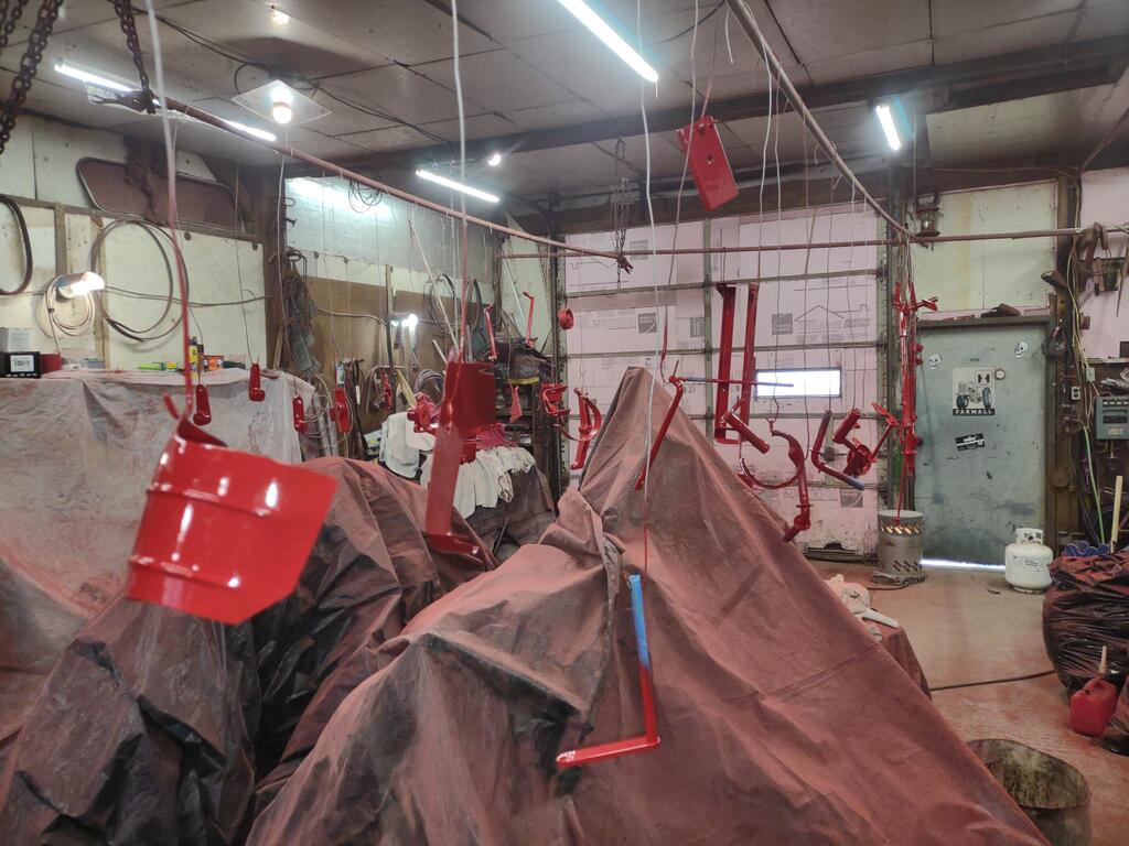

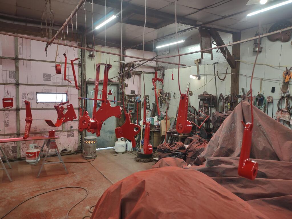

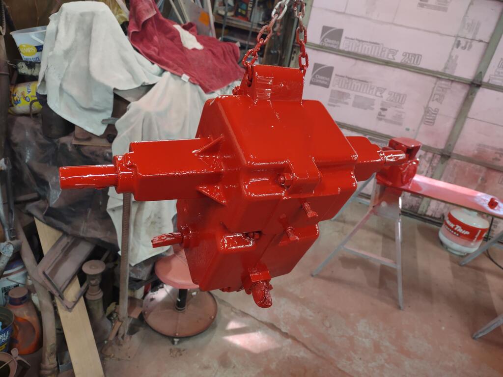

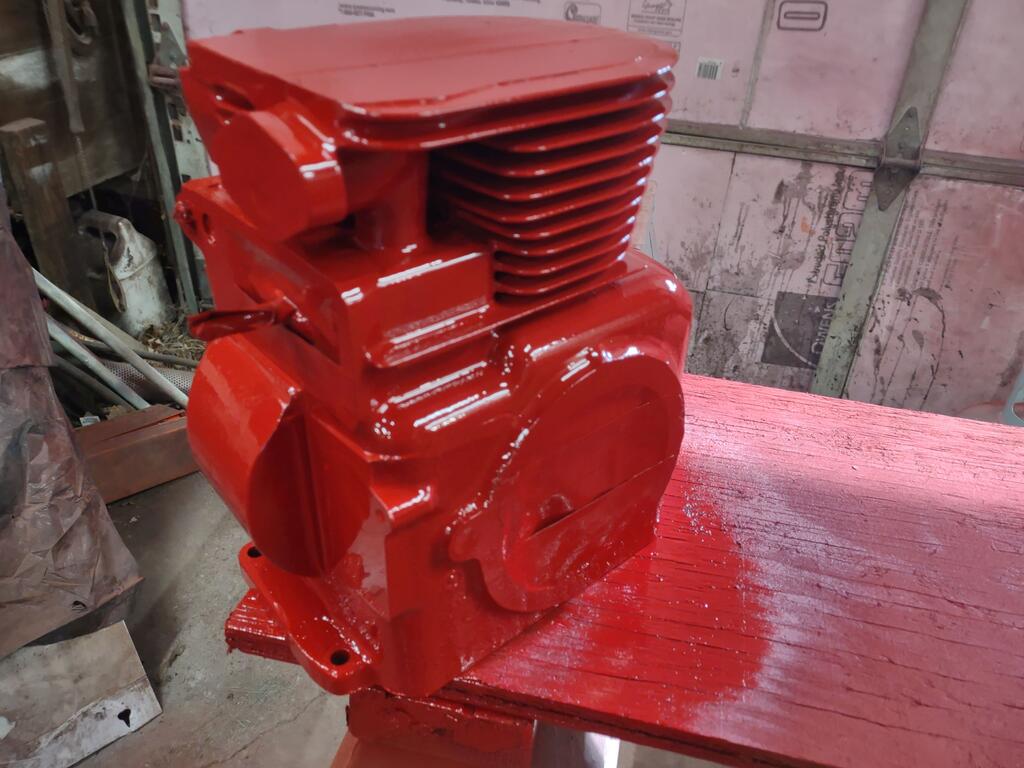

Achto 32,035 #47 Posted March 2, 2025 Well the garage floor was devoid of getting any red paint last year so I made up for it with a fresh coat today. All of the small & ruff parts received a coat of self etching primer, 2 coats of enamel primer and 3 coats of IH red. Next weekend I plan to wet sand and paint the sheet metal parts. Speaking of this, @WHX?? are you up for some wet sanding next Saturday?? 1 10 1 Share this post Link to post Share on other sites

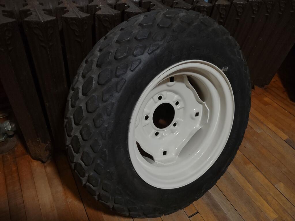

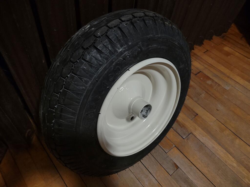

Achto 32,035 #49 Posted March 4, 2025 (edited) No work today so I got a little done on the tractor. Moved all the painted parts out of the cold garage and into a nice warm house for a week of curing. Yes my wife is very understanding. This actually happens every time I restore the tractor. Jim hooked me up with a correct set of front rims which I mounted a brand new set of vintage style Firestone tires on. For the rear I kept the vintage diamond tread BFG's. They have a few weather cracks but are in pretty good shape for 50+ year old tires. Edited March 4, 2025 by Achto 10 2 Share this post Link to post Share on other sites

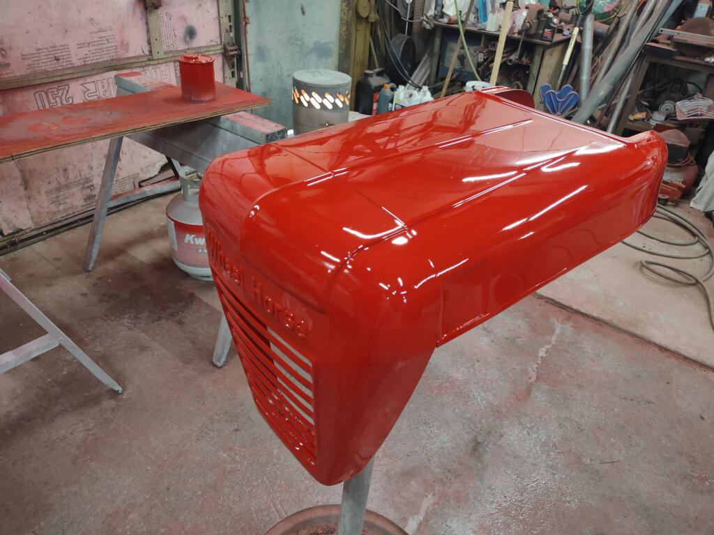

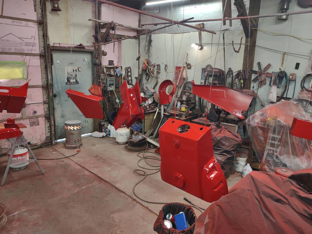

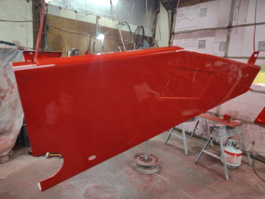

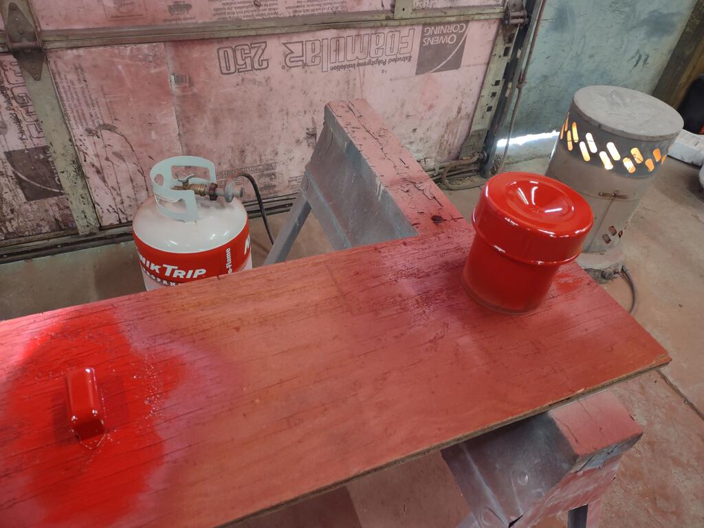

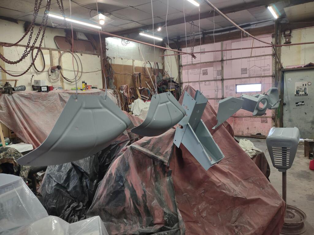

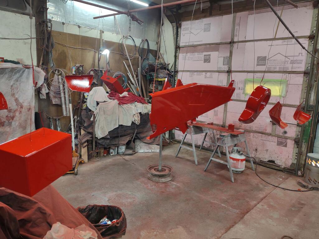

Achto 32,035 #50 Posted March 8, 2025 Was able to spray the sheet metal today. Every thing was wet sanded with 400grit and then receive 3 coats of IH red acrylic enamel. A big THANK YOU to Jim for helping out with the sanding and prep work. With any luck, I should be done using the spray gun on this project. 8 Share this post Link to post Share on other sites
