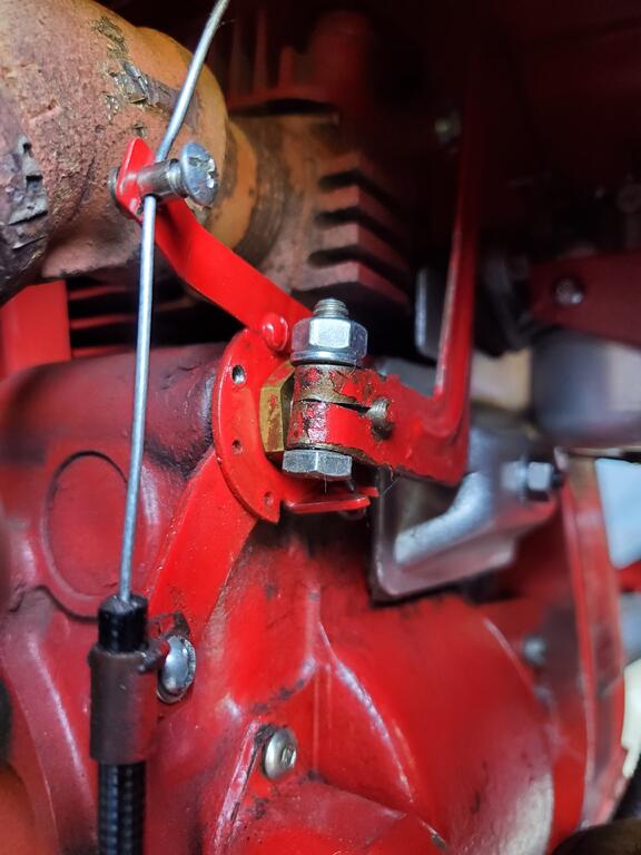

Racinbob 13,290 #28 Posted March 23, 2025 You need to download the Kohler service manual. Search TP-2379 As far as the throttle throw, every small block I've had has been like that. I do this to them and it really helps. Share this post Link to post Share on other sites
njdpo 10 #29 Posted March 23, 2025 (edited) Hi Racinbob. when I was having a closer look, searching for obvious linkage connection errors ... I was specifically looking around at the linkages of the k181... and the m8 ... for some sort of long arm like your picture is showing ... but nothing ... circling back for another inspection - after cleaning up the severe oil and grime accumulations - I am spotting a difference now ... in a position that doesn't look very accessible ... unfortunately I dont have any pics on my phone that shows how that cable was connected on the k181 <sigh> the service manual you mention ( TP-2379 ) on page 6-27 that looks a bit like the pic you have... a bit ... did you modify yours ? Its not exactly clear from the angle of the pic... did you weld / braze it ? or small nuts/bolts ? - dave Edited March 23, 2025 by njdpo Share this post Link to post Share on other sites
Racinbob 13,290 #30 Posted March 23, 2025 2 hours ago, njdpo said: Hi Racinbob. when I was having a closer look, searching for obvious linkage connection errors ... I was specifically looking around at the linkages of the k181... and the m8 ... for some sort of long arm like your picture is showing ... but nothing ... circling back for another inspection - after cleaning up the severe oil and grime accumulations - I am spotting a difference now ... in a position that doesn't look very accessible ... unfortunately I dont have any pics on my phone that shows how that cable was connected on the k181 <sigh> the service manual you mention ( TP-2379 ) on page 6-27 that looks a bit like the pic you have... a bit ... did you modify yours ? Its not exactly clear from the angle of the pic... did you weld / braze it ? or small nuts/bolts ? - dave I added that upper arm. You won't find it in the service manual. I tapped the existing holes and used bolts as well as JB Weld. The back side had to be ground flat so the little round thingy can move. There's also clearance issues with the brass nut. Notice how far the bolt is off center. There's a second bolt that you can't see. I also ground clearance in the arm itself to keep it off the brass nut as it turns. Share this post Link to post Share on other sites
