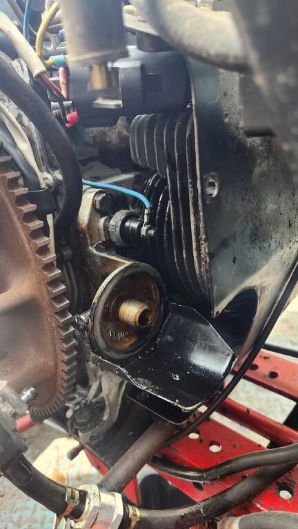

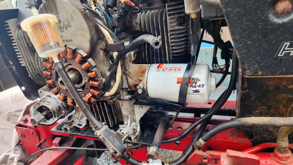

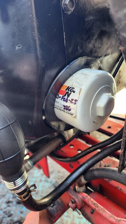

Red Stallion 231 #51 Posted February 23, 2025 After a short hiatus waiting for my over priced gaskets to arrive, I'm back at it. Looking to replace that oil gasket behind the filter mount. Do I have to pull off the flywheel yo access the bottom bolt? Share this post Link to post Share on other sites
Handy Don 17,735 #52 Posted February 23, 2025 27 minutes ago, Red Stallion said: Do I have to pull off the flywheel yo access the bottom bolt? Good question! When I had the P218’s tins off for cleaning I was awful glad there wasn’t any leakage at the joint! Share this post Link to post Share on other sites
Red Stallion 231 #53 Posted February 23, 2025 I think its inevitable that I have to pull the fly wheel... because why design something easy to maintain when instead we can put a bolt behind a thing notorious for seizing onto shafts in nearly every application around the world. Share this post Link to post Share on other sites
Red Stallion 231 #54 Posted February 23, 2025 I just dived in and went for it after a few squirts of penetrant, over cranked the harmonic puiler with a rattle gun, and it popped clean off! Also meant I could give it a good scrub and clean up in behind there, and scrapped out the dust behind the fly wheel. New oil seal, new filter, and now filter grommet! 2 2 Share this post Link to post Share on other sites

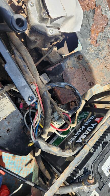

Red Stallion 231 #55 Posted February 24, 2025 Starting the slow process of re-assembly, and regretting not having enough photos of how it all went together before hand. I'll get some photos tomorrow with the shroud back on as it appears to have a massive gap near the oil filter between the two tins Share this post Link to post Share on other sites

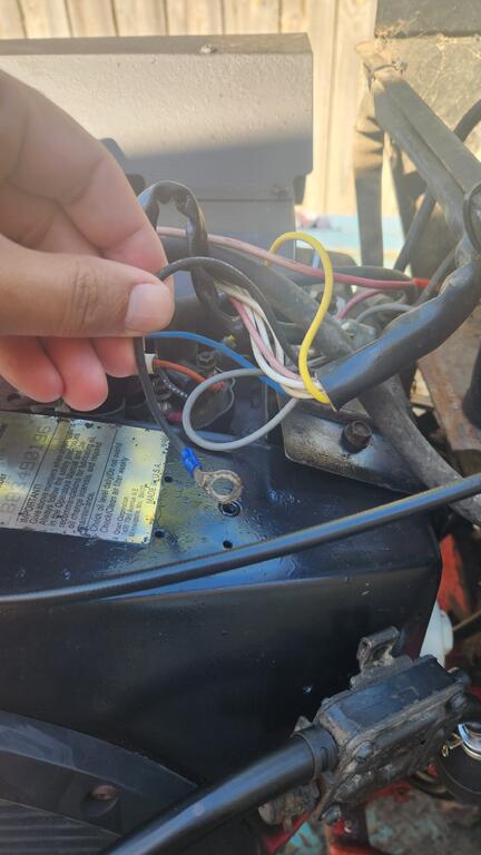

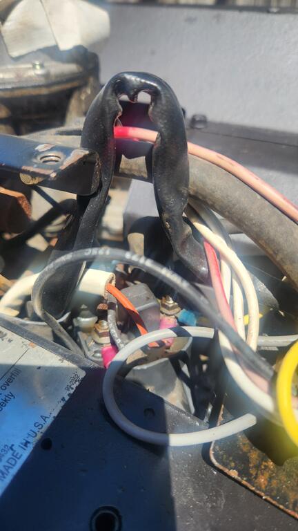

Red Stallion 231 #56 Posted February 25, 2025 Can someone remind me as to where this earth gets attached? Share this post Link to post Share on other sites
Red Stallion 231 #57 Posted February 25, 2025 Oh and the shroud has definitely snugged up tighter now that the screw are in. But there is still a small gap, should I worry about that? Share this post Link to post Share on other sites
lynnmor 9,081 #58 Posted February 25, 2025 There is a notch in the bottom of the rubber to clear the drain tin, do you have that aligned correctly? 1 Share this post Link to post Share on other sites
Red Stallion 231 #59 Posted February 25, 2025 30 minutes ago, lynnmor said: There is a notch in the bottom of the rubber to clear the drain tin, do you have that aligned correctly? YES! I know exactly what you mean, been trying to work out what the orientation is because its obviously supposed to be there. Share this post Link to post Share on other sites

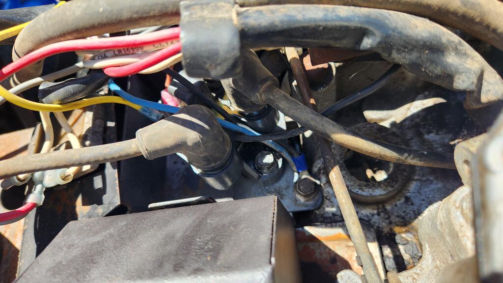

lynnmor 9,081 #60 Posted February 25, 2025 1 hour ago, Red Stallion said: Can someone remind me as to where this earth gets attached? If that was added by a previous owner he may have wanted a better ground for the voltage regulator and that is a good idea. The regulator gets its ground connection with the mounting bolt and yours appears to be mounted wrong. Share this post Link to post Share on other sites

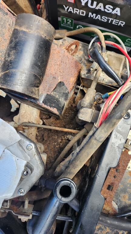

Red Stallion 231 #61 Posted February 25, 2025 Can you elborate on that? This is the picture of how it was mounted before and now. Share this post Link to post Share on other sites

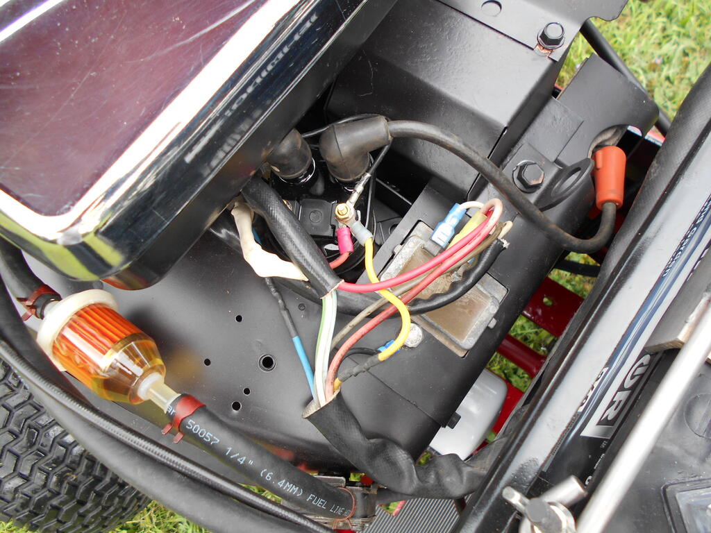

cleat 9,449 #62 Posted February 25, 2025 (edited) This is how I install mine. And you can see the ground wire on the mounting bolt as well. Edited February 25, 2025 by cleat 2 1 Share this post Link to post Share on other sites
Red Stallion 231 #63 Posted February 25, 2025 (edited) Ripper! I can see that is earthed into that bolt holding the square whosit. I ended up earthing it under the bolt that holds the shroud to engine block. That should be strong enough. Edited February 25, 2025 by Red Stallion Share this post Link to post Share on other sites
lynnmor 9,081 #64 Posted February 25, 2025 The heavy battery cable grounds the engine just fine. The wire to the voltage regulator mounting bolt assures that rust, paint and dirt are bypassed and you have a good solid ground. Yes, the voltage regulator case is part of the circuit. The photo posted by Cleat shows the proper installation. 1 Share this post Link to post Share on other sites
Handy Don 17,735 #65 Posted February 25, 2025 3 hours ago, lynnmor said: The heavy battery cable grounds the engine just fine. The wire to the voltage regulator mounting bolt assures that rust, paint and dirt are bypassed and you have a good solid ground. Yes, the voltage regulator case is part of the circuit. The photo posted by Cleat shows the proper installation. 12v is not enough to overcome poor connections anywhere in a complete circuit. That includes grounds! Share this post Link to post Share on other sites
Red Stallion 231 #66 Posted February 25, 2025 (edited) 8 hours ago, lynnmor said: The heavy battery cable grounds the engine just fine. The wire to the voltage regulator mounting bolt assures that rust, paint and dirt are bypassed and you have a good solid ground. Yes, the voltage regulator case is part of the circuit. The photo posted by Cleat shows the proper installation. Roger that... I thought you meant my actual regulator was installed incorrectly (and I was confusing the regulator with the distributor), which didn't make a lot of sense because I haven't taken it out. After seeing Cleat's photos, I checked my photos again, and I've taken that screw out at some point, which suggests that I did indeed have it wired correctly before dismantling it all. Edited February 25, 2025 by Red Stallion Share this post Link to post Share on other sites
lynnmor 9,081 #67 Posted February 26, 2025 7 hours ago, Red Stallion said: Roger that... I thought you meant my actual regulator was installed incorrectly (and I was confusing the regulator with the distributor), which didn't make a lot of sense because I haven't taken it out. After seeing Cleat's photos, I checked my photos again, and I've taken that screw out at some point, which suggests that I did indeed have it wired correctly before dismantling it all. You have an ignition coil with two outputs, it is not a distributor. My question is ; how did you remove the tins without removing the ignition coil? No wonder you are having problems getting the tins aligned. Share this post Link to post Share on other sites
Red Stallion 231 #68 Posted February 26, 2025 (edited) Engineering magic! I didnt take off the end tins, only the main shroud, and the red sides. The coil I unbolted from the shroud and left it hanging. Once I spun the grommet around, and put the screws in, the tins are aligned again. Edited February 26, 2025 by Red Stallion 1 Share this post Link to post Share on other sites

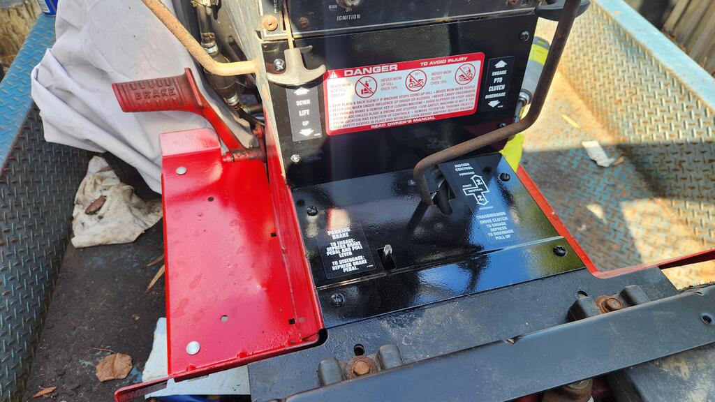

Red Stallion 231 #73 Posted March 26, 2025 Slowly getting the painted panels back on, and the new decals. Super happy with the quality of the decals from the decal guy. Seat assembly is nearly all repainted, just a couple of brackets left. And then I have to strip amd paint the seat pan. Feels good to see a finish line in sight! 2 3 Share this post Link to post Share on other sites

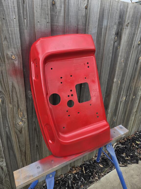

Red Stallion 231 #75 Posted September 13, 2025 After a very long break, I'm back at it! First I ran out of work, which meant I ran out of money, and food took priority over paint. And then I had work, but it was interstate so I haven't been home much. Plus winter here is too cold for painting. Finally get around to getting the seat pan and bonnet sand blaster two weeks ago. A few coats of primer this morning, and the first colour coat is down kn the seat pan! Now hopefully I can remember how it all goes back together! 4 Share this post Link to post Share on other sites
