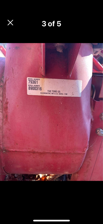

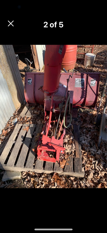

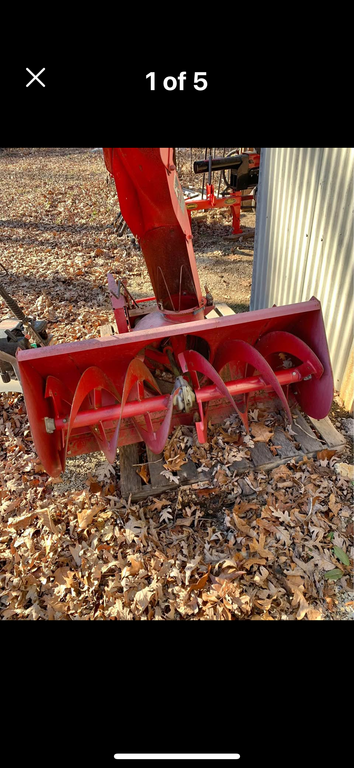

Diesel Actual 4 #1 Posted January 13, 2025 I have an 856. I would like to put a snowblower on it.ST-326 which was later replaced by model number 6-2211 is what is supposed to be on it. I have someone selling a two stage snowblower my question is: will it fit ? How different are the snowblowers from unit to unit? Is it easy to modify them to hook up to my 856? 79361 is the model of the snowblower. Share this post Link to post Share on other sites
pfrederi 19,727 #2 Posted January 13, 2025 (edited) I think a 2 stage is way to much blower for an 856. Very heavy to lift manually and not enough horse power to blow effectively Edited January 13, 2025 by pfrederi 6 3 Share this post Link to post Share on other sites
Diesel Actual 4 #3 Posted January 13, 2025 Thank you. I guess that’s why it’s only on newer models. I guess I’ll keep searching for a blow for mine. Share this post Link to post Share on other sites
