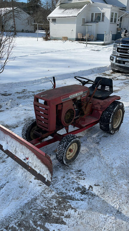

Achto 30,782 #5 Posted January 12, 2025 I have a '68 raider 12, my go to plow mule. Here is al link for the manuals and attachment pdf's 2 2 1 Share this post Link to post Share on other sites

Epayne85 18 #7 Posted January 13, 2025 1 hour ago, Achto said: I have a '68 raider 12, my go to plow mule. Here is al link for the manuals and attachment pdf's Love the plow setup I definitely want one for my tractor! 2 Share this post Link to post Share on other sites

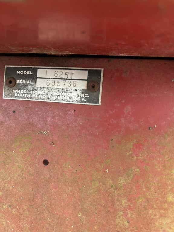

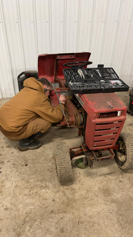

Epayne85 18 #8 Posted January 13, 2025 This is the front of my raider 1 5 Share this post Link to post Share on other sites
ebinmaine 77,048 #9 Posted January 13, 2025 10 hours ago, Epayne85 said: This is the front of my raider 11 hours ago, 953 nut said: add a mule drive This is why I wanted a picture. I agree. Add a later type mule and you'll really open up the possibilities. 1 1 Share this post Link to post Share on other sites

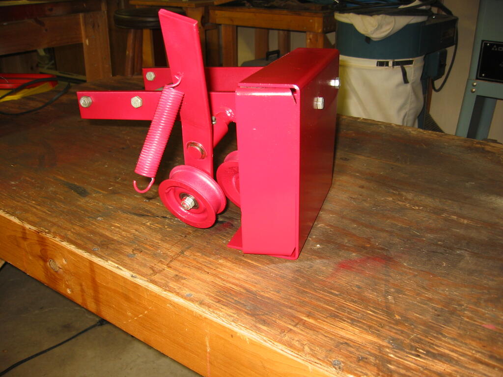

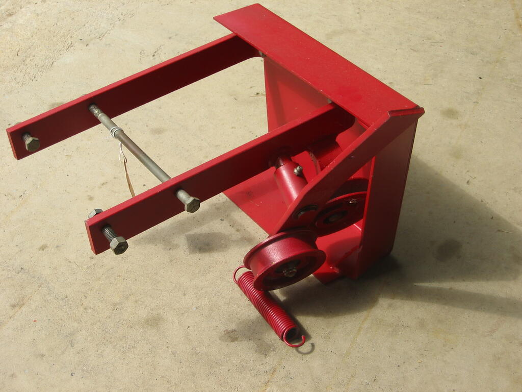

pfrederi 19,765 #10 Posted January 13, 2025 Actually he has a front mule drive. The very first mule drive was a short lived item. It had a big steel plate on the front which has been removed from his. Do not believe the lack of a plate changes the functionality. Look at these pics an envision the big plate removed. 2 4 Share this post Link to post Share on other sites
Epayne85 18 #11 Posted January 13, 2025 8 hours ago, pfrederi said: Actually he has a front mule drive. The very first mule drive was a short lived item. It had a big steel plate on the front which has been removed from his. Do not believe the lack of a plate changes the functionality. Look at these pics an envision the big plate removed. I have the plate for the front, one bolt was loose and the other was missing just took it off for the time being Share this post Link to post Share on other sites

ebinmaine 77,048 #13 Posted January 13, 2025 12 minutes ago, Epayne85 said: I was hoping to find the vin plate on mower deck, or find a newer one that would be even better lol With that newer mule drive you can use a bunch of different decks over a broad year range. 1 Share this post Link to post Share on other sites
kpinnc 16,990 #14 Posted January 13, 2025 45 minutes ago, ebinmaine said: With that newer mule drive you can use a bunch of different decks over a broad year range. Hard to verify from the pic, but I think he'll need to get a belly hitch to use Tach-a-matic decks. Share this post Link to post Share on other sites
Epayne85 18 #15 Posted January 13, 2025 14 minutes ago, kpinnc said: Hard to verify from the pic, but I think he'll need to get a belly hitch to use Tach-a-matic decks. It has the belly hitch 1 Share this post Link to post Share on other sites

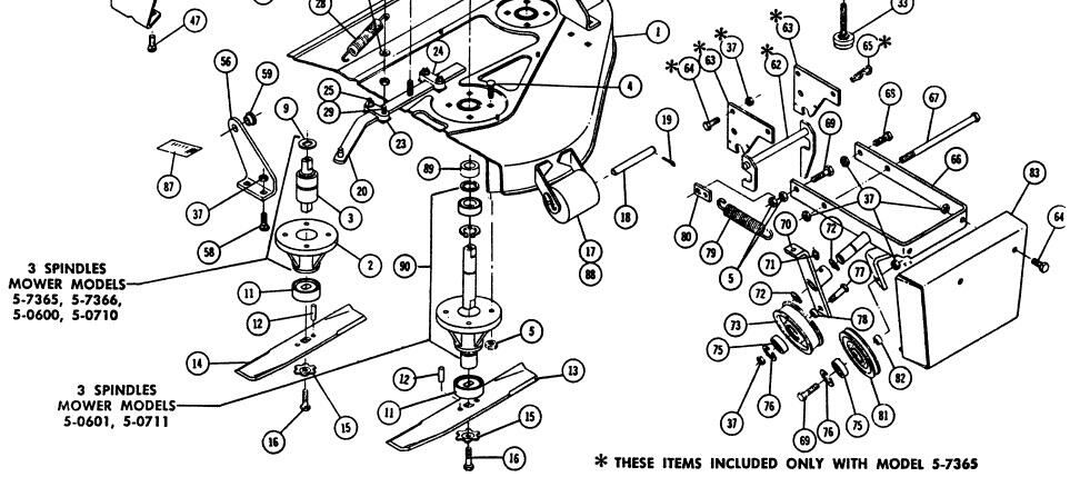

gwest_ca-(File Mod) 11,974 #16 Posted January 14, 2025 Is your deck a 36" width of cut? Found some of the applications for this idler assembly. Models 5-7365, 5-7366, 5-0600 and 5-0601 are 36" rear discharge decks. Models 5-0710 and 5-0711 are 36" side discharge decks. If a replacement deck can be found one using blades with a 3/4" center hole would be a bonus. The 5/8" x 3/4" double-D hole blades may not be available. 1 Share this post Link to post Share on other sites
Epayne85 18 #17 Posted January 14, 2025 1 hour ago, gwest_ca said: Is your deck a 36" width of cut? Found some of the applications for this idler assembly. Models 5-7365, 5-7366, 5-0600 and 5-0601 are 36" rear discharge decks. Models 5-0710 and 5-0711 are 36" side discharge decks. If a replacement deck can be found one using blades with a 3/4" center hole would be a bonus. The 5/8" x 3/4" double-D hole blades may not be available. It’s a side discharge, I’m almost certain it’s a 36” being it has 3 blades Share this post Link to post Share on other sites
gwest_ca-(File Mod) 11,974 #18 Posted January 14, 2025 Mower Rotary 1971 36in SD model 5-0710 Mower DNA 1971 model 5-0710 replaced by 1971 model 5-0711 1972 model 5-0720 1973-1974 model 5-0721 1975 model 5-0722 1976 model 65-36MS01 1977 model 75-36MS01 1977 model 75-36MS02 1978 model 85-36MS01 1979 model 95-36MS00 - These decks use blades with 5/8" x 3/4" center hole unless the spindle has been upgraded ----------------------------------------------------------------------------------------------------------------------------------------------------------- 1979 model 95-36MS01 replaced by 1980-1982 model 05-36MS01 - Last year for bearings with 3/4" ID 1983-1984 model 05-36MS02 - First year for bearings with 17mm ID unless older spindles were updated. These decks use blades with a 3/4" center hole Note - 17mm is .669" 1 Share this post Link to post Share on other sites
