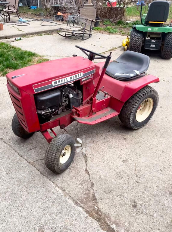

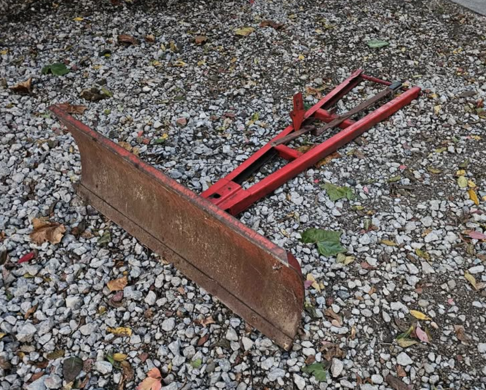

tstab 2 #1 Posted January 8, 2025 Hey everyone... I know I'm fresh to the forum.... I've been lurkkkkkking for a while. I've been trying to figure out a solve for a Charger 8 plow. That said I have a Charger 8 (diff motor) I got for free and I want to mount up a plow to it and was going to buy the aftermarket axle bracket. I picked this plow/dozer blade up thinking it would work for it. I know there is a specific model of dozer blade for the Commando 8 and I have the part number somewhere but I'm hoping with the bracket from Wheel Horse Parts.... I can make this work. Before I invest another bit of money into the bracket.. I wanted to see if that would work. I know I'll have to figure out the lift mechanism probably too but more interested in getting this thing generally mounted if possible. Thanks! Tyler Share this post Link to post Share on other sites

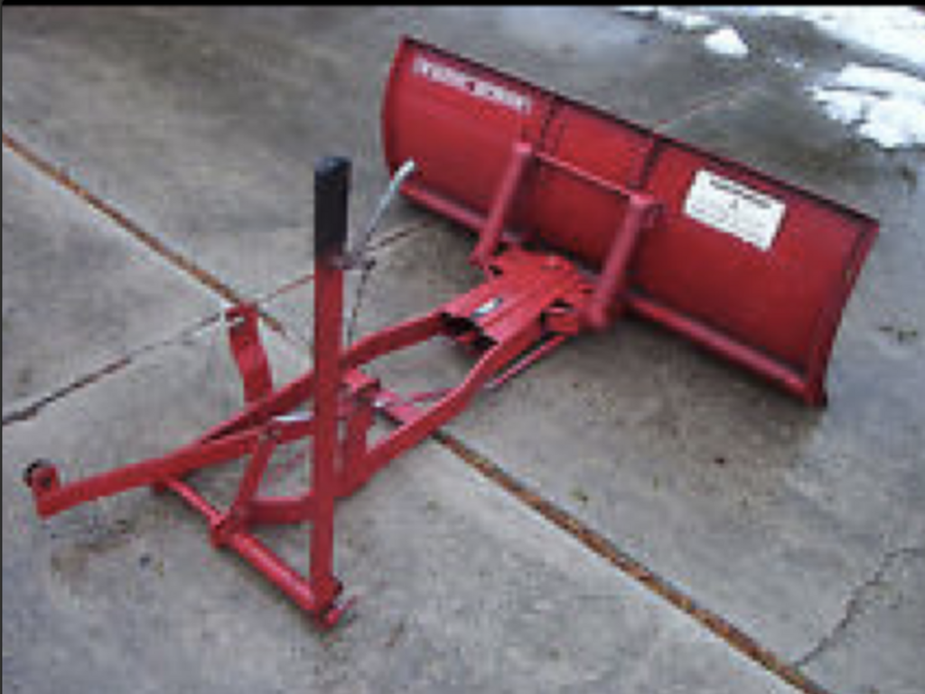

Ed Kennell 45,054 #2 Posted January 8, 2025 to the Tyler. That is a plow frame for a short frame tractor. I am not positive, but I believe the charger is a long frame tractor. You can still install it, but the blade may hit the tires if you angle the plow.. 1 Share this post Link to post Share on other sites

oliver2-44 11,272 #4 Posted January 8, 2025 The long plow frame is essentially a short frame with straight sides added behind the angle section. It might be easier to extend the sides on your frame than to make a custom bracket. Later today I can get a dimension of how long it needs to be. 1 1 Share this post Link to post Share on other sites
Ed Kennell 45,054 #5 Posted January 8, 2025 9 minutes ago, tstab said: fabing up a custom axle bracket Very easy to do if you can cut and drill steel. I have made several custom axle brackets for tractors and 4 wheelers using 3"x3" angle iron. I just drill a 3/4" hole and use 2 3/4" bolts and double buts to attach the plow. No need to make notches and locking levers. Place the plow under your tractor with the blade angled. set it for a couple inches clearance with the tire. Then you can see what you would need to attach to the rear axle. 1 Share this post Link to post Share on other sites

Ed Kennell 45,054 #10 Posted January 8, 2025 The custom made angle pieces can be mounted horizontally under the axle to move the frame forward. Using a 3/4" drilled hole, the locking levers and the bar connecting the two brackets is not necessary. Here is a pic of the short and long plow frames. 1 Share this post Link to post Share on other sites
Handy Don 16,024 #11 Posted January 8, 2025 (edited) Isn’t the Charger 8 a vertical shaft engine tractor? If so, the transaxle is very different and I’m not at all sure it’s intended to support a plow bracket. The brackets/frames for the horizontal shaft tractors won’t be compatible. I’m fairly sure the dozer blade for the verticals attaches only to the frame at the front and mid-hitch. Edited January 8, 2025 by Handy Don 3 1 Share this post Link to post Share on other sites

tstab 2 #13 Posted January 8, 2025 9 minutes ago, Handy Don said: Isn’t the Charger 8 a vertical shaft engine tractor? If so, the transaxle is very different and I’m not at all sure it’s intended to support a plow bracket. The brackets/frames for the horizontal shaft tractors are not at all compatible. I’m fairly sure the dozer blade for the verticals attaches only to the frame at the front and mid-hitch. That's what I noticed on the suggested blade. Made this purchase as it was what was available and I assumed (incorrectly) that one of the Wheel Horse Parts brackets would work. Def adds to the convo here though. I'm just going to have to go custom with it Share this post Link to post Share on other sites
