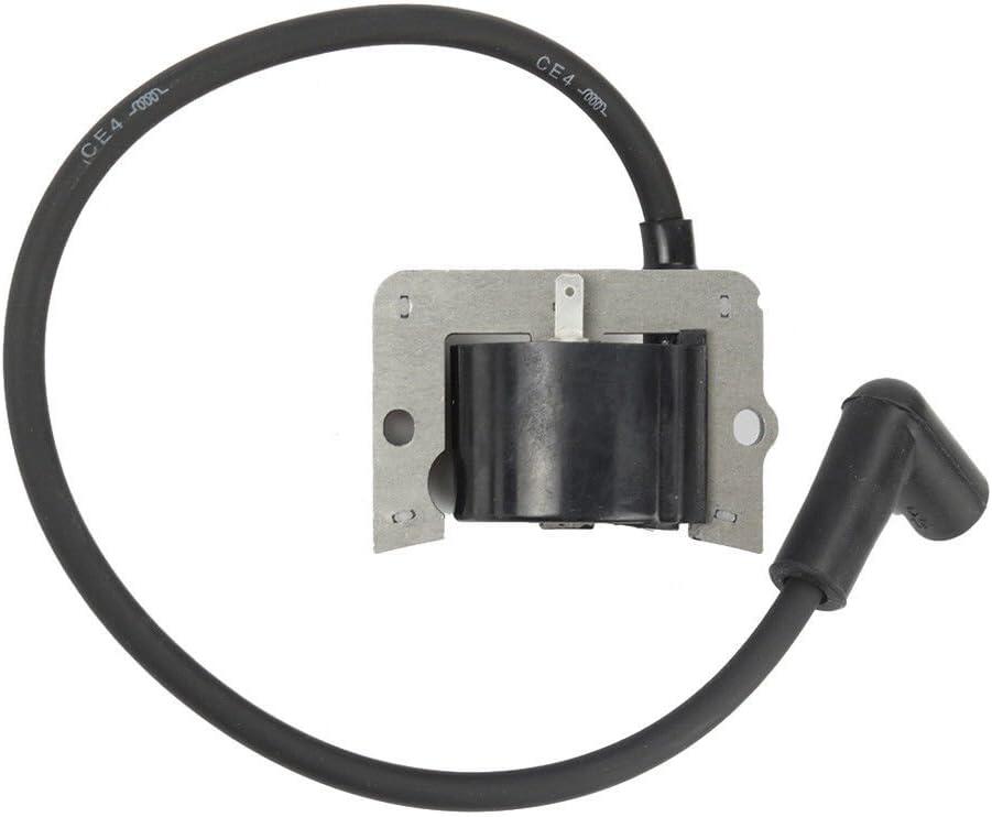

Achto 32,250 #3 Posted January 8, 2025 (edited) 14 hours ago, waffle said: All wiring appears fine....... So i actually ran a wire from the battery straight to the ignition module to make sure it was definitely grounded and with key switch off which should kill the engine but still won't shut off. I'm baffled that grounding the module won't kill the engine. Your ignition coil should look like this. The kill wire from your switch should be connected to the terminal at the top center of the coil. Ground this terminal out to kill the engine. I would remove the fan shroud and check to make sure that the kill wire is for sure connecting to this term. Edited January 8, 2025 by Achto 1 Share this post Link to post Share on other sites

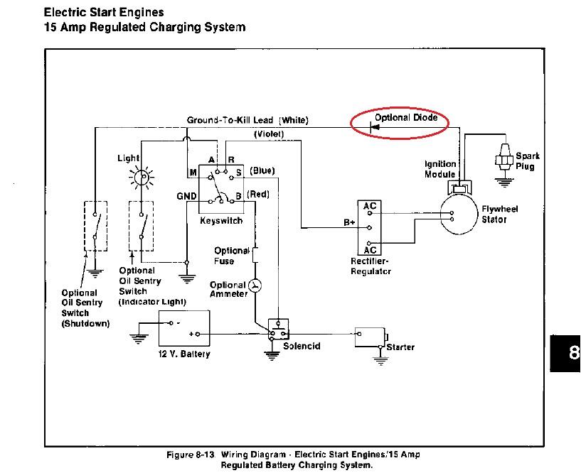

gwest_ca-(File Mod) 12,416 #5 Posted January 8, 2025 Some engines have an optional diode in the ignition wire. I can only guess it is on the engine side of the engine/tractor connector. Will feel like a small lump under some electrical tape. Some models also have a diode in the other wire to rectify the charging current so don't get them mixed up. If the diode has failed in an open state grounding the ignition wire after the diode will not kill the ignition. 1 1 1 Share this post Link to post Share on other sites
WHX?? 57,641 #6 Posted January 8, 2025 Kill wire open in the shroud or at the mag. But it sounds like you covered that. 1 hour ago, gwest_ca said: an optional diode in the ignition wire. I can only guess it is on the engine side Wonder what the purpose of the diode is? Share this post Link to post Share on other sites
gwest_ca-(File Mod) 12,416 #7 Posted January 8, 2025 The diode blocks any stray voltage from getting to the module. Since it is part of the Kohler wiring harness it only shows up in the Kohler wiring diagrams. 2 1 1 Share this post Link to post Share on other sites
