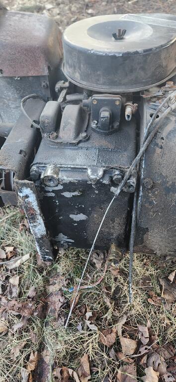

siebenaler 114 #1 Posted January 4, 2025 I recently acquired a k241as 10 hp That was removed from a jd 210 It has a very shallow oil pan maybe one inch deep. My question is with this oil pan would it ever work in a wheelhorse tractor? Or do I need to find a deeper oil pan. Share this post Link to post Share on other sites

ebinmaine 77,338 #5 Posted January 5, 2025 4 hours ago, Mark siebenaler said: k241as Got any pics? Share this post Link to post Share on other sites

ebinmaine 77,338 #11 Posted January 5, 2025 I believe you have 2 options. 1. Use that just as it is by adapting the existing bolt holes to the Wheelhorse frame with a plate and set the correct height. 2. Get a setup from a Wheelhorse of the 1978 ish to 1982 ish period and use that lower frame adapter with solid mounts. Personally I'd try the first. If you do decide to swap that oil pan I'd be interested in buying the one you have now. 1 Share this post Link to post Share on other sites
